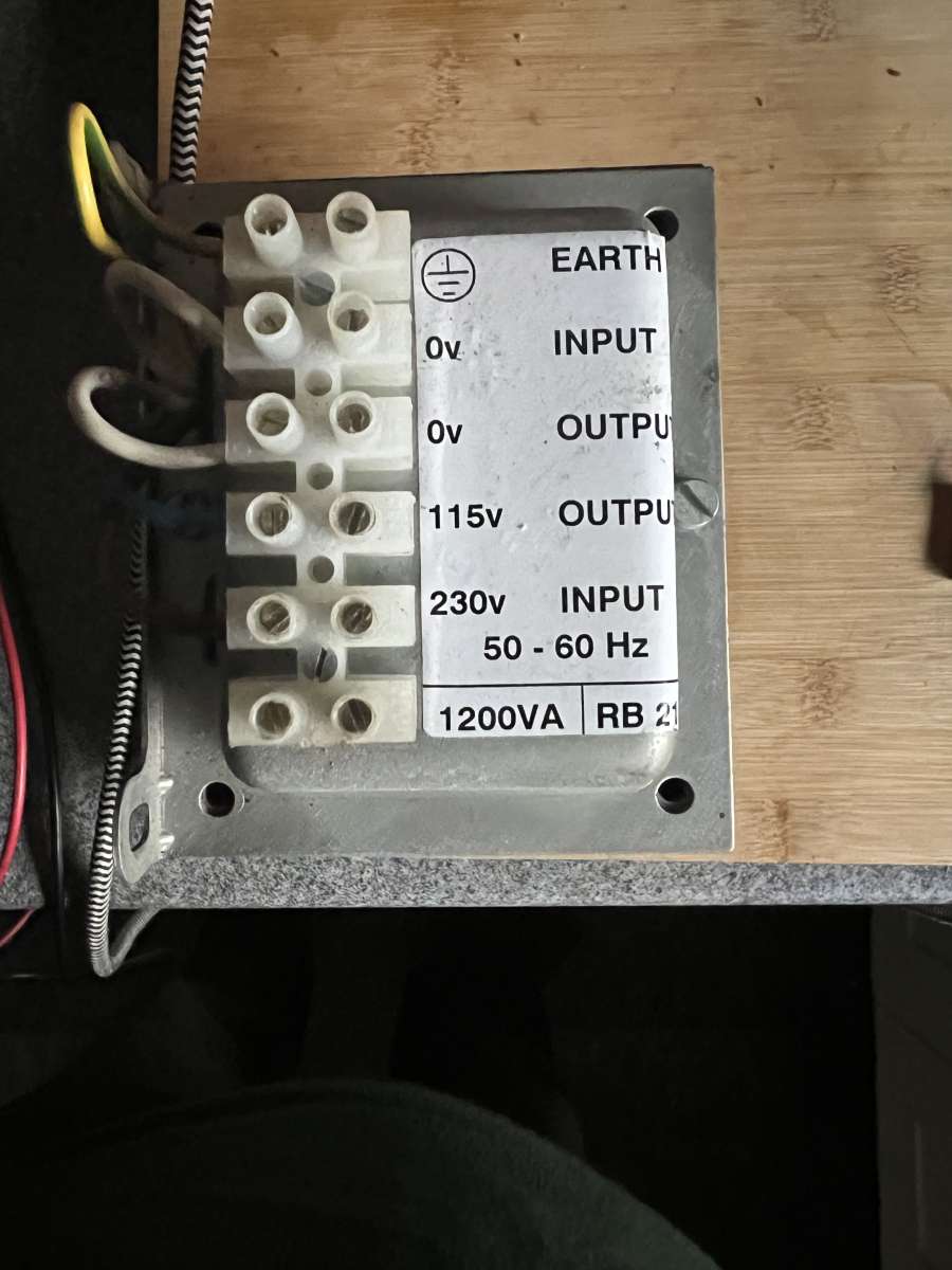

      I have the job for a friend to install a secondhand Wolf (us) cooker hood a great big thing 48 inches wide and 60 kg..almost all stainless it has 3 white lights tungsten and 2 heat lights and a big fan motor..
      theres a transformer in the hood a auto transformer
      the person who uninstalled the hood has cut wires and also disconnected the wires from the transformer to its terminal block ( unnesassarily)
      How do i determine which wires are which?
      I assume the earth wire is correct?
      the white wire that i have connected to 0v (input) and the brown wire that i have put into 240v (input) has continuity
      the white wire that i connected to 0v (output) and the blue wire that i put into 115 (output) has continuity
      no continuity between any other wires
      if i connect 240v to the input it blows the fuse
      how should i connect this?

      #712752
        It should be easy, Ian
        [ but as I know all-too-well that is rarely true ]
        A classic Auto-Transformer has one winding, which is tapped … giving it the same geometry as a potentiometer.
        I would therefore expect the two 0v connections to be common.

        #712753
        noel shelley
          @noelshelley55608
          Should be easy !First 0v to neutral, 230v to live, obviously earth.  wire your load to second 0V and 115v. AH I SEE /UNDERSTAND ! YES ! Right, try blue to first 0v brown to 230v, Load between the 2 white wires at 115v. To test, see if you have a smallish resistance between blue and brown then the 2 white wires ! connect blue 0v and brown 230v. Fuse holds ? if yes then test for 115v between the 2 white if yes the connect the load. Bear in mind that you are working with lethal voltages so be very carful. Or try contacting the makers . If it is an auto trans former then both 0V will be common and you will have increasing resistance between 0v, 115v, and 230v.  Noel.

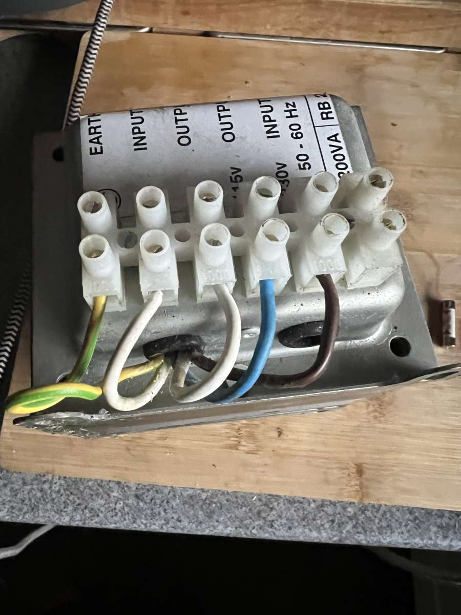

              Ian Parkin
                @ianparkin39383
                Right connected 240v on the blue and brown
                and theres 240v on the 2 whites with no load
                but no resistance between the blue and brown and the pair of whites
                do i need to load the output?

                      Dave Halford
                        @davehalford22513
                        As said above an autotransformer only has one winding with several taps off it. the input goes across the full winding, the output goes between the neutral (0v) and one of the taps suppling the required voltage.
                        If the sticker is correct the colours going to the transformer do not reflect the mains cable colour code.
                        Therefore avoiding confusing colours – mains neutral to 0V input mains live to 230V input and a light bulb load across the output should give 115V

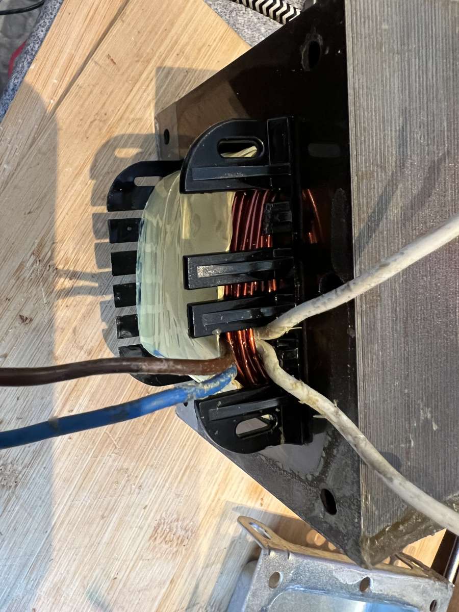

                          Took the end covers off
                          is this any help blue and brown on the outside of the windings whites on the inside
                          IMG_5218

                          Robert Atkinson 2
                            @robertatkinson2
                            mains neutral to input white
                            Mains live to input brown
                            Hood neutral (should be white) to output white
                            Hood live (black) to output blue.
                            Earth to earth
                            Bigger issue: fan wil be rated for 60Hz so may overheat on UK 50Hz supply.
                            Robert.

                                          Ian Parkin
                                            @ianparkin39383
                                            Michael
                                            i think i now have connected it in every combination of supply and out puts
                                            theres 4 wires 2 whites and one blue and one brown..
                                            one white has continuity with brown
                                            the other has continuity with blue
                                            the brown and blue don’t have continuity with each other
                                            the whites don’t have continuity with each other
                                            continuity is 1 ohm or so..
                                            i thought i knew what a auto transformer was
                                            i have a few and a variac and can see how you apply 240 across the whole winding and then tap off from the 0v to the wiper..
                                            surely this auto should be the same..
                                            All the windings look good inside.
                                            I’ve rung the manufacturer but no one there at the moment to help me

                                                Frances IoM
                                                  @francesiom58905
                                                  it is a 115v 1:1 transformer that can be wired as a auto transformer (just get the phasing of the windings correct!) – Robert Atkinson has given the connections – suspect someone has rewired the terminals

                                                  Nicholas Farr
                                                    @nicholasfarr14254
                                                    Hi Ian, it is possible that there is a thermal fuse buried inside the windings that joint the two 0-V’s together, and if the transformer has been subject to an overload due to a fault in the hood, then the fuse would probably blown. If it has had a thermal fuse that’s blown, it probably won’t be replaceable.
                                                    You could try connecting a fuse between the two 0-V output terminals, in a suitable insulated housing, and then connect a 230 V light bulb between the 0-V input and the 0-V output, with the mains on 0-V & 230 V inputs, which should then light up the bulb at about half its normal brightness if an internal fuse has blown.

                                                    #712828
                                                    Simon Williams 3
                                                      @simonwilliams3
                                                      I fear the suggestions on how this should be resolved have not taken enough notice  of the OP’s comment that we don’t know the four wires coming from the transformer innards are connected to the correct labels.  We should ignore the text of the label and start from first principles.
                                                      Ignore the green and yellow wires for the time being.  All four conductors – two whites, a brown and a blue – should have DC conductivity between them.  If not the unit is either faulty or it isn’t an auto transformer.
                                                      One would expect the blue and the brown wires will have the greatest DC resistance between them.  If so these are the tappings for 0 volts and 230 volts respectively, though this is an assumption.  Go with it for the time being.
                                                      If this is correct one of the white wires is the output 0 volts, and thus is directly connected to the blue neutral.  Check the DC resistances and see if one of the white wires has a resistance to the blue wire of as close to zero ohms as the OP can measure.  If so we’re talking auto transformer, if not we’re in a different world entirely.
                                                      By a process of elimination the remaining white wire is the nominally centre tap of the auto-transformer winding, and should measure approx equal resistance between it and the blue neutral and between it and the brown live input.
                                                      Now confirm there is a low resistance connection (<1 ohm) between the green/yellow wires and the frame of the transformer, also there is a high resistance (Megohms) between any of the power conductors and the frame.
                                                      If all this works out, now shuffle the wires to their respectively labelled connector blocks.
