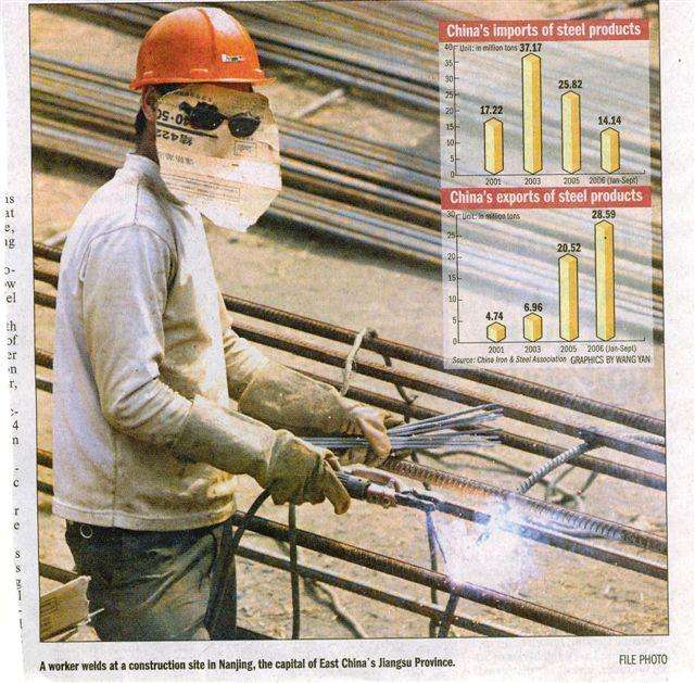

                                                      Meanwhile, in China…
                                                      WELDING
                                                      I’ve seen much the same, and worse, in Thailand, Laos and Vietnam. No glasses at all and squinting is not uncommon.
                                                      welding in indo
