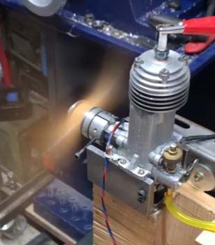

      Hi everyone,
      After initially resisting all attempts to make it start, my recently completed Atom Minor Mk III finally burst into life; most satisfying! This is my first ic engine. I think the main issue was (and still partially is) the fuel feed which works on a simple suction principle – I have the initial level of the fuel at the same height as the jet in the carb. Anyone know if there is a better way?
      The ignition timing could probably be optimised, I am using a Hall sensor and CDi module.
      Also, can anyone advise on the best mixture of fuel to oil for this two stroke? I am currently using Aspen two stroke which has a 50:1 ratio; Westbury recommended a ratio with a lot more oil in it – but I guess that was in the days before synthetic oils.
      Regards,
      Clive
      #31208
      Clive B
        @cliveb55652
        #339794
        Old School
          @oldschool
          Clive, It certainly needs more oil than you are using I would follow whst E Westbury suggests. Castor oil is a good lubricant and is still the required lubricant along with methanol for some model classes where speed is the goal.

                              Thank you Fred and Richard for your kind comments. The castings were from Woking Precision just before they were taken over by Hemingway. These castings were fine, although I made the cylinder head from round bar stock and didn’t use the casting for the contact breaker assembly. I believe that there was an article in ME on the design of a higher compression head for this engine so that it could run on glow fuel (methanol), might give this a try! There seem to be pros and cons for castor oil, perhaps a mix of synthetic/castor would be pragmatic if not after the highest levels of performance? Oh, and I’ll try to avoid standing in front of the exhaust! Clive

                                I would not bother with mixing synthetic and castor oil for such an old design of engine. Just use castor and methanol and don't worry about compression ratios as methanol fuel will run at very low CR without any trouble.
                                Modern ABC and AAC engines are said to run best on synthetic oil and I don't argue with that. If being used for RC, the engine can always be shut down if it goes lean. I still fly control line and you don't have the luxury of shutting down if this happens. So I always add 5% castor to the fuel just in case!

                                    Thanks Andrew and Jeff. Please forgive me a dumb question (I am new to building ic engines), but can I run the methanol mix using the existing spark ignition or will it be better off with a glowplug? Clive

                                              Initially I noticed a slight leakage in the crankcase – some sealant cured that (I used hylomar blue – perhaps someone could suggest a better sealant?)
                                              Fuel supply – as stated on my first post, the fuel feed needed some fettling to avoid flooding (thanks for comments Trevor).
                                              Other than that, very patient adjustment of the carb needle and air shutter to find the "working envelope". I did make a small mod to the carb re the position of the needle seating in the venturi; not sure if this really helped but this mod will be specific to this design of carb. If you're interested I can send you a sketch. Incidently the needle in the original drawing is not tapered enough.
                                              I tried Easy Start but this didn't make any difference.
                                              I tried measuring the compression with a car type gauge but I think that the volume of air inside the gauge itself led to misleadingly low readings for an engine of this small size (6cc).
                                              A cold garage probably didn't help matters.
                                              The cylinder and piston are both cast iron.
                                              Best of luck!
                                              Clive

                                                Using 4:1 methanol might be a bit difficult with a 1/4" spark plug as I think it would tend to foul up constantly, so I would stay with a glow plug.
                                                If you modify the fuel mix of 4:1 (stay with the same oil content) and make you methanol content, 90% methanol and 10% nitromethane, it will assist in starting a lower compression engine.
                                                It also has the effect of making the needle adjustment much less sensitive.

                                                    Jorgo, Thanks for your suggestion, what type of glowplug could you recommend?

                                                      Hi Clive,
                                                      Being a 2 stroke, possibly the OS No. 8 would suffice.
                                                      When running four stroke on methanol it is necessary to run a four stroke plug.
                                                      They are much smaller internally to hold the heat during the exhaust stroke.
                                                      Another thing might be worth looking at are the new OS glow plugs developed to run petrol/oil engines.
                                                      It is labeled as an OS G5 glow plug and there are many discussions on the internet and video on use in different engines etc on youtube.
