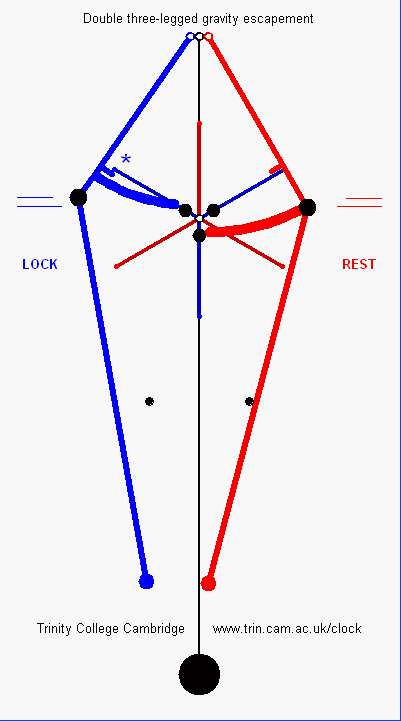

          Just googling around I found https://www.trin.cam.ac.uk/about/the-college-clock/ which describes the Dennison gravity escapement. It appears to me that the left hand lever will be lifted by more than the right, and so it gets a lopsided drive. Am I correct or this there some other trickery that I haven’t spotted? In any case, would it matter?

            Not sure I understand your thinking on that Duncan. Could you explain a little more.

              The curved pusher element (the bit that contacts the rotating 3 pin wheel) of the left hand rod is closer to the pivot than the right, so for the same horizontal displacement will be pushed through a larger angle.

                Yes I see. I think the drop can be controlled by the position of the stop pin each side which would give a way of equalising the energy input. I had the pleasure of winding that clock a few years back. It’s a very interesting machine.

                  Just a quick experiment, to see if that animated GIF will embed here:
                  IMG_0134
                  … evidently not 🙁
                  Edit: __ Yet, curiously, the copy in my Gallery appears to work

                    That makes sense, there would be a tad more clearance ar rest twixt the left hand pusher and it’s pin than the right

                      Just had a look at Denison’s comments in Clocks, Watches and Bells and he states that the lifting pins should be no further from the centre than 1/24 the distance from the centre to the pendulum suspension, which indicates he was aware of the issue. However his arrangement omits the stop pins and relies either on adjustable tails or bending the tails of the legs to equalise the beat. He states that great care must be taken to ensure that the leg coming to rest must be at the same instant of the lift of the other.
                      It is maybe useful to recognise that the primary objective in the design is to isolate the impulse from the large variation in drive from the train in tower clocks where the weather acting on the hands causes large variations in force.
                      There have been occasions on the Trinity clock where pigeons perching on the hands have massively altered the rate albeit temporarily despite the gravity escapement.
