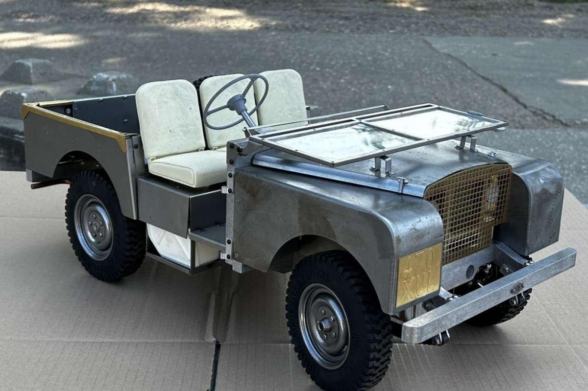

      This is a publicity shot of the model without paint, just to illustrate what the kit includes.

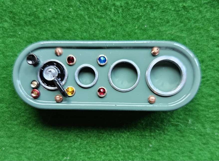

      IMG_E4614-scaled I am well into the build but taking a lot more time than usual to increase the detail.
      I’ll post individual improvements as I go along. One of the first things I decided on was the Dash panel.  It was a basic copy of the original and needed work to make it more realistic. I only need to address the dials of the gauges and it will look fine.

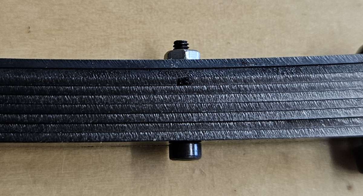

        #767173
        Plasma
          @plasma

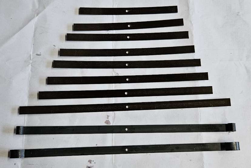

          The model chassis and suspension are first to be built, providing the basis for building the bodywork onto.
          Suspension is as per the original vehicle with multi leaf springs all round.
          Each spring is made up of individual tempered steel leaves and the kit requires they are just clamped between the axle casing and shock absorber bottom mounting plate.
          Full size springs have a centre bolt to prevent the leaves migrating and steel clips to prevent the leaves pivoting about the centre bolt.
          I wanted to replicate this set up on the model and so set about working out how to do it.
          A centre bolt would require a 2mm diameter hole to be drilled in each separate leaf on all four springs. Plus holes for rivets on the end of four leaves on each spring.
          That’s a problem,  how to drill 2.1mm holes in 1mm thick tempered spring steel without destroying the temper.
          That’s 52 individual holes required, accurately positioned in the centre of each leaf, for the centre bolts and rivets.
          I will leave you mulling over how to achieve this task. It took a fair degree of research to arrive at, and considerable work to develop the method.
          Mick
          #767174
          Plasma
            @plasma
            20240309_121601Here are the leaves with holes for the centre bolt, the rivets bolts have yet to be drilled.

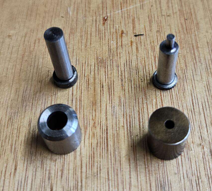

            #767186
            Circlip
              @circlip
              A simple press tool springs (bad pun) to mind. Punch rather than drill.
              Regards  Ian
              #767191
              bernard towers
                @bernardtowers37738
                Yep my thoughts as well

                  An interesting model. What has happened to the lights on the front ? Noel.
                  #767243
                  Nick Wheeler
                    @nickwheeler
                    They’re behind the radiator grille on a Series 1. And the model shown has them.

                      Yes Nick,but only the first few hundred. By 1949 the headlights were mounted in the grill more or less like the 2a. The very early ones also had the so called shovel seats. Noel.

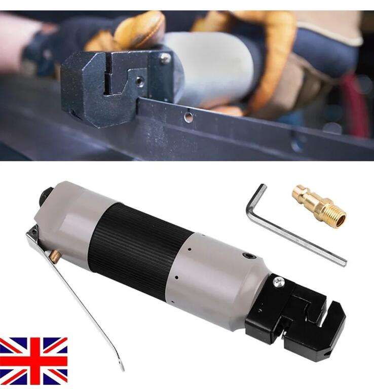

                        The idea of punching spring steel is pure madness!  But it’s the answer, apparently full size leaf springs are cold punched.
                        I didn’t fancy the thought of hand punching the springs, accuracy is pretty important to ensure the assembled springs look right.
                        So I bought a pneumatic hole punch and modified the head by making a new punch and die for it.

                        #767380
                        Plasma
                          @plasma
                          <p style=”text-align: left;”>20240309_12160120240308_145358The punched leaves of one springs, and then assembled with a centre bolt.</p>

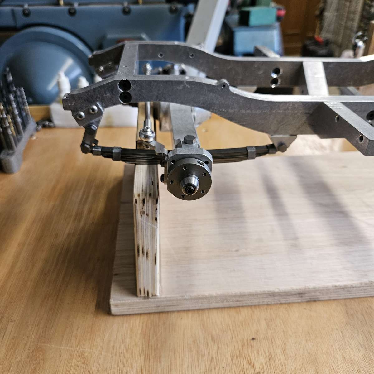

                          #767381
                          Plasma
                            @plasma
                            20240313_141815
                            #767382
                            Plasma
                              @plasma
                              The front spring in place within the chassis, the leaf clamps were made from 1mm thick galvanised steel sheet.
                              So that’s just one aspect of extra detailing I have undertaken on this model. There is a lot more to come so stay tuned.
                              By the way, Rover made so many changes to the pre-production models before they went into production.
                              JUE177 is the first ever pre-production vehicle and even that one has some build quirks, such as it is fitted with both types of fixing for the canvass top on the body work.
                              I’m.going to copy the original as closely as possible.

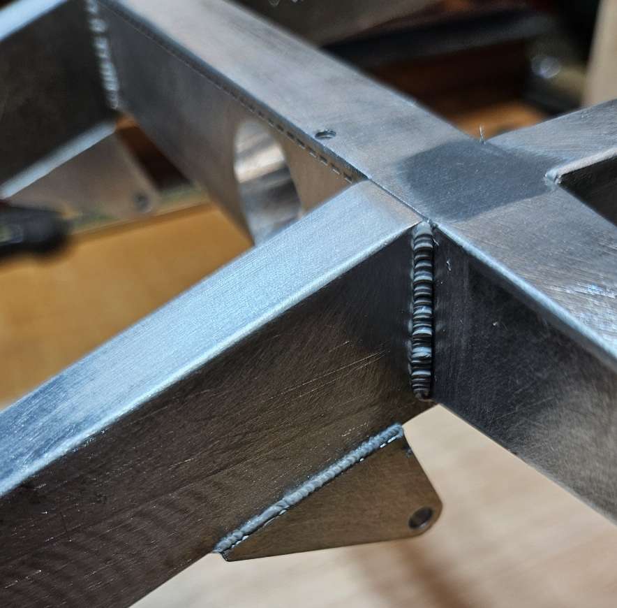

                                        #768582
                                        Plasma
                                          @plasma

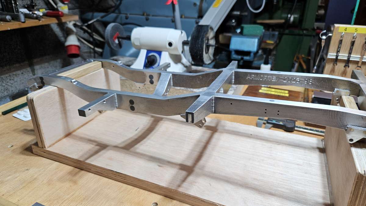

                                          A little more progress made this week, mainly building up stuff that I had dry fitted before painting.
                                          The chassis has plenty of screwed fixings which stick out visually if left as per kit instructions.
                                          I filled them with P38 prior to painting. The look is so much better and well worth the effort involved.
                                          I also wanted to do something welding runs on the chassis joints. The method I developed on my Centurion tank build was employed again. Using a syringe and blunted large needle to apply liquid metal in the same was as piping icing onto a cake.
                                          The chassis is all milled aluminium so I painted it with etch primer before a metallic silver to mimic the original zinc dipped finish. Clear coat to protect the silver and I can start hanging stuff from it.
                                          20240327_18333520240327_183307

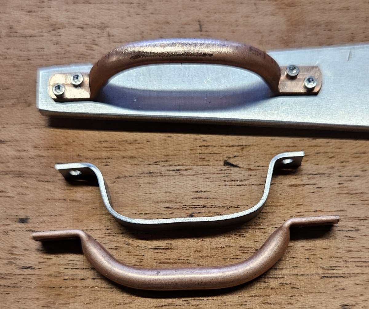

                                          Plasma
                                            @plasma
                                            I enjoy the challenge of detailing these kits far more than the manufacturers intended.
                                            As mentioned they are built to a price point so some of the included items are a little below the standard that a scale modeller would usually work to.
                                            The anti bogging down handles are a case in point. Fitted to the rear chassis outriggers they are intended to give helpers something comfy to grip while trying to lift the rear end out of soft ground.
                                            The kit has simple laser cut flat steel handle which are nothing like the original tubular handles.
                                            So with a little brake pipe tubing and some tinkering with a wooden former I came up with these.
                                            20240214_153538MM1.6 Allen head bolts to hold them in place.
                                            #769524
                                            noel shelley
                                              @noelshelley55608
                                              VERY neat ! Though the socket cap head doesn’t look quite right. The flat strip is Spoiling the ship for a hapth of tar. Noel.
                                              #769561
                                              Plasma
                                                @plasma
                                                Noel, I know, but finding hex head small enough wasn’t possible.
                                                Maybe I need to get on the lathe and make some.
                                                Mick
                                                #769600
                                                noel shelley
                                                  @noelshelley55608
                                                  Sorry Mick ! should have done the sums first. Yes it would need a 2mm head. An m1 x.25 might work though the head is above scale. Noel.
                                                  #769605
                                                  Plasma
                                                    @plasma
                                                    Noel,
                                                    We all open our work to critical eyes, be that the public at large, exhibition judges, or our contemporaries in the model engineering world.
                                                    I do so knowing that honest feedback is of great value if one is to improve and learn.
                                                    It’s good the hear from experienced engineers as I consider myself to be a self taught hobby engineer and every day is a school day.
                                                    The Landy model does have its limitations because it is built to house motors and batteries etc, but I like to add extra detail where I can.
                                                    I was really fortunate to meet Barry Jordan a few years ago and he looked at one of my models (an RJH belt linisher). He was very kind and said I’d done a decent job. One thing he told me that influenced my model making was that he considers his modelling to be more akin to sculpture than scale building, some items simply don’t look right at scale and so he’s prepared to modify certain parts to get the best look.
                                                    Mick
                                                    #769703
                                                    Plasma
                                                      @plasma
                                                      Noel.
                                                      I did find some nuts that were more in keeping with the original fittings, so I have reversed them and put the socket heads inside the chassis member and the nuts outside. With the bolt filed flush they look just right.
                                                      Mick
