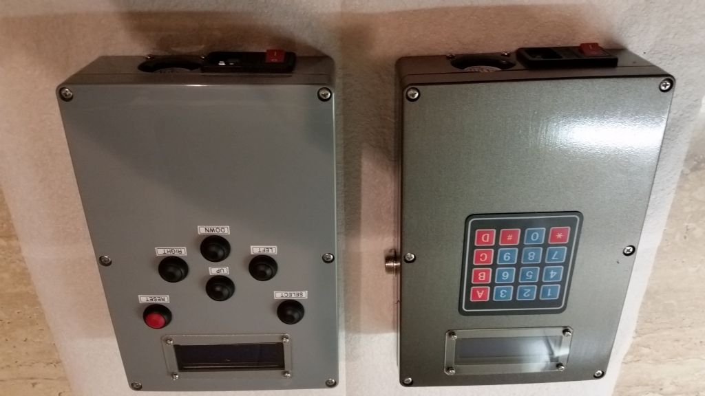

        Hi, Silly old Duffer, I have built both versions of the stepper rotary table box and they work wonderfully with one small exception. The keypad version causes a clunking sound in the stepper motor when running continuously and more pronounced when running an angle, say, 90 deg. The only change Iv'e made to your sketch is to change microsteps from 8 to 1. Iv'e made the corresponding change on the stepper driver board. Iv'e done this for both boxes. Needless to say when the same motor, used on the same rotary table, is run on the original box using Step indexer v2.3 there is no noise. Any suggestions? When I figure out how, I'll include pictures of both boxes.
        #313727
        Centurian
          @centurian

              #313736
                Hi Centurian,
                Well one obvious difference is that yours is better made than mine.
                My initial reaction is that differences between the keypad version and the original version are mainly in the human interface logic and that shouldn't have an effect on the motor. (Famous last words.) The little bit of code that drives the motor is very similar in both versions. I didn't notice any unusual funny noises when l did my testing; Stepper motors do make odd noises. That said I need to refresh my memory. I'll look at the sketch to see if I can see anything in it that could cause your symptoms.
                The thing with the micro-steps is to make the values in the sketch match the switch settings on the controller. From memory though, a mismatch shows up by the motor turning wrong angles rather than making odd noises.
                Are the power supplies identical? I reluctantly used a 6A 12V LED driver because they're such good value, rather than best for the job. As stepper motors are pulse driven it's important to have enough amps available. The Stepper Motor notes recommend an unregulated supply for that reason. You could try adding an electrolytic capacitor across the PSU's output to act as a reservoir. (By the way, with hindsight, I wish I'd used a 24V supply. I think that's the best way to speed up the motor. )
                Happy to discuss further!

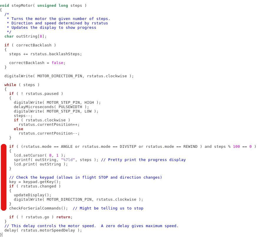

                #313746
                  Hi Centurian,
                  Something for you to try. I'd forgotten that my keypad version allows a motor operation to be interrupted and that it displays a progress report. It's possible that these features cause motor pulses to become irregular. The code that might cause a problem is in the stepMotor() function and is marked with a red bar below:
                  In ANGLE, DIVISION STEP and REWIND modes, the display is updated once every 100 steps. This is unlikely to be the cause. You could try increasing 100 to 10000 to see if that helps.
                  The keypad is checked after every motor step to see if the user has stopped the current operation. This could cause delays if the keypad is reporting key presses, because it's been lent on or is faulty. You could try commenting out key = keyPad.getKey().
                  checkForSerialCommands() reads the USB interface to see if a connected PC is trying to take control. Noise on the link could cause delays. As you're unlikely to be using remote control, the check can be commented out.
                  Another parameter you could play with is PULSEWIDTH. It controls the width of the pulse sent to the motor. By default it's set to 500 microseconds at the beginning of tyhe sketch. Possibly 500uS is a bit fast; try increasing it in steps of 25. The downside is that the motor will slow down.

                    #313872
                    Centurian
                      @centurian
                      First my thanks to Neil for righting my wrong photos. Second to Silly Old Duffer, the mod to the sketch,i.e. changing the delay from 100 to 10000 worked a treat. Just to be sure I changed it back again and the noise re appeared, so it is now running at 10000, I suppose I should try various values, maybe later. Once again thanks.

                        Hi Centurian,
                        Glad that worked. Of all the possibilities I thought that least likely, though you spotting the noise occurs every 200 steps is a clue!
                        I've got the controller and motor in front of my computer ready to see if I can replicate the fault after lunch. Now you've very helpfully isolated it I can focus on the naughty code.
                        Many thanks for raising the issue. Any other feeedback would be welcome. I like to involve other people in what I do because they are much better at spotting my mistakes than I am! Not so easy to find volunteers now I'm retired.

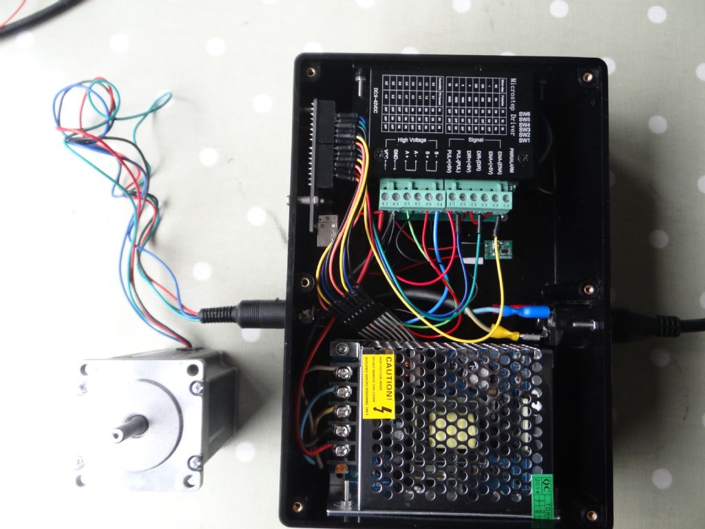

                                Dave. Thanks very much for your reply. I have been trying out your suggestions. I already had micro stepping set to 1. Changing to microseconds and from 2000 down to 1 has the motor spinning smoothly and at a suitable rate. Unfortunately it only runs at this speed when run continuously, not when dividing etc.
                                The motor is attached to a dividing head with a 60:1 worm and 5:1 gearing, so at 10 rpm would take about half an hour for one revolution of the chuck! Too slow even for me.
                                I wondered if you had any more ideas.
                                Thanks Mike

                                  Hi Mike,
                                  Sounds as if something's adrift, and it reminds me vaguely of problem I had ages ago. I'm just home after a tiring day and me brain is frazzled! I'll get my motor and Arduino out tomorrow and try and recreate the fault after a good sleep. Watch this space!
                                  #322804

                                    Can you provide details of the motor you're using and a photo of the wiring please?
                                    Another thought. You mention a 5:1 gearbox as well as a 60:1 table. Is the 5:1 gearbox necessary? It converts a long wait into an eternity and I doubt you need the extra torque it provides.

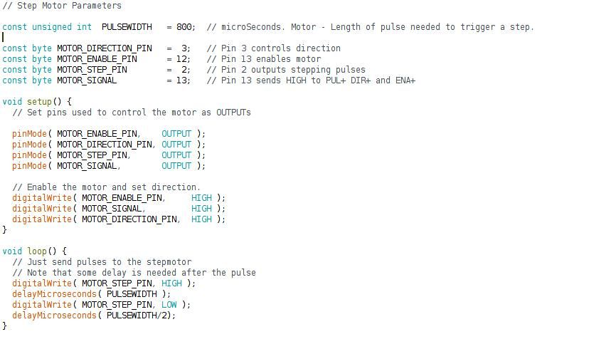

                                    #322832
                                      Here's a sketch for testing a stepper motor & it's controller with an Arduino. It does nothing but send pulses to the controller and can be reconfigured to try different pulse rates, widths, and ON-OFF ratios.
                                      Note that you may need to change the MOTOR_DIRECTION and other pin declarations to match your wiring. (My build doesn't use the same pins as the MEW article.)
                                      The values to play with are PULSEWIDTH and the value in the very last statement (delayMicrosSeconds)
                                      PULSEWIDTH determines how long the ON part of the pulse lasts, and the OFF part can be manipulated by dividing it. My motor mostly works with pulses that are OFF for about half the ON time.
                                      Experimenting with my motor and a 12V supply:
                                      • Sending ON pulses that are much too short (my motor < 350μS) causes the motor to stall and whistle,
                                      • Sending OFF pulses that are much too short causes the motor to stall
                                      • Likewise, sending ON/OFF pulses that are a bit too short causes the motor to miss steps. It runs, but slower, perhaps much slower than expected.
                                      • By experiment you can find the sweet spot for a particular DIP microstep setting on the controller. That is the combination of rate and On/Off time that runs the motor without losing steps. As this is likely to depend on load, it would be best to be conservative about racing the motor.
                                      • The sweet ratio isn't the same for across all microstep options.
                                      The values used in the MEW article are 'safe' in that they are unlikely to cause lost steps. You can speed the motor up by tuning the program, but take care! In theory, even better speeds are possible with a higher voltage supply but I've not been able to try it yet.
                                      Mike: I'm not sure if it helps but your symptoms match what happens when the motor is sent fast pulses. It may be revealing to experiment with the sketch to see what your motor does.
