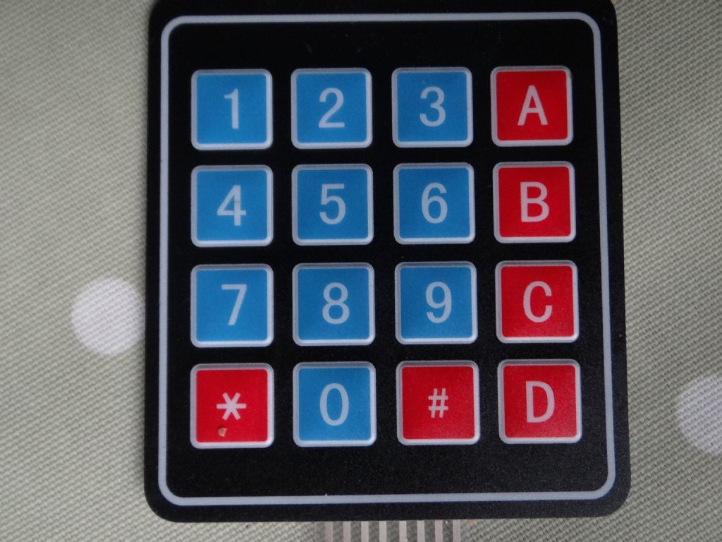

        I rather agree with JS on the subject of nested menus. They're a way of controlling a lot of functions with a few buttons, and that can be confusing, or even completely opaque. I have equipment where it's impossible to access the deeper functions without a manual.
        Gary Liming's Rotary Table menu system is fairly clear, but I think I could improve on it if there's sufficient interest. I can suggest three ways input might be simplified, without changing the display, or requiring too much new hardware.

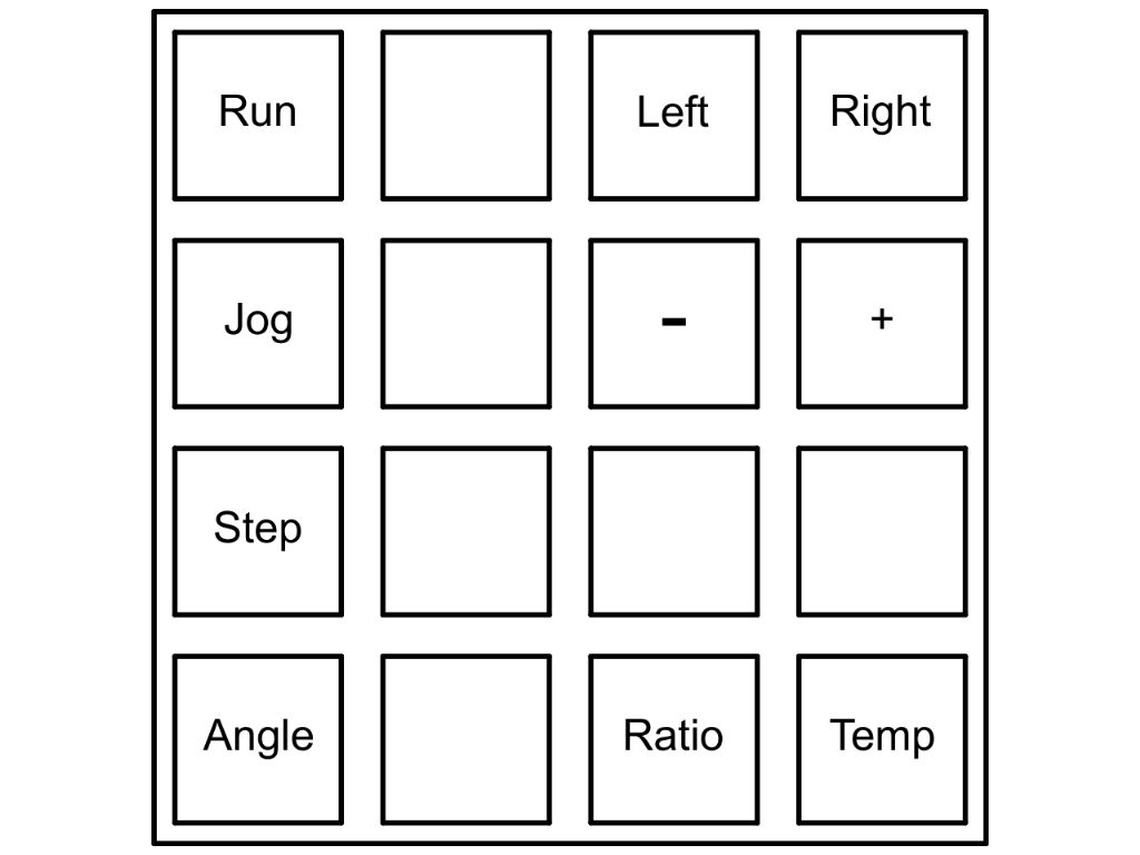

        One, with a 4×4 keypad, thus:
        Cheap waterproof keyboards are readily available; the main problem would be applying the labels. Anyone know how to print on plastic or rubber sheet to make an overlay?

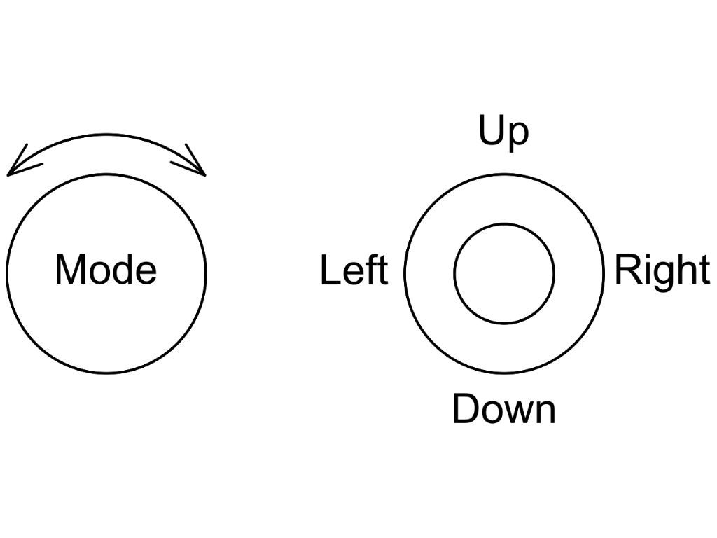

        Two, with a rotary digital encoder and a panel mounted joystick. The mode would be dialled up by turning the Mode switch. Then up, down, right, left and 'go' would be selected by moving and pressing the joystick. Labelling is easy and the switches could be protected inside a box.

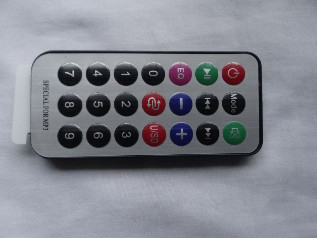

        Three, with a Remote Control like this one:
        I'm not happy with the remote method: it's expensive, has excess buttons, I would lose the stupid thing, and I don't like the idea of controlling machinery with with a remote that might get sat on!

                                  Here is a link to some Chinese membrane keypads on The Bay, 2 for £0.99 and free shipping.
                                  These, and the press button ones, are simply a 4×4 matrix connected via 8 wires (4 across, 4 down).
                                  If you want a library for simple integration, there is one on the Arduino Playground, or you can write your own code to do the same thing (can make for smaller code, as you do not need to cater for different sized keypads).
                                    Cheers,
                                    I must admit I had been thinking along slightly different lines, the rotary being used to do the up/down, but also when in jog mode to actually do the movement. In run mode I had considered using a single axis joystick, but then wondered if a rotary, joystick and something to change mode was to many controls. As with so many things what can make a good application bad is the user interface.
                                    Baldric

                                          The one in your link is a 4x3 matrix so 7 pin socket
                                          Similar 4×4 pads do have 8 pins such as this

                                            Posted by Baldric on 22/02/2017 12:51:43:
                                            Posted by SillyOldDuffer on 21/02/2017 16:00:53:
                                            Baldric
                                            Hi Baldric,
                                            Not much progress as I've been diverted on to parent sitting; my mum is just out of hospital.
                                            I hadn't thought of using the switches as you describe, but it is logical! Just goes to show why interfaces are difficult to design. We all expect things to work our way. I was going to jog by pressing the joystick, but the rotary encoder has a press switch too.
                                            At the moment I'm tendiing towards a matrix keypad with the option to control it with a serial interface as suggested by Bazyle as well. It wouldn't be difficult to do away with the physical USB connection with a Bluetooth wifi module and put a graphical interface on a tablet.
                                            A big advantage of a keypad is that mode-select can be done with a single keypress.

                                                My mistake – I meant to link to this one here, same price of £0.99 for 2 but 4×4 matrix.

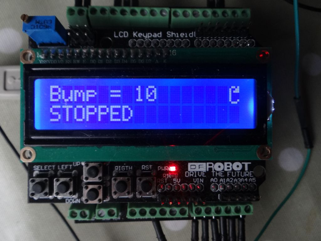

                                                  For anyone interested the latest update to my keypad based indexer and a pdf to read are at this Dropbox Link
                                                  Using a cheap matrix key pad like this:
                                                  It provides the same functions as the Gary Liming's program, but has been extended in various ways. (Mainly the ability to type in numbers, PAUSE, REWIND and control via the USB port.)
                                                  • 'A' sets Angle mode. The angle may be a decimal. eg. 41.75°
                                                  • 'B' sets Bump mode (aka Jog)
                                                  • 'C' sets mode to continuous (ie motor turns until stopped)
                                                  • 'D' sets DivStep mode.
                                                  • '*' starts and stops the motor, abandoning the current operation. (The next operation will continue from the stop position, see '1' and '5' for palliatives.)
                                                  • '0' toggles motor direction between clockwise and anticlockwise
                                                  • '1' rewinds the motor to the start point of the previous operation. Up to 10 previous operations may be rewound.
                                                  • '5' pauses or restarts the current operation, which then completes as normal.
                                                  • '9' enters ratio mode. The ratio may set to any integer value.
                                                  • '#' allows control numbers to be entered, for example to set a required angle, or the bump distance. Numeric entry is ended by typing a second #. In number mode '*' doubles as the decimal point.
                                                  The display uses the DFRobot, though it's push buttons are ignored. It is not difficult to substitute a cheaper 1602 display only board or an I2C display. In this example, Bump is selected with 10 steps clockwise. Pressing '*' jogs the motor. A Bump too far may be undone by pressing '1' to REWIND it, which is handy.
                                                  When the motor is running a progress countdown is displayed.
                                                  If you try this please report any bugs. Although there's been lots of testing it's amazing how the bleeding obvious still slips through!
                                                  The pdf includes more examples and the wiring diagram.

                                                    I've built a driver for my turntable exactly as specified in the article and cross checked with Gary Limings articles. My problem is that when I power it on it works as advertised to the point where it displays the correct startup screen I.E
                                                    Select Mode, Mode = Step. If I press Select nothing happens. Pressing Left scrolls through the Modes. Pressing Up also scrolls through the modes and Down Scrolls through the modes in the reverse direction. Pressing the "Right" button does nothing. Pressing reset does a reset and also switches off the run light on the stepper driver module. At all times whilst power is applied the actual stepper motor is locked. I have tried another display module and also a different processor module. ( an Arduino Mega) I have also tried it with no stepper driver connected. all I get is the above. Does any one have a clue what I'm doing wrong? I have been very careful in my wiring and anyway I have tried it with just the Arduino Uno and display shield.
                                                    #309303
                                                      Posted by Centurian on 29/07/2017 07:05:01:
                                                      Hi Centurion,
                                                      This sounds like a well known problem that was discussed earlier on this thread. See my post on Page 4 and John Swift on page 8.
                                                      Those buttons are not individual switches. Instead, they cause a voltage change when pressed. The Arduino measures the voltage and decides which button has been pushed. Your problem is probably down to a small difference between the various versions of the Display Board. (Apart from there being a Mk1 and a Mk2, there are plenty of clones.) To fix it all you have to do is alter a few numbers in the Arduino Sketch to match your particular display board.
                                                      The code is the six 'if (Key_in … )' statements right at the end of Gary's sketch. It looks like this:

                                                      delay(ADSettleTime); // wait to settle
                                                      // average values for my board were: 0, 144, 324, 505, 742
                                                      // add approx 100 to those values to set range
                                                      if (key_in > 850) return NO_KEY;
                                                      if (key_in < 70) return RIGHT_KEY;
                                                      if (key_in < 250) return UP_KEY;
                                                      if (key_in < 450) return DOWN_KEY;
                                                      if (key_in < 650) return LEFT_KEY;
                                                      if (key_in < 850) return SELECT_KEY;
                                                      Note Gary Liming's comment
                                                      In the example above are the key_in values I used. (850, 70, 250, 450, 650, 850) You might try those values first.
                                                      If that fails, download this sketch and temporarily install it instead of Gary's program. All the sketch does is display the actual number generated by your keys. Write them down, then change the key_in values in Gary's sketch as per his +100 comment and re-install it.
                                                      With luck all should now be well.
