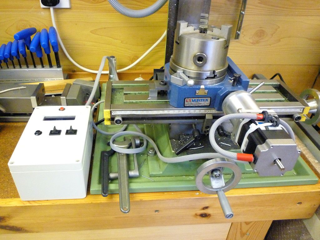

                        Still trying to get this to run without vibration! I tried a different driver a TB6600 based unit but no change.Whilst I was fitting the new driver I also brought the reset button onto the front panel. It works and if set in "run" mode it turns quite nicely for as long as you like. In "angle" mode it's not too bad unless you set a large angle. In "step" mode it starts off OK but then becomes quite noisy. As far as I can tell the angles turned are correct (they agree with the table divisions) and the number of steps is right.
                        As it is quiet in "run" mode I can only assume that the noise/vibration is being generated by the software but I don't know enough to sort that out. It also seems strange that the vibration gets much worse for the second half of a step.
                        I made a video and put it on **YouTube** so that you can hear the problem. Any suggestions much appreciated.

                          Posted by Journeyman on 19/02/2017 16:32:54:
                          My motor makes similar noises but nowhere near as loud. Is it possible that your bench set-up is acting as a sounding board? (Try lifting the table while the table is turning.)
                          The other thing that makes a slight difference here is the motor power dip switch settings.
                          I'm running off a 12V 2A continuous regulated PSU (5A peak). I can't find the reference but I think I read somewhere that: step motors are likely to resonate; that resonance can be minimised by adjusting the voltage; and that stabilised power supplies make the problem worse. But beware, I misremember a lot! Do you have a different PSU to experiment with.
                          Edit: this link isn't to what I was thinking of, but it's similar.
                          Edited By SillyOldDuffer on 19/02/2017 18:07:50

                          Journeyman
                            @journeyman
                            Dave, the bench is certainly acting as a sounding board but it is still loud even if I pick it up. No spare power supply but I have a feeling it may work better with 24v. What I find really odd is the change in tone half way through a step. It sounds fine if I just set it to run though. Confusedfrown

                            Carl Wilson 4
                              @carlwilson4
                              There is nothing wrong with it. The bench is acting as a sounding box and is amplifying the normal sound the unit makes.

                              Journeyman
                                @journeyman
                                Thanks Carl, I will bolt it to the mill later and see what it sounds like then. I need to try some test machining with it anyway so a dual purpose run. I know stepper motors make all sorts of weird noises but I still think this is too loud.

                                Carl Wilson 4
                                  @carlwilson4
                                  That’s OK.
                                  My post might have seemed a bit perfunctory but I just meant that from what I can see in your clip the unit is working within normal operational parameters.
                                  It is in the nature of stepper motors to have a rather staccato sound and feel to them when running due to the way they are driven.
                                  You could probably quieten it with some passive measures but I doubt there is a huge amount that could be done in either soft or hardware.
                                  Even if there was, is it worth it?

                                        Journeyman
                                          @journeyman
                                          Neil, tried micro-stepping makes it slower but not much quieter.
                                          John, knowing very little about Arduinos or programming made this a useful first project. Menus aren't too bad select mode on one switch and then feed in number of steps. Agreed if you needed to set large number of steps or high angle this would take time but anything I am likely to do in the near future will be something like 6 steps or 60deg.
                                          Set it up on the mill. Is a bit quieter but the main thing is it works spot on. Put a bar offcut in the chuck set it for 6 divisions and drilled 6 holes. Then went round again and the drill re-entered the hole exactly. Set it to 60deg and went round again and the drill lined up exactly. Then tried 7 divisions and was surprised that everything worked exactly the second time round as 360 does not divide by 7 exactly.  Box gets slightly warm after an hour messing about but nothing untoward. Well pleased and will now call it a day, awaits to be used in earnest.
