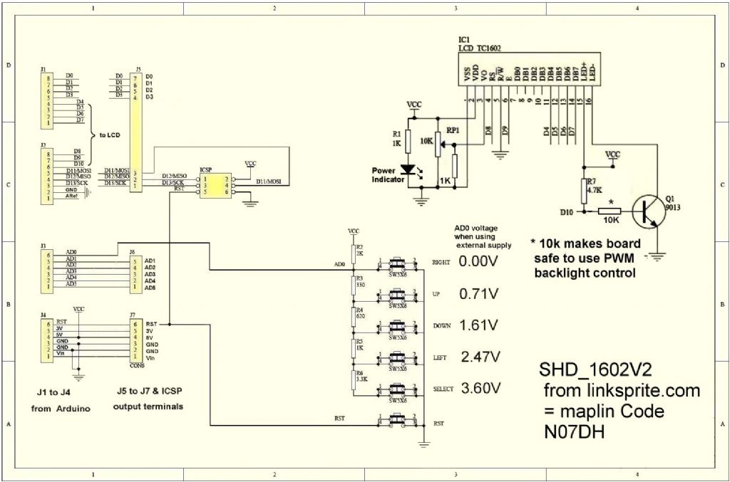

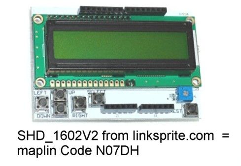

            now I have an Arduino uno clone and I picked up a LCD sheild yesterday
            I can update the diagram for a PWM compatable LCD sheild and possible veroboard DIY sheild
            I need to double check which arduino pins are used for the stepper driver
            I thought digital outputs 0 & 1  are used for step & direction but I can't find the expected step pulses when I jog or run
            shd_1602v2 from  linksprite  =maplin code n07dh.jpgpwm brightnes mod lcdkeypad_shield_maplin.jpg
            note – on this sheild the 10K between pin D10 and the transistor base prevents damage to the Arduino

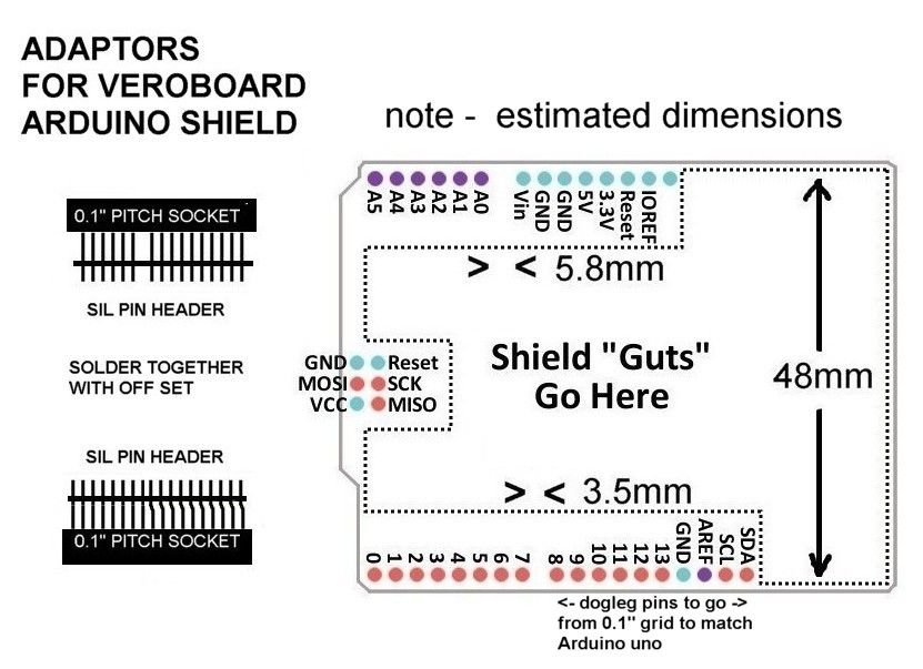

            I have confirmed 3 out of the 4 UNO terminal line up with the 0.1" grid of veroboard / perf board
            using the long pin Stackable Header Connector sold for the arduino
            the offset of J2 (D8 to D13 , gnd & ref) is small enough to bend the pins to fit int the Arduino socket
            Edited By john swift 1 on 13/12/2016 11:44:24

              I’m not at all sure what benefit this arrangement is giving you. Can you enlighten me please?
              #271656
              john swift 1
                @johnswift1
                Hi Carl
                only having the Arduino and LCD shield a day your rotary table control is the 3rd program I have tried
                and it works although I need to find the step and direction outputs
                ( the first being the blink & fade examples that come withe the arduino ! )
                some my web searches for the arduino highlighted the issue with some LCD shields if you attempt to use PWM brightness control
                (while its not an issue with your project now but it can be when an astromomer adapts it to control a telescope drive )
                with a box of general purpose matrix boards
                it makes sense to me to use a mixture of matrix boards I have and arduino shields
                I need to look closer for the step & direction outputs are they output pins D0 & D1 ?
                are the outputs open collector and need pullup resistors to test without connection to a stepper driver ?

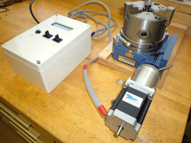

                                              Well I finally got my version up and running.
                                              All seems to work step and direction wise but there is a lot of vibration when the motor runs. It also seems to have a sort of two vibration mode, it start quietly for the first part of an action and then vibrates like mad for the second half. Seems to be the same for long or short runs. i.e. if set to turn 5deg the first 2 will be quiet(ish) and the final 3 will try and vibrate it off the bench. If set to 30deg same sort of thing.
                                              Also likes one way better than the other but I think that is just down to the worm engagement. The switches also need de-bouncing a bit more, have tweaked some of the parameters in the sketch but not quite sure if that is the right way? Still at least it functions.
                                              I was thinking of putting my build version, duly acredited of course, on my web-site. Any problems with that?

                                                Nice work, it looks great! I did not expect anyone else to use paddle switches. They were just what I had but seemed like the better solution to me.
                                                No problems from me with putting it on your website.

                                                  By the way John, took me quite a bit of fettling with worm engagement to get smooth running.

                                                      Thanks Carl, any clue as to the vibration it does this even with the motor detatched. I have read about resonance but don't understand it and haven't come across anything simple to get rid of it. Are there any settings on the driver board that can be tweaked?
                                                      I think the paddle switches are a good idea (but I have one wired back to front, just need to swap the leads) I might also bring out the reset button as I have found some modes you can't interrupt.
