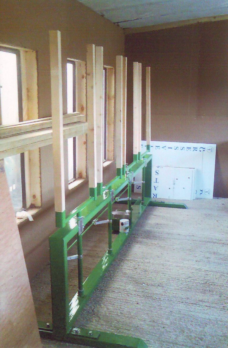

        ronan walsh
          @ronanwalsh98054
          Posted by Iain Campbell on 05/11/2014 13:57:05:
          As for the original posts – yeah, Arduino can do that (though I doubt FFT can be done if the chip is on a par with PIC's). The problem you may have with using an Arduino is one of spec creep – will you be just satisfied with what you say in your post? Or will the inner geek in you start to show a bit and make you think "Wouldn't it be good if it could…?" in which case, I doubt it would be long before an Arduino isn't good enough! C'mon, who doesn't do this??? nerd
          Iain
          No Iain i don't believe that spec creep would be an issue, i only want the thing to work and that would do. What happened was i was given an old industrial warehouse door opening mechanism about 5 or 6 years back. A forklift truck would approach the large rubber door and when near would break an infrared beam, when the beam was broken the door would open (open sesame) and be held open by the mech until the forklift had gone through or stayed open if something continued to break the beam.
          The mechanism itself was a great bit of kit , containing a small but very torquey motor, and an electronics board. With various pot's and things on the board i was able to get the motor shaft to turn 90 degrees, and i encorporated the door opener into the turning target you see in the picture below. I connected the shaft of the motor to one of the target uprights (near the can of paint) and connected the other three targets to the powered one via tie-rods.
          The thing worked great, an electrician in the club replaced the infrared beam sender with a simple switch. There the happy story ends, the club had a bit of a civil war with the usual politics and other rubbish and the target was never allowed onto the range, but was chucked outside in the elements. When we did manage to get it out on the range after about three years, the thing wouldn't work well. What happened next really annoyed me, everyone and his wife decided to dismantle it and have a mess around with things they didn't understand (now i know what soldier proof, idiot proof etc means). People with zero technical or any sort of engineering experience suddenly become experts ….until the time comes to put it back together and all the parts are in a heap and then they suddenly aren't.
          Anyway the thing has finally been dropped back in my lap with the task of getting it going, hence my idea of a stepper motor and an arduino.

          Les Jones 1
            @lesjones1
            Hi Ronan,
            I assume the above picture shows the mechanical arrangement. If so do the 3 targets sit on the 3 vertical pairs of wooden supports and does it only stop in 2 positions, face on and edge on ? In your original post you say that you need to control how long the motor runs for. Does this mean that you need to control the time taken to move between the two positions ?
            Les.

            ronan walsh
              @ronanwalsh98054
              Posted by Les Jones 1 on 06/11/2014 08:58:52:
              Hi Ronan,
              Les.
              Thanks les, there are four pairs of uprights if you look closely, hard to see in the photo i know. Yes the motor stops in two positions as you say, edge on , and then rotates 90 degrees to be face on. Its not the speed i want to control (but i want them to turn as fast as possible) but how long the target is face on. I don't actually know the times, but i think its 10 sec's , 20 sec's and 5 mins.

                I'd be tempted to resort to a 555, a relay, a handful of switches and a set of trimmer pots for setting the delays (and I'm a big AVR fan).
                (Confession, I'm planning an AVR box to show whether each dogs or cat has been fed or needs feeding, I did wander off into thinking it could have an LCD display with a colour picture of each animal and a touch screen)
                #168811
                Mark C
                  @markc
                  I'd be tempted to forget all about messing with home brew and get 3 el-cheapo timer relays, screw 'em to a small box and not worry about people getting electrocuted, beaten or shot for messing about in the box as there would be nothing in there to mess with! Added bonus, relays have built in ready to use power output stage and all nicely CE approved….
                  Mark

                  Iain Campbell
                    @iaincampbell84581
                    Neil – I KNEW I wasn't the only one trying to resist spec creep urges! laugh Liking the LCD idea!
                    Assuming the targets are not fairly heavy, and assuming ease of putting it together is more important than cash, you can get stepper drivers pre-built and tested from Ebay for Arduinos (or anything else for that matter) for a few quid each. L298N based drivers are popular. Get an Arduino board as well and simply connect them together – Arduino to driver to motor (OK, there's a bit more to it than that, but not much more). There is bound to be some tutorial for the Arduino to control the motors, similarly for adding buttons and doing some timing. And then off you go.
                    If you have a search on Google for "arduino with 3 stepper motors" there's plenty to look at. Adafruit and SparkFun are two sites with plenty about Arduino and stepper motor drives. In fact, this page **LINK** is a good starting point. Sparkfun are based in the US, but there's a UK equivalent called Cool Components and both will sell you the bits, too.

                    Les Jones 1
                      @lesjones1
                      Hi Ronan,
                      I think using a stepper motor is just adding complication to the project. I would suggest just using a permanent magnet DC geared motor with limit micro switches. Just reversing the polarity would drive it to the opposite position The 2 micro switches would be wired in series with the motor and each micro switch would have a diode in parallel with it so it would only stop the travel in one direction. You could use a micro controller but Neil's suggestion would work just as well. I use a similar idea to this to open and close curtains but instead of using micro switches I have an over current sensor that gives an output when the motor stalls at the end of travel. This is actually controlled by a PIC micro controller. As well as removing the power to the motors when over current is detected it also limits the time the motors are driven as a backup. The unit is powered from a plug in timer which comes on for 2 minutes at night an 2 minutes in the morning. The unit remembers which direction it last moved using the EEPROM memory.
