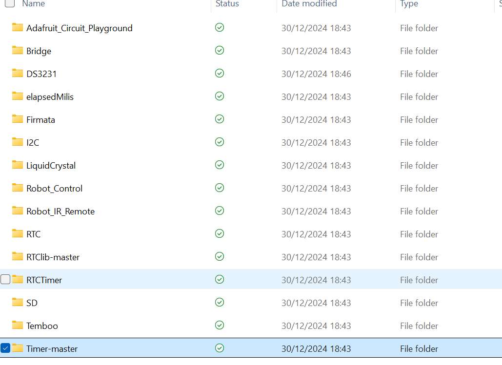

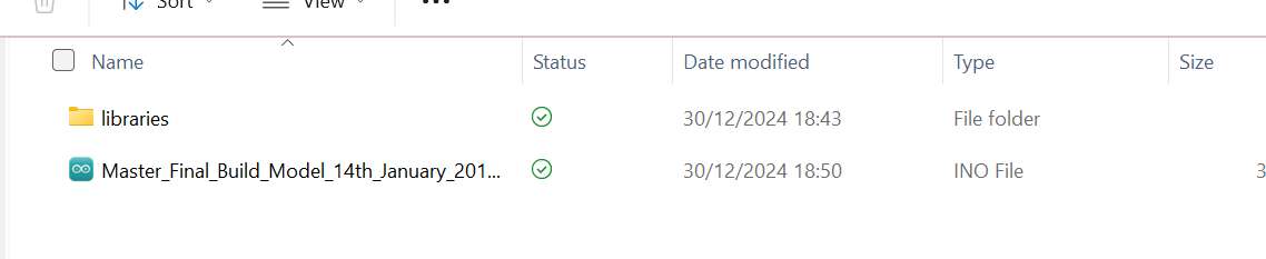

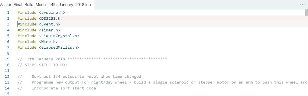

                          #773581
                          James Alford
                            @jamesalford67616
                            Thank you, Dave.
                            This is where the libraries and the ino file sit:
                            Screenshot 2024-12-31 082537
                            These are the libraries: the event.h file is within the Timer-master folder.
                            Screenshot 2024-12-31 082103
                            This is the code.
                            Screenshot 2024-12-31 083616
                            Regards,
                            James.

                                Hi James, the screenshots have me flummoxed because they look correct.  Appears you’ve got the file and directory locations right, which is good, except it still doesn’t work!
                                I’ll have a look at how the Arduino IDE adds libraries to the compiler’s search list.   Might be done by the installer, in which case moving the libraries manually may may have missed a step.  May take a while, I’m unwell this morning.
                                If you fancy a go yourself, try setting the “Show verbose output during compile” tickbox, which is in  File->Preferences->Settings.   After that Verify the sketch and wade through the output looking for the library loads.   Comparing a successful #include with a unsuccessful #include may reveal the answer.   Unfortunately the log is huge, and written in techno-terse!   Look for lines containing the word library.
                                Might give the answer, but I have more hope that an internet search for “manually install Arduino library” will provide the answer – the missing step.
                                Just in case anyone reading this thinks Arduino is always this complicated, not so.  James has an unusual problem that’s forced us to open the bonnet and take the engine apart…    Rarely necessary!
