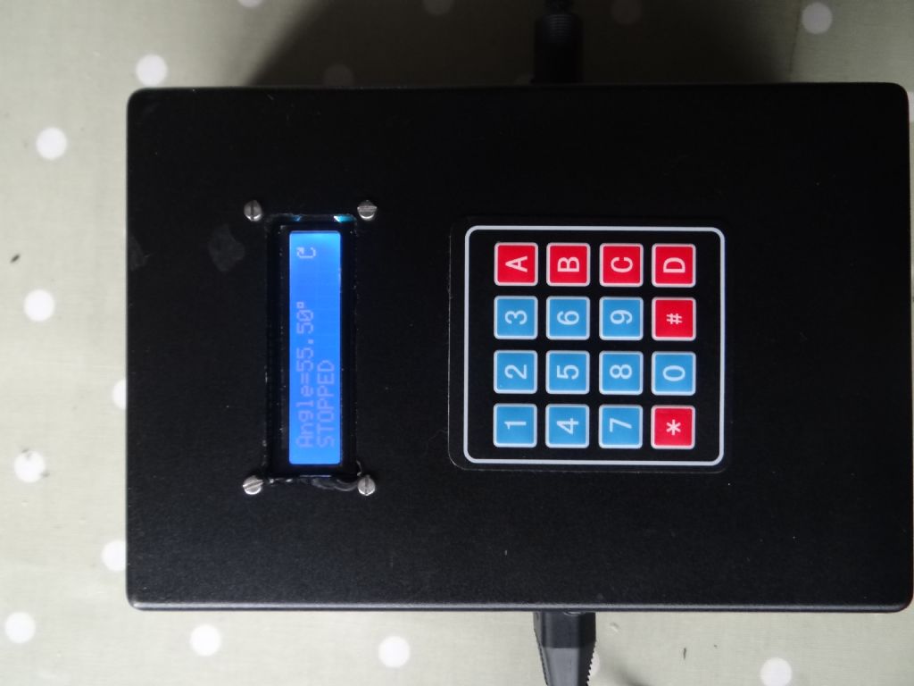

            There's a copy of Gary Liming's code in my dropbox folder here.
            Also, for those who don't care for nested menus made necessary by the LCD KeyPad Shield, there's my alternative. It uses a 4×4 matrix keyboard allowing numbers to be typed in directly
            A for Angle, B for Bump (aka Jog), C for Continuous, D for Division, # enter/leave number mode, * start/stop, 0 set direction, 1 rewind, 5 Suspend, 9 set ratio to suit different rotary tables. Number mode allows Ratio, Continual, Division Step, Bump or Angle to be changed.
            Blurb here, software here. Intended as to be a magazine article but I decided too many similar had been done already. The blurb is a bit ragged, but a few have been built if you prefer the 4×4 approach to nested menus.

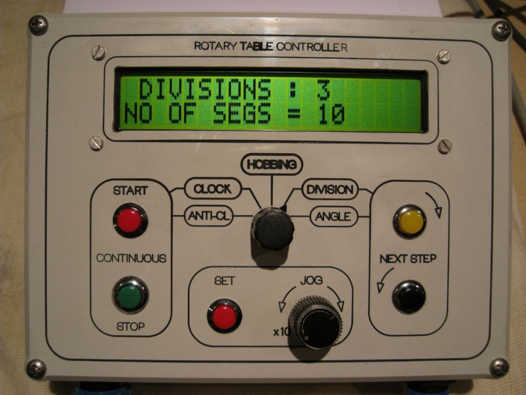

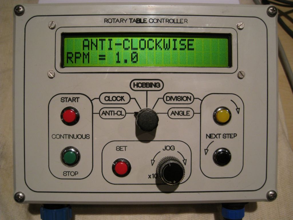

                      I made a few using a NUCLEO processor board – an STM processor based device, with an Arduino look-alike interface.
                      This one does a bit more than just a dividing head – among other things, it does gear hobbing as well, on a mill, for example, by fitting a rotary encoder driven by the spindle.
                      Anyway, the MMI is quite nice to use, the display clear, and does not use much I/O.
                      Joe

                        Bazyle makes an important point about user interfaces – they have to suit the user! Unfortunately, in addition to liking the controls, users also worry about cost, and, if its a project, how difficult it is to build. Designing good interfaces is difficult – lots of compromises and judgements.
                        The Liming's solution is a straightforward Arduino build. Cheap, well supported and plenty of modules. Gary's interface is a plug in display module with a 16×2 LCD and 5 push-buttons. This means his software has to deliver everything needed to control a rotary table with just 5 buttons. It's done with a system of nested menus, where pressing buttons navigates a tree of options until the required setting is found. The problem with this type of interface is it's not very intuitive, it's hard to remember, changing settings takes a relatively long time, and, by accidentally pressing the wrong button it's possible to get lost in the menu.
                        As John Stevenson mentioned he didn't like nested menus, I developed a rotary controller using a 4×4 keypad and a separate 16×2 LCD only module. The 4×4 keypad provides 16 buttons. Now the user can type in numbers 45.55°, and the keypad is conveniently labelled 'A' for Angle etc. The '*' button is go/stop. Most of the nesting is eliminated, the controls are easier to learn and remember, and it's possible to add more functionality, for example my version can be paused if the phone rings, there's a rewind function in case the most recent command moved the table wrongly, and the ability to type numbers allows the user to change to any table ratio, typically 1:40, 1:60, or 1:90. There's no need to label anything, though a laminated reminder list on the back might be handy. Slightly more difficult to build, about the same price as Gary's version, but the user still has to be slightly computer minded!
                        Joe's controller is the next step. He fixes the nested menu problem with 5 nice push-buttons, a five way switch, a potentiometer and a logical well-labelled front panel. The build cost is relatively high because of the number of components used, plus there's a need for some chassis banging to make the front-panel. Nothing beyond the skills of the chaps reading this forum.
                        All three approaches work, but I think most people would find Joe's version most intuitive. It's the most difficult and expensive to build, plus a moderate extra software hurdle to jump to get the Nucleo# working. Mine isn't as easy to use as Joe's, but – being simpler – it's cheaper and more straightforward to build. Gary's is easiest to build but the control interface is clunky. Some people can't get on with nested menus at all – they're just too annoying!

                            Hah! Was wondering if you were lurking Paul! Nice to see you are about!
                            If anyone is interested in tackling a version on my setup, I will gladly assist. Paul built a more Hobber oriented version and as he proclaims, 'knows nothing about software, microprocessors, or programming'..
                            I am very willing to help, provide circuits, diagrams as needed, etc. My good wife is the software fundi, and will gladly help to get you going with the Nucleo – you do not need to know any software language or know how to write software! We will gladly modify the current software to make it do what you want within project bounds and help you get it going. As Paul said, the electronics cost and effort is small compared to the rest – you need to be able to read simple circuit diagrams ( as opposed to electrical diagrams, but those too..) , need to be able to solder basic electronic parts and wires, and be PC 'able'. The rest is common sense! If you do want to learn more about it, the softare, sourcar code, etc we will gladly provide and help where we can.
                            Joe
