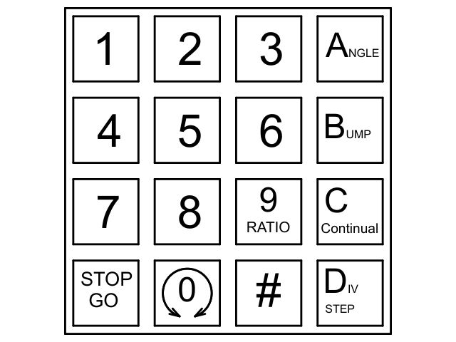

        The keypad layout has been changed to better match a standard 4×4 matrix type. It is laid out like this:
        The right hand ABCD and 9 keys set the operating mode. The table can be turned through an angle, Bumped (jogged), run Continuously, and Division Stepped. Key 9 allows the Ratio to be set.
        The # key allows a number to be typed in, for example the number of degrees to be turned in Angle Mode. Motor speed, Division Step, Bump distance (aka Jog) and Ratio may be controlled in the same way.
        Motor direction is toggled between clockwise and anticlockwise by pressing the 0 key. (This works unless the keypad is entering numbers.)
        The motor is toggled on and off by pressing the * key (marked STOP GO on the diagram).

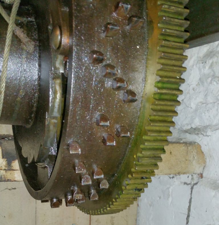

                  Ah, but I do have plans for that function – if they ever come to fulfilment I will let you know. As part of my clock project ( and the table controller is on the plan to help with gear cutting), I will need to make the chime barrel.
                  It has five tracks with 16 pins per track. The angular spacing of the pins create the sequence of notes for the tune.
                  I am thinking of setting up the barre on the rotary table, and creating a spreadsheet of the angular positions based on the tune. Export that as a sequence of angle commands one for each track and use the commands to drill the necessary holes.
                  PS I made a small change to the code. I have set the default table ratio to 72 to suit my table, and added a default value for  backlashSteps to avoid setting it up every time I switch on.

                  #607357
                    Posted by Peter Cook 6 on 25/07/2022 19:10:31:
                    Ah, but I do have plans for that function … As part of my clock project …I will need to make the chime barrel.
                    Chime barrel – fiendishly clever, I'd never have thought of that! I wonder how difficult it would be to program a converter to calculate angle and pin positions from a musical score? It would make it easy for a clock designer to provide barrel plans so builders could choose from a large number of different chimes.
