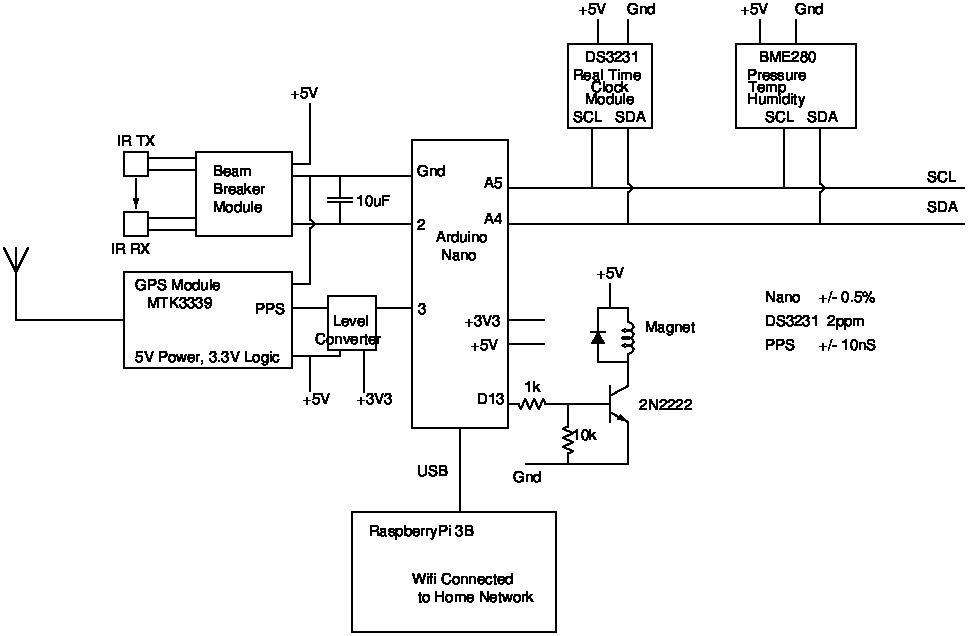

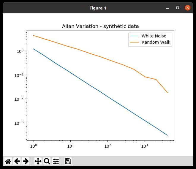

      My set-up at the moment is this:
      Supported with a Frequency Counter, oscilloscope and computer with an extensive scientific maths capability doing the statistics and graphs. Chief flaw is me, because the gap between what I'm doing and understanding it is much larger than expected. As you say 'the more I learn the more I realise that mostly I learn how little I know' : exactly!

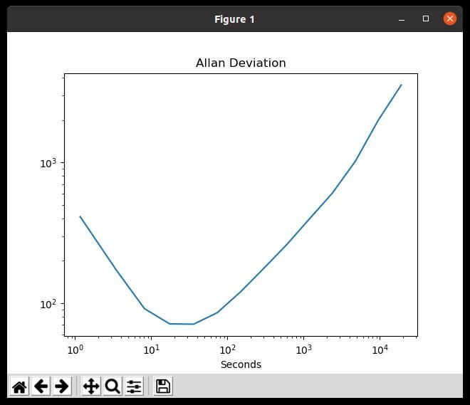

      Made some progress with Allan though. I've found a Python software module that does the hard work provided I can understand it! I was able to graph white noise and brownian motion.
      I understand White Noise to represent a perfect pendulum, one influenced only by truly random variations due to natural noise at the atomic level. The ideal slope is a nice straight diagonal line falling 45° to the right, shown in Blue.
      Real oscillators suffer other effects. For example, Invar alloy is unstable over time in that microscopic structural changes cause tiny increases and decreases of rod length. These movements alter the period of each swing causing the clock to go on a random walk that frequency modulates the period, oh dear. The orange line demonstrates Brownian motion which is characteristic of random walk error. Compared with white noise the slope and shape is different.
      This and other defects can be detected by taking many samples from the test clock and comparing them statistically with a better one. A promising technique, except toddlers need to learn to walk properly before trying to sprint! At the moment my pendulum has more serious defects.
      One thing Joe or another expert might know the answer to? In so far as I understand it, Allan requires me to generate a list of phase differences between the test clock and its reference. The Allan examples assume test and reference are both outputting 1 pulse per second (so calculating small phase differences is easy). Unfortunately my GPS reference is 1 pulse per second while the pendulum is about 0.883 pulses per second. How do I normalise the data-sets?

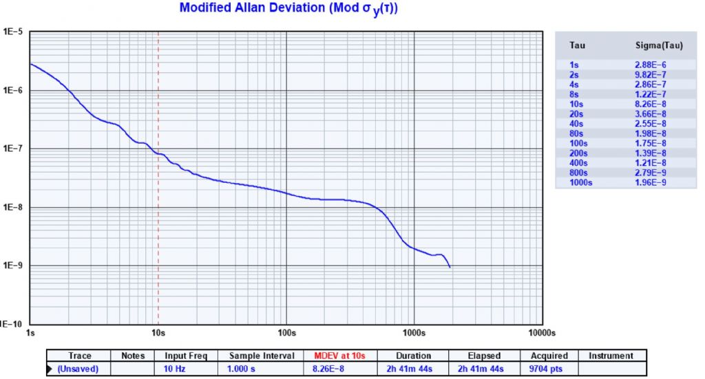

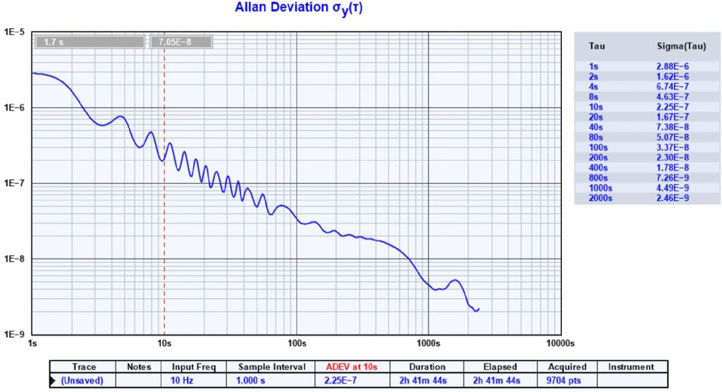

        No, Allan compares the test clock with itself. If you use the TimeLab package you just give it a big file list of successive period readings and it does the rest (IIRC).
        Here is an Adev plot of my "Arduinome" clock I just generated to remind myself.
        It takes the whole file of which only the first column are period measurements and ignores the rest. So far I haven't really worked out what it means but generally the trend is sort of diagonally downwards though with some flattening off. What the little wiggles result from I don't know. Good explanation here. If you explore that site you can read about Tom's adventures testing General Relativity on a camping trip.

          John, you are my hero. I had the fixed idea Allan analysed phase differences between clocks and managed to spin my reading of the documentation to cement the misunderstanding. Might have taken me weeks to get back on track. Thanks to you sorting me out it's easy to to apply any of the methods provided in Python's Allantools module.
          Interpreting the graphs is another walk in the dark, but I read your Arduinome chart thus:
          • The line generally falls from left to right, which is good.
          • The wave like wiggles in the first 100 seconds could be settling errors, maybe due to the pendulum vibrating after start-up, or the clock being bumped whilst the measurement was set up.
          • Y axis values are small, which I think indicates good stability.
          My clock's chart:
          • The tick shaped line is bad – rising to the right indicates a consistent rate error. Sharp falls are characterised by Rowland as observation error. In my case, pretty certain the observations are OK, and the real cause is pendulum bounce due to restarting the clock from scratch for each test.
          • Y-axis values are big, which I think indicates poor stability.
          Could be wrong!

              The comparison to a reference is already done by measuring the period. AV is a measure of how the period varies with time.

                      Joe & John's Q&A has clarified my thinking. What I need to do is upgrade my Arduino code to compensate for the deficiencies of its resonator. I can continually re-measure how many Arduino ticks are in a GPS second and use the info to adjust the pendulum measurement. Doing so will compensate for temperature and resonator drift, at least within the 4uS resolution of the Arduino timer plus however long it takes to service the interrupt.
                      A Nucleo would squeeze a little more accuracy than a Nano. 3x faster and they have a 20ppm crystal oscillator too.

                          Just to clarify, my plot is of a set of measurements taken when the clock is in equilibrium, not from the start of the run. I don't know where the wiggles come from – there is one key periodicity in the clock which is the impulsing, which during that run was probably happening every 40 swings or 80 seconds. (Currently I impulse every 30 swings.) Another option in TimeLab is "Modified Allan Variance" – if I choose that the wiggles go away.
                          What it means I still have to figure out!

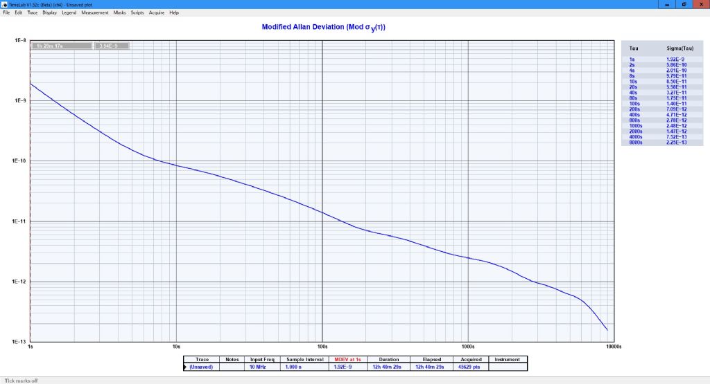

                              Posted by John Haine on 25/10/2020 06:30:35:
                              John, do you have Adev's for longer periods? – 10 hours plus? Interested to see that – if so maybe we should PM so as not to hijack this thread any further..
                              My GPSDO Adev for approx 12-1/2 hours @ 1 sec samples:

                                Not yet, I haven't properly understood how to use TimeLab so far. I have been posting some results here – may be aa better place as it isn't precious about file formats?

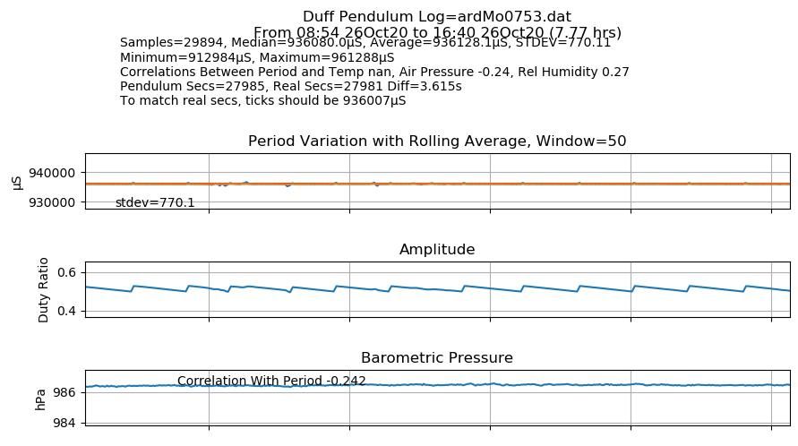

                                  A surprising result from yesterday's endeavours.
                                  First, my attempts to fray and hold the 0.5mm rod in a clamp failed miserably. Superglue wicks into the fibres, making them stiff and easily snapped. I'm completely out of 0.5mm rod now.
                                  Needing to test a software upgrade, I fitted a 0.3mm diameter rod. (No 0.3mm drills available but I was able to shim the thinner rod with some 0.5mm O/D, 0.3mm I/D brass tube bought for another purpose.) Also took the opportunity to fit a slightly bigger bob, foolishly forgetting to weigh or measure it before putting the shield back.
                                  Dropping the rod from 0.5 to 0.3mm made a big improvement. Q about 3000 and it takes much less power to impulse the bob. Currently getting about 20 swings per impulse. Zooming in on an undisturbed section of the run (I was working outside, so no vibration indoors) shows the Period holding steady while the amplitude sawtooths between impulses. The period can just be seen to jump when the impulse is applied.
                                  I guess the 0.5mm rod was acting as an inefficient spring and absorbing a lot of energy. Presumably the 0.3mm rod being about 1/3rd the weight and much less stiff makes it more efficient. Still surprised a small change made such a big difference.
