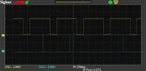

        Many thanks for the replies. Before I can do anythingI need to do is move my clock from the workshop near to where the pc lives, easier said than done, working on it but other things are to do first!
        What I was hoping was extract the timings from the bdc sensor negative going pulse in the blue trace and see the speeding up and slowing down of the pendulum as the actuating coil switches. I've got a Microset and sensors, nice bit of kit but never had much success with it.
        Peter

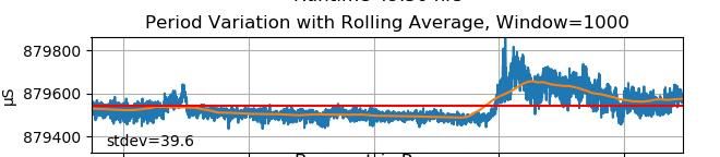

                #500982

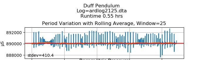

                  Today's graphs show the improvement made by moving the electromagnet further away from the bob. The bob isn't swinging ever more wildly and Standard Deviation has dropped from 637 to 39.4, much better. Might be some correlation between period and barometric pressure too, though 0.34 is far from convincing.
                  Not known what caused the odd bump at about tick 95750 (approx 12:45am) where the period suddenly increases. It doesn't correspond to temperature, pressure or humidity. Possibly a heavy lorry passing outside or a gust of wind got past the loose fitting garage door. Zooming in doesn't help:
                  Bugs detected: 450 records of 200,000 were deleted manually from the log because the relative humidity sensor occasionally returns NaN (not a number), which upsets loading data from the log file.
                  Improvements: better for the log file to record real time as well as tick times.
                  Next steps. Test code changes to log real time and fix humidity sensor misreads. Add code to measure Q. Upgrade the mechanics so the shield can be fitted, and an amplitude detector so impulses can be reduced further.

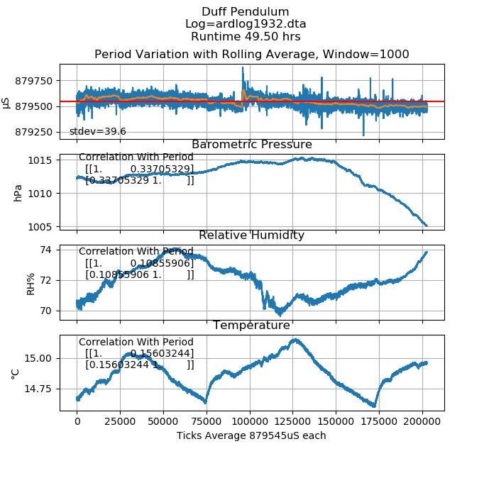

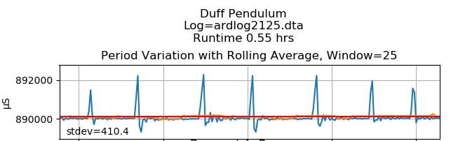

                            And as if by magic latent modes may well explain this graph, taken last night after reassembling the clock on my dining table to upload & test the software upgrade:
                            Just flung together to make the clock run with no attempt to level it or adjust the electromagnet. Had to replace the pendulum rod again due to clumsiness. Red line is the average and the orange line is the rolling average. Pendulum in blue, and not only are the spikes fairly regularly spaced, they trace a wave along the top. Zooming in on one of the humps confirms symmetry:
                            My guess is the electromagnet was twanging the pendulum rod and the bob was swinging elliptically. I was concentrating on the computer upgrade and didn't look, shame.
                            Clock in bits while I redesign the magnet holder. Could take a while because I can't run the 3D printer without tidying up first.

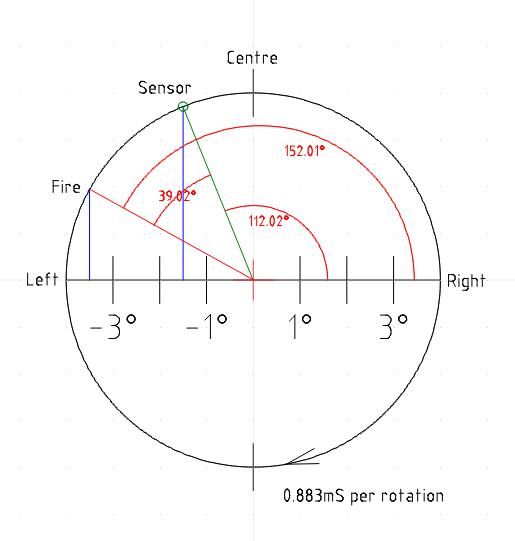

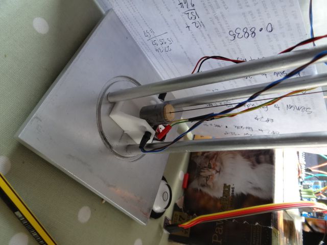

                              Latest report, I've not been idle. Mk2 upgrade now operational and been the target of much experimentation. Physically the clock has a new electromagnet holder, with the magnet fixed to one side and the wiring has been routed to allow the shield to be mounted, but not evacuated yet.
                              Software upgrades include a general tidy-up, auto start, determination of amplitude and a primitive amplitude regulator.
                              Experimentation focussed on when best to trigger the impulse. The idea was to minimise the amount of disturbance by minimally pulsing the magnet close to top of swing. Although the software allows me to impulse the bob at any time, working out exactly when is a little difficult. Thanks to Michael, Duncan and John I put this diagram together. (First attempt at this involved extrapolating a sine wave from the circle, but this is clumsy and unnecessary. Woodward's "My Own Right Time" describes the method in the chapter on Disturbed Harmonic Motion, which I read after painfully re-inventing the wheel. Woodward calls it a Phase Diagram.)
                              The time taken by the pendulum to move between any two points can be found. It takes about 0.883mS for the pendulum to swing from one side to the other in back, which is 360° around the circle. The horizontal line represents the distance travelled by the pendulum; mine swings about 4°. Could be graduated in millimetres. Anyway, my beam break sensor is mounted about 1.5° off swing centre. This corresponds to an angle of about 112° from extreme right so:
                              time from right to sensor = 112/360 * 0.883 = 0.27mS
                              So if I decide to fire the impulse when the pendulum is at -3.5°, the Phase Diagram shows this to be 39° past sensor, or 39/360 * 0.883 = 0.096mS. The analysis reveals a problem: the maximum pulse must fit into the time between 'fire' and 'left'. Fussy to set-up.
                              By analogy I expected the pendulum to behave like a child's swing. There would be a resonance. However, impulsing at various times between 'sensor' and 'left', failed to find a sweet spot. I believe the analogy is false: the amount of energy needed to overcome losses and keep the bob swinging is constant. Further, provided the bob is travelling towards the magnet, it doesn't matter when the impulse is applied. As theory suggests the bob should be impulsed when it's travelling at maximum speed (centre), it's best to pulse at sensor as soon as the beam is broken. Doing this also eliminates any need for complicated timing calculations.
                              Although the magnet holder could be modified to hold the beam breaker sensor at 'centre', I decided to leave it offset. This is based on another unproven notion, which is that changes in amplitude can be detected by comparing the time spent by the bob on each side of the sensor. I believe time spent left of my offset sensor decays faster than time spent right of it. So the mark space ratio can be used to detect if amplitude is increasing or decreasing, and used to regulate impulse strength. A high-amplitude pendulum is closer to 50:50 than this example:
                              Last night's test run is promising, and has spawned some new ideas. The clock is on the dining table in my south facing radiator about 1m away from the window and central heating radiator. Shield off.
                              Weakish correlations are detected between period and both humidity and temperature. There's a major disturbance just after 7am. My first thought was it's due to temperature resulting from my central heating firing up. However, as I've had bother with the beam breaker sensor, I think it's more likely to be daylight. The vertical blue and red lines show civil twilight and sunrise respectively. I suspect increasing light falling on the sensor alters the impulse trigger point.
                              My simple amplitude regulator is akin to the hit and miss device used on old single cylinder oil engines, and amplitude gradually decaying overnight shows it's not quite set right. A more linear algorithm would help, but I need to re-test with the shield in place first. Also, an IR level sensor should be added to log ambient brightness.
                              Edited By SillyOldDuffer on 19/10/2020 12:22:17

                                I assume your time units are seconds, not ms? To be pedantic, the "phase diagram" plots velocity vertically, the units being scaled so it is a circle, and normally rotation is taken to be anticlockwise.
                                You can measure amplitude using an offset sensor as you suggest – this link describes how but refers also to a copy of HSN where the method was first described. I do something slightly similar though my main reason for using an offset is so the Arduino "knows" which side the pendulum is.

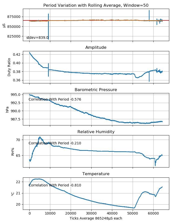

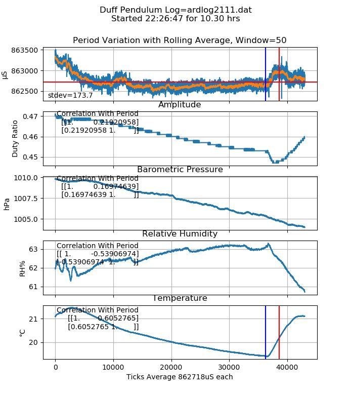

                                    More progress. Running the clock shielded eliminated nastiness caused by the rising sun, and improved amplitude control much reduces bob jitter. (The algorithm allows amplitude to settle naturally at whatever level requires least change: the bob isn't forced to maintain a particular amplitude.)
                                    Although the graphs show turbulence when the heating comes on and people crash about in the morning, the effect on period is much lower than when the IR sensor was being lit up by the sun too.
                                    Sunshine eliminated, there is detectable negative correlation between air pressure and period, and a much stronger negative correlation between temperature and period. Temperature correlation was a disappointment until I realised the link may be due to the Arduino's uncompensated crystal oscillator rather than the carbon fibre pendulum rod. Another point to be proved.

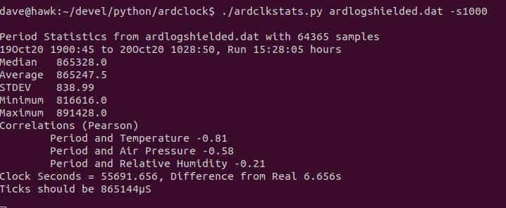

                                    Looking at the stats:
                                    The pendulum is 6.7 seconds fast over 15 hours compared with a DS3621 Real Time Clock, which claims ±2ppm accuracy over my test temperature range.
                                    The Arduino reports ticks averaging 865248µS, whereas to match the RTC they should be 865144µS. This error could be due to the uncalibrated Arduino. (Another proof required!)
                                    The spikes at tick 9000 and those after tick 58000 are due to me wobbling the dining table. The pendulum's sensitivity to vibration is a serious flaw.
                                    Now the clock is running reliably next job is to measure Q. At last. Bet it's low.

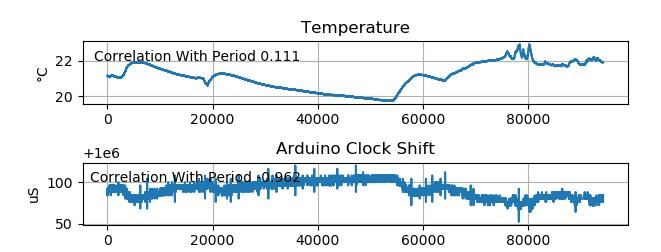

                                        Latest report. I measured Q. Between 80 and 140, which is dreadful! The implication is my carbon fibre pendulum is a spring, and not a good one either. As the problem is almost certainly the matrix rather than the fibre, I experimented with removing it. No luck with chemicals but a blowlamp does the job. Although carbon might be expected to catch fire, it glows white hot in a reducing flame and survives.
                                        The Mk3 clock will suspend the rod by clamping the fibres at one end, allowing the pendulum to swing on a short length of them. Fingers crossed, removing spring from the rod at the suspension point should improve Q.
                                        I was able to get a feel for the stability of the Arduino's clock relative to accurate seconds from a GPS module by using micros() to measure the time taken between the rising edges of GPS second pulses. One Arduino Nano measures the second as about 1001400 microseconds, the Nano in my pendulum clock is closer – it averages 1 second as 1000090.4 microseconds. Nanos are clocked by Ceramic Resonators, only about ±0.5% accurate and temperature sensitive.
                                        The rig makes it easy to test for correlation between frequency and temperature. The graphs clearly show the relationship with mirror image curves and the Pearson Correlation is -0.962, where 1 is identical.
                                        Would be a result except there's no correlation between Period and Temperature!
                                        Also been looking into Allan Deviation and Variation. Thick fog ahead!

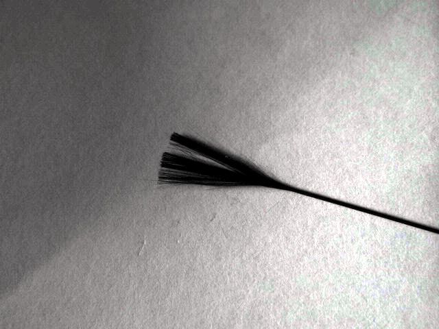

                                              According to bob shape best shape for a bob is like a pointed rugby ball. Difficult to keep the point going in the direction of swing with SOD's rod, next best is spherical. Dense is good, so tungsten or copper/tungsten alloy, which is machine-able. According to wikipedia tungsten is magnetic, not sure about the alloy
                                              I suggest the best approach to the stranded rod is to cut away a lot of the fibres then splay the remainder out like a ribbon. This will prevent fibres rubbing on each other and dissipating energy, I think a well known French clock (Bulle?) had a silk ribbon suspension
