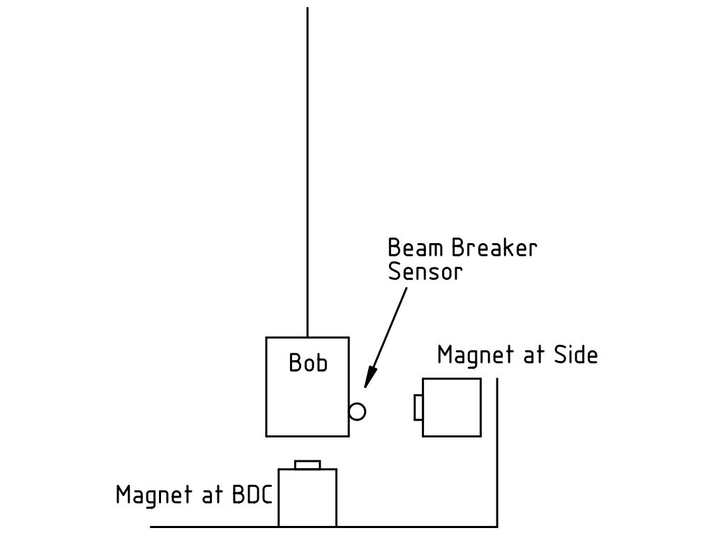

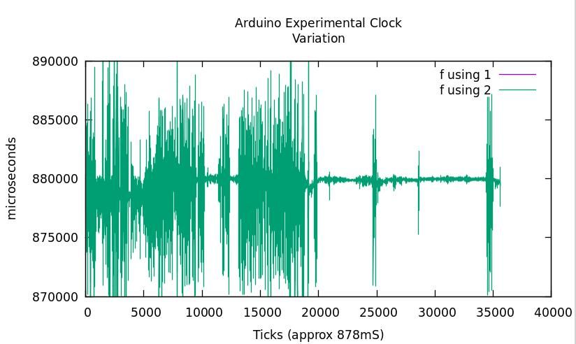

      Moved electromagnet last night from directly under the bob (bottom dead centre) to pull it sideways instead:
      Positioning the electromagnet at BDC minimises any disturbance of the bob when impulse is applied because the bob is travelling at maximum velocity at that point. Sadly my design makes the timing and strength of the impulse critical; why is still under investigation.
      Got frustrated last night and moved the electromagnet back to the side position, and got it running in a few minutes. This morning wouldn't run at all. Causes: solar energy on the sensor, even though it's wrapped in silver foil, and the magnet base had moved about 2mm overnight. My suspicion BluTack is a rotten adhesive confirmed!

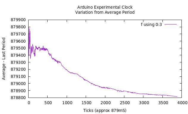

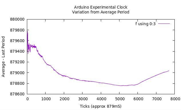

      Anyway, got it going reliably and was able to log how well the pendulum performs over time.
      The period of each full swing (in microseconds) is compared with a running average.
      When the clock is first started, the pendulum bounces badly for about 3 minutes and then gradually settles down with each swing gradually getting closer to the average. Promising. Or is it?
      With a longer sample deviation from average is rising again. Could it be temperature or air pressure? Not convinced: I'll add a sensor to see if either curve matches, but I think the effect is too big.
      The comparison may be dodgy – statistics aren't my strong suit.
      Time for a brisk walk and think in the fresh air.

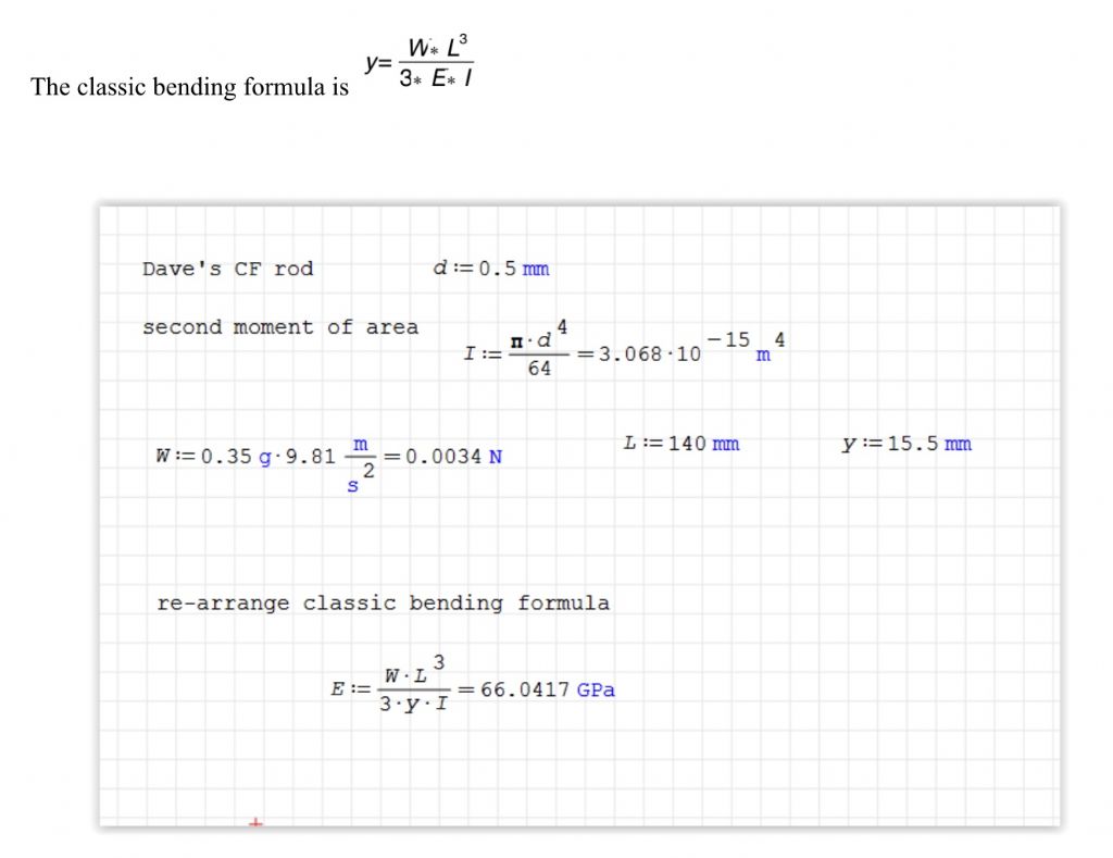

        Posted by SillyOldDuffer on 04/10/2020 19:14:35:
        It's deflection characteristic is:
        This data enables the springiness of the rod to be calculated.
        This **LINK** appears to be an excellent description of the calculation process
        https://youtu.be/QNQ5qzXII58 : Cantilever Depression – Young's modulus determination
        But, I am embarrassed to admit that his accent and speed of delivery make it difficult for me to follow.
        … Can anyone suggest an alternative, please ?
        … I feel the need to understand this better

          Surely the best way is to fix a known mass at the end of a known length, suspend it vertically, measure the period of oscillation, and back-calculate the YM using Duncan's formula?
          #500038
            Posted by John Haine on 07/10/2020 10:41:20:
            Perhaps it is, John
            But I am trying to understand Dave’s experimental results

                  The effect of stiffness is very small even for Dave's lightweight pendulum bob, so John's suggestion is open to lots of uncertainty. Dave's experiment gives a value of 66GPa for Young's modulus in CF, which is lower than I'd expect. One supplier quotes 28-40MPa which is very low indeed (and I think must be wrong), another quotes 181GPa for a 70%fibre/30%resin mix. This is much more what I'd expect. Steel is 207GPa for comparison
                  Small variation in diameter will have large effect on rod stiffness, it goes as the fourth power
                  I can't work out how to attach a png to this, so I'll sent some sums to Michael via email, if he can work out how to make it public that's fine. I couldn't understand Michael's link either, is he speaking English?

                    Easy Composites got back to me. Their figure of 28-40MPa should be GPA, much more sensible, but egg on face all round at EC I should think

                      This appears to cover it nicely: **LINK**
                      https://www.doitpoms.ac.uk/tlplib/thermal-expansion/expt1.php
                      … despite the reference to thermal-expansion dont know
                      Derivation of the formula is linked from that page.
                      and second moments of area for various shapes are listed here:
                      https://en.wikipedia.org/wiki/List_of_second_moments_of_area
                      Edited By Michael Gilligan on 07/10/2020 17:43:25

                        and, with thanks to Duncan:

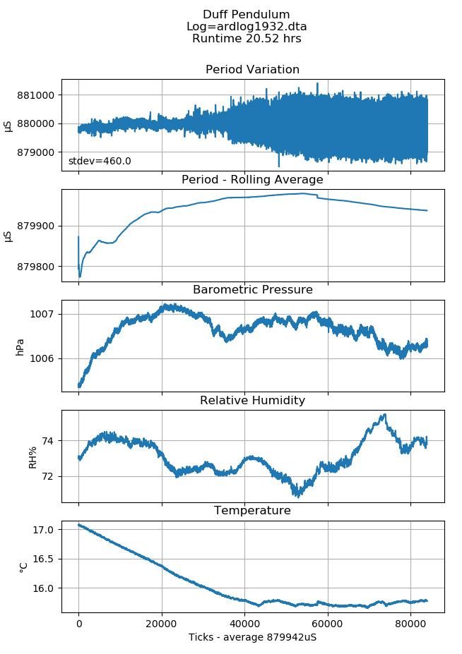

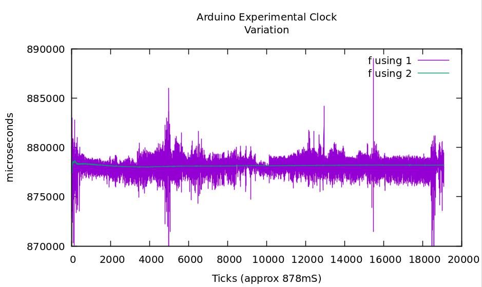

                          Out today, but was able to leave the clock running unattended while logging.
                          Yesterday, tested logging while typing on the same table. The graph of tick periods shows serious wobbling:
                          My pendulum is exceptionally sensitive to vibration, probably because the rod is unconstrained. Easy to tell from the graph when I wasn't at the table. Don't know what caused the spike while I was out for a walk; I blame the cat.
                          Left it running undisturbed again whilst I was out today:
                          Far fewer big deviations, but the magnified scale shows wobble between swings of about ±250uS. (Eyeball guess, number crunched stats when I get home tomorrow.) Not good.
                          I added a BME280 pressure/temperature/humidity detector and arranged the Arduino to log to a RaspberryPi 3b rather than a PC. A compact low-power setup means I can leave the clock on test for months if necessary. Log files can easily be copied off the Pi at any time because it's wifi networked.
                          Next steps, measure Q, 3d print the redesigned magnet holder, and reduce the impulse to see if bob wobble can be reduced. Then back to the electromagnet under the bob.
                          Philosophical question. Although the period of each swing varies wildly, the inaccuracies appear to average out. If I accurately determine the pendulum's average period over several days, and then use average period to drive the mathematical gear train to get HH:MMS, can I claim the clock is accurate? Even in it's rough state, could be OK within 0.5mS. (Assuming I get Bressenham or Duncan's interpolation method to interpolate properly.)

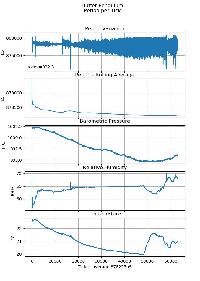

                                The following graphs are experimental but I think they both support John's statement that the error won't average out. The rolling average changes.
                                First graph set is of an overnight run, on dining table, started mid-afternoon, and finished at breakfast. The Arduino logs period, temperature, relative humidity, barometric pressure and calculates the period's running average.
                                During the night the pendulum grew wilder. Average period over the run was 878225µS.
                                The spikes in temperature and humidity and disturbed pendulum at about 16000 ticks coincide with cooking the evening meal. Lots of crashing in the adjacent kitchen.
                                Temperature drops overnight, and rises suddenly at about 48000 ticks when the central heating fired up. It's timed to stay on for two hours, after that the workers depart and I put on a jumper. Presumably humidity responds to the central heating. Condensation aficionados will note the burst of warmth caused humidity to rise, which will deposit water onto any handy cold surfaces.
                                There's a hint the rolling average period may be following barometric pressure. Unconvincing.
                                The gradually worsening turbulence starting at about 18000 ticks is the most obvious defect. My guess is it's due to the pendulum being over-impulsed.

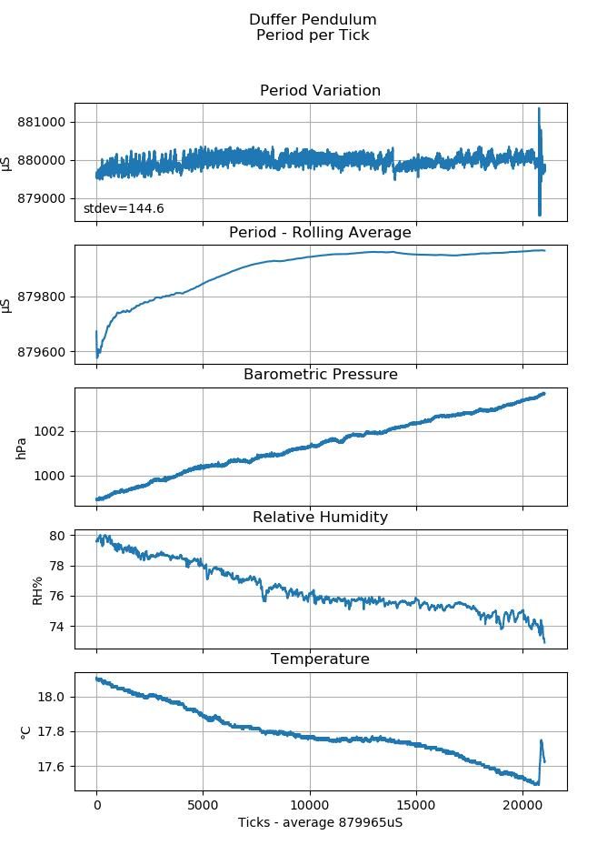

                                Back home after today's outing, I moved the pendulum, Arduino, and Raspberry onto my garage workbench. Much sturdier than my dining table, no sunlight, cat-proof, and I kept my distance. Result after first 5 hours:
                                Points of interest:
                                • The average period changed! 878225µS up to 879965µS (about 1.4mS)
                                • Rolling average in the first graph-set falls, while that in the second rises. (I think a much longer run is needed.)
                                • Standard Deviation is much better in the garage: 144.6 vs 922.3 in the house.
                                The bounce at the end (22000 ticks) is due to me disturbing the clock whilst reinserting the Wifi Dongle; the signal isn't too good in the garage.

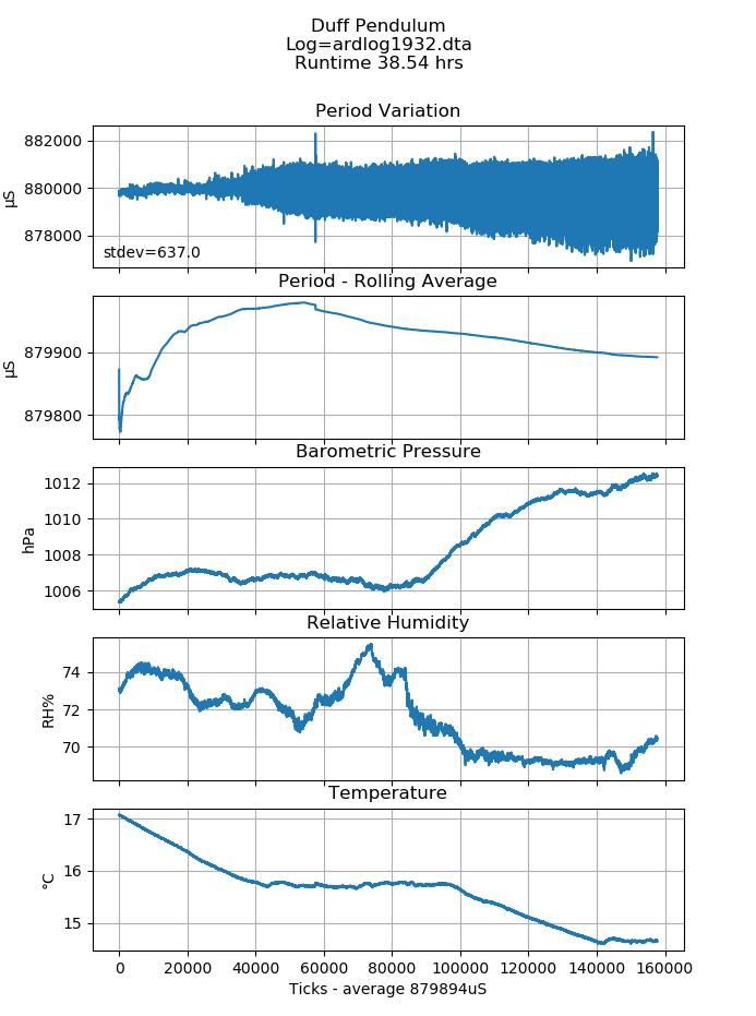

                                    Agreed, and also not sensitive to temperature and humidity. I've added correlations to the data analysis and whatever my pendulum is reacting too, it's not the obvious. (I think the matrices below mean almost no correlation between period and the sensor data.
                                    Latest graphs:
                                    The glitch at 57511 ticks in the rolling average was due to me entering the garage, turning the light on, and finding a screwdriver.
                                    Statistics:
                                    Period Statistics from ardlog1932.dta with 83957 samples
                                    Median 879952.0
                                    Average 879941.7
                                    STDEV 459.97
                                    Minimum 878484.0
                                    Maximum 881400.0
                                    Correlations (Pearson)
                                    Period and Temperature
                                    [[1. 0.00202627]
                                    [0.00202627 1. ]]
                                    Period and Air Pressure
                                    [[1. 0.10235348]
                                    [0.10235348 1. ]]
                                    Period and Relative Humidity
                                    [[ 1. -0.08289992]
                                    [-0.08289992 1. ]]
                                    Again the outstanding feature is the pendulum running wild, I assume because it's getting closer to the electromagnet. I'll experiment tomorrow with reducing the impulse, but an amplitude sensor is probably needed.
                                    Misleading the public is always an option. In this version of the graphs, Rolling Average is on the same scale as Variation. Now the data looks much better!
                                    Have I invented a wonderful new clock? The evidence suggests I'm on a sticky wicket unless I can stop the bob going mad. It's sensitive to light and vibration and I still haven't measured 'Q', which is expected to be low. Apart from that, it's marvellous!
                                    One good thing; carbon fibre is standing up well as a rod material.
                                    What I'd like to achieve is a much more stable pendulum where period does correlate to atmospheric pressure. Still lot's to do.
