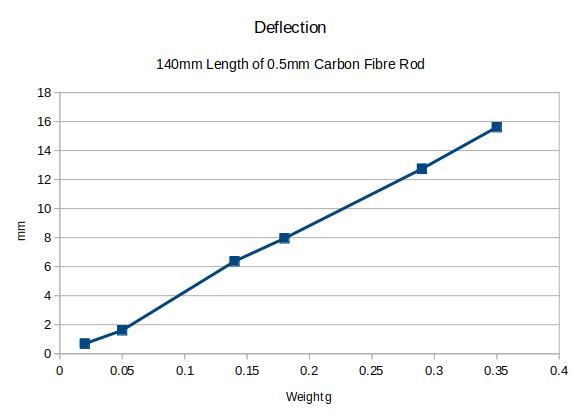

                                      Update: clock feeling better – fixed a bug in the software cause by the last bug fix, blush, and fitted the correct pendulum mount, rather than the next size up.
                                      Duncan's formula for calculating timing is working except I assumed the bob would break the beam halfway across, in practice it triggers sooner, so I'm still guessing about the exact timing point. 40mS isn't quite right, but the clock runs.
                                      The 0.5mm diameter rod I'm using came from Easy Composites Ltd, and is described as pultruded matrix carbon fibre rod.
                                      It's deflection characteristic is:
                                      This data enables the springiness of the rod to be calculated.

                                        For the benefit of those descended from ‘rivet counters’, Dave … do you happen to know what matrix resin is used, and what proportion of carbon is in there ?
                                        Edit: Just found the supplier:
                                        https://www.easycomposites.co.uk/1mm-carbon-fibre-rod
                                        … all looks very impressive.

                                            #499617
                                              @Duncan
                                              If you have a moment, could you please do a comparison of those two specifications ^^^
                                              … My little Imperial brain is struggling with the units and the mixed terminology blush

                                              duncan webster 1
                                                @duncanwebster1
                                                I strongly suspect that this is into angels dancing on pins territory, but according to my ruminations the frequency of a pendulum with springiness is
                                                f = 1/(2*pi) * sqrt ( g/L + k/M)
                                                where g = 9.81 m/sec^2, L is length in metres, k is stiffness in Newtons/metre, M is mass in kg.
                                                In the unlikely event of anyone wanting a copy of the sum. send me a pm with your email address.

                                                  But for this pendulum where the rod stiffness is that of a bending beam, k isn't the YM of the material but has to be computed from the YM and the dimensions?
                                                  #499664
                                                  duncan webster 1
                                                    @duncanwebster1
                                                    k is the stiffness of the actual rod, which SOD has measured, but as you say if the dimensions and Young's Modulus are known you could work it out.
                                                    I'll make a legible copy and send it to you
