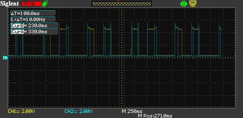

            Frustration galore.

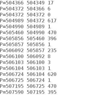

            Something strange going on with my code, swings should take about 800mS, but every so often I get an odd reading. Checking with an oscilloscope shows pulses are being detected correctly (except see below!), it's as if millis() and micros() are seizing up. Bit odd, I've written similar code many times before without any bother. May have been overconfident and slapdash!
            Ignoring software issues, I connected the magnet and found the transistor didn't work. Turned out to be connected back to front because a P2N2222A has a different lead-out to the PN2222A. I looked up the wrong one and connected cbe instead of emitter-base-collector. Still no joy, until I noticed the coil was connected to ground instead of +5v. Fixing that I got the magnet diodes the wrong way round. Air turned blue.
            Now the magnet is pulsing, but as I've made no attempt to get the impulse timing right it can't possibly work. To my surprise the clock started while I was thinking about how to fix it. Yer wot?
            Celebrations were premature. Looking at the Arduino report showed measured pendulum period to be all over the place (last column) in milliseconds:
            All lies, but the oscilloscope confirmed bad behaviour:
            Yellow trace is pendulum swings detected by the beam breaker. Blue trace is the impulse. Yellow shows 'tick tick pause tick tick' – wrong. Blue shows the impulse mostly fires correctly when the beam is broken but sometimes on the falling edge too, which is wrong. Also the blue pulses should all be the same width and they aren't. Hmmm.
            Turns out the clock started due to bright sunshine on the bob. The extra shadows and reflections accidentally produced extra impulses at just the right time to swing the pendulum. Able to prove it by drawing and undrawing a curtain. Fairly sure the 'tick tick pause tick tick' effect is due to my genuine but incorrectly timed impulses braking the bob rather than letting the sun do all the work! Clock doesn't run now the sun has moved round.
            Ho hum,

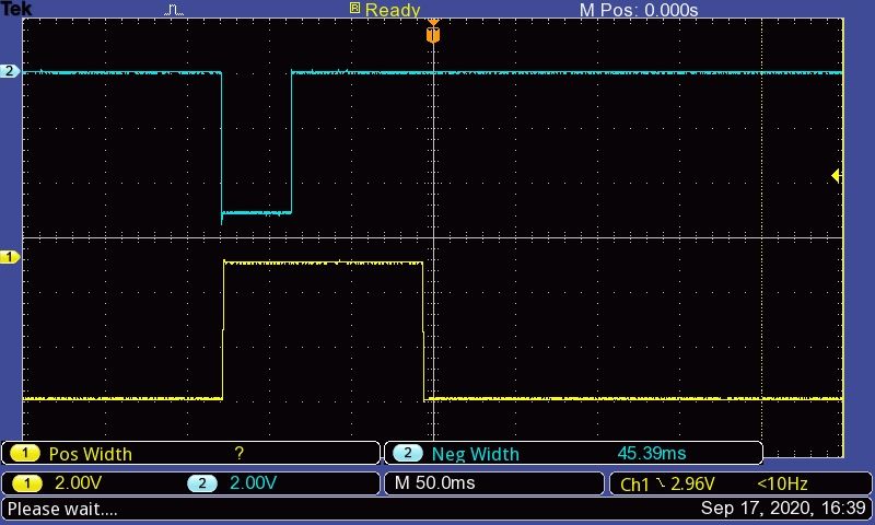

              Not sure I dare try and do timings on my pendulum Dave!

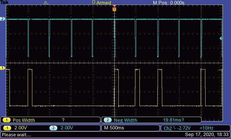

              Seeing your pics I couldnt resist looking at what mine looks like.
              This one has the output from the sensor which is triggering the Arduino on theblue top line with the yellow energising coil on the bottom. The input pulse is quite long as the pendulum is jus swinging a small amout and gaining speed. The output pulse length is the yellow line and the energising coil is driven directly by the arduino.
              The swing has increased and the pulse length has reduced to 21ms, the energising pulse is also reducing with less power being given to the pendulum.
              Finally its got up to speed and the energising pulse is being switched off as the input goes under 21ms, the pendulum slows slightly input length increases and its energising again. Tried fiddling with the energising strength but with my high friction clock train it didnt make much difference.
              Peter

                Good stuff Peter, you're well ahead of me at the moment. I like the missing impulse technology!
                Can I encourage you to cursor your pendulum pulses? Measuring their consistency, or lack of, might be food for thought. My early Clock Analyser tests showed that my lash-up pendulum's period was subject to small variations that mostly cancelled out over time. Be interesting if your clock has the same characteristic.
                I'm making slow progress with software, constant distractions, but I'm also attempting something a little advanced. It's a fire and forget single pulse function that doesn't stop other processing by waiting for delay(). Pseudo code:
                if ( pendulumDetected ) sendImpulse( xMilliSecondsLong, afterWaitingyMilliSeconds );
                afterWait allows impulses to be applied to the pendulum anywhere during it's swing, so the mechanical position of the electromagnet and beam break detector aren't critical. xLong allows the strength the impulse to be controlled from zero up, hopefully allowing a later version of the code to maintain the clock with minimum energy.
                Bit like a car engine management unit using knock detection to dynamically optimise when the spark is applied.
                Another age thing I'm sure. Used to write software in noisy open plan offices and was able to concentrate whatever the racket. Now almost anything puts me off. Need to unhook the phone, lock the cat out and put 'Do Not Disturb' on the door. And now it's lunchtime…

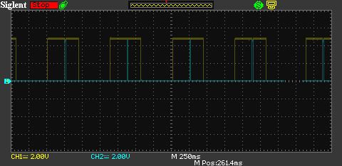

                      When a tick is detected due to the beam being interrupted, waits 240mS for the bob to approach the electromagnet and then emits a 15mS impulse. magnet is an object of class pulser, which contains the code needed to manage delayed pulses. Calls for new pulses are ignored until the active pulse finishes.
                      Waveforms. Bob detect in yellow, and delayed magnet impulses in blue:
                      Impulses are much shorter than pendulum period in hope of reducing bob disturbance. Watching the bob swing for 10 minutes shows 15mS impulses are too powerful because the magnet visibly gains energy. The impulse time delay is a rough guess. Testing temporarily with the Mk1 dual electromagnet holder which due to a design error doesn't allow a magnet to be positioned BDC, so the impulse attracts at the end of each swing, effectively reducing gravity. Slightly sensitive to bright sunshine, and very sensitive to bumping the table.
                      Going to leave the bob swinging with 10mS impulses. While it runs, off to make an end-cap and connector to see how much vacuum I can apply to a foot of Mr Marley's Best 68mm PVC Drain Pipe. Will it collapse? Will the joints leak. How do I make a reliable vacuum valve. Failure beckons…

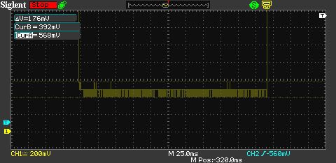

                        Leaving the bob swinging didn't go well so whilst waiting for super-glue to set I investigated why the Arduino was intermittently measuring half bob times and impulsing on FALLING edges when told to register only on RISING edges. Suspecting a faulty Arduino, I connected it to a Function Generator and it worked perfectly, RISING, FALLING and CHANGE.
                        Although the waveform coming out of the Infra-red proximity module looks OK, it's not. Zooming in shows zero to be a small positive voltage anywhere between 320mV and 730mV. And it's noisy too, this sample showing 176mV of noise between the floor at 392mV and spikes up to 568mV:
                        The dirty signal causes the Arduino to trigger incorrectly. Adding a diode helps, but the beam break electronics need a rethink.
                        The proximity detector module is normally connected to an analogue input, and a pot adjusted to set the range. Connected to an analogue input, the sensor's zero being above zero and a bit noisy doesn't matter. But it does when connected to a digital pin. Me assuming the sensor output signal is between ground and 5V was a mistake… Wasted most of the morning on this.

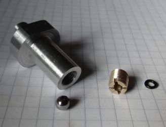

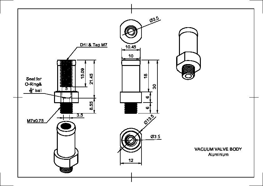

                              Slow progress due to constant interruptions today, but I've made end-plates for 250mm of 68mm PVC drainpipe and am about to make a vacuum valve.
                              Completely out of my depth with the design, so I hoping a ball-bearing and o-ring will hold the seal until the valve entry is blocked by a bolt & pipe thread sealant.
                              I have an untested low pressure vacuum pump and a length of 10mm i/d heavy rubber hose. The valve design, inspired by LBSC boilers:
                              Not shown, an internal screw-in sleeve to stop the ball-bearing coming out, or the bolt used to close the valve after the hose is removed. Ideally the assembly will take close to a full vacuum without collapsing and hold it for several years. (Fat chance, but it keeps me amused.)
                              Idea rejected: valve made of 30mm of silicone rubber sleeving arranged such that air pressure crushes it flat and forms a seal. Not convinced it will crush flat! Also, the seal would progressively weaken as vacuum was lost, whereas I hope leaks through the ball bearing and bolt will slow down as the pressure equalises.
                              Occurred to me too late the pressure test could have been modelled with Fusion360 quicker than I can make one! My spin doctor advises to tell you all it was built for real in order to test the valve and the vacuum pump. Yeah, right! I hope everyone has forgotten I'm supposed to be measuring Q, not playing with pumps. There is a bit of logic behind the diversions: the design needs to be revised, but I'm taking the opportunity to squeeze more info out of the experience.
                              PS Sorry about the heavy handed drawing. Caused by converting PDF to JPG for the Album. The original is fine.

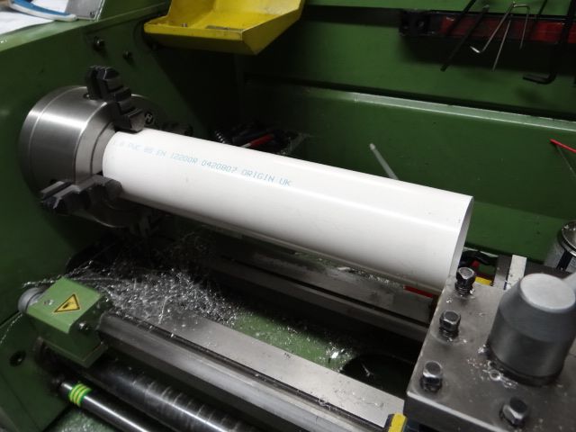

                                Back to the clock! My vacuum pump is working well enough to proceed. Pumping out the clock shield doesn't cause it to collapse, or even to bend noticeably, which fits in with Fusion360's FEA which said my drain pipe concoction has a 15X safety factor.
                                Despite the awful noise the pump makes I could hear shield hissing due to leaks. Looking at the ends of the pipe showed my band-saw hadn't done a marvellous job; cut not quite square, visible tooth-marks, and a bump where the pipe separated.
                                The obvious way to square and polish it off was in the lathe:
                                One end is poorly supported by the chuck and the other is in mid-air. All the red lights are flashing. Worth a try with soft plastic and a sharp cutter, I thought. Silly me. It's a Widow Maker! One touch with the cutter and the pipe ejected violently, nearly jambing between the jaws and the bed before bouncing off and landing on my foot. A metal pipe could do a lot of damage.
                                Still trying to think of a quick simple way of supporting the pipe, but I tied the ends up with a set-square, file, and sand-paper. Considerable improvement: with the pump running I was unable to pull the end-cap off bull-worker style The area of the end-cap is about 6 square inches, so I guess the vacuum was at least 10psi below atmospheric (ie about 60lbs holding the cap on.)
                                Next step, my vacuum valve:
                                Nothing special, the ball bearing keeps the valve sealed under atmospheric pressure and the brass thingy stops the ball bearing from coming out. After a sharp tap with a hammer seals fairly well, but the O-ring makes leaks worse. I think this is because the O-ring should squidge into a squared corner, whereas mine sits in a cone. Any o-ring experts out there?
                                At the moment the vacuum holds for only about 8 seconds after the pump is switched off, which is poor. The leaks need more attention. The pipe ends need polishing. Maybe thread sealant?

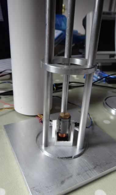

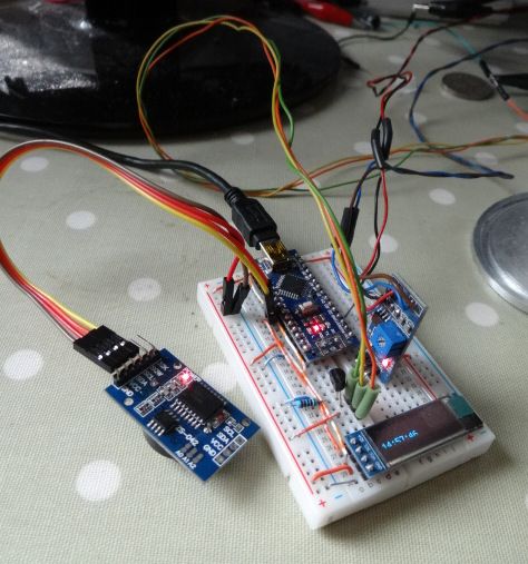

                                Meanwhile the electronics and software have been improved by adding a display and a Real Time Clock module. The RTC is a diagnostic aid – it lets me compare pendulum time with an accurate clock for debugging purposes.
                                For example, the RTC confirms the clock runs for about 75 minutes before the pendulum becomes unstable, and also that pendulum seconds and real seconds are similar. Tuning the impulse has the clock running on 2mS pulses. The timing isn't quite correct, so smaller pulses should be possible. At the moment the pendulum gradually builds momentum until it bumps a pillar and crashes. (Design intent is a swing under 5°!)  Not difficult to tweak the code to make pulses with microsecond resolution.
                                A second fault is due to the electromagnet being glued in off centre. If the pendulum doesn't get a clean start, it takes a diagonal course, which tends to go elliptical, and eventually the bob bumps into a side cheek and crashes. The thin carbon fibre rod does nothing to stop this. I'll upgrade the 3D printed magnet holder by adding a couple of locating rails so the magnet has to sit straight. As can be seen below there are only a few millimetres clearance between bob and cheeks. As the beam breaker is vulnerable to sunlight might be worth printing the holder in black plastic.
                                Another embarrassment: there's no way of leading the wires outside the shield. The shield can't be put on the base, let alone pumped out.

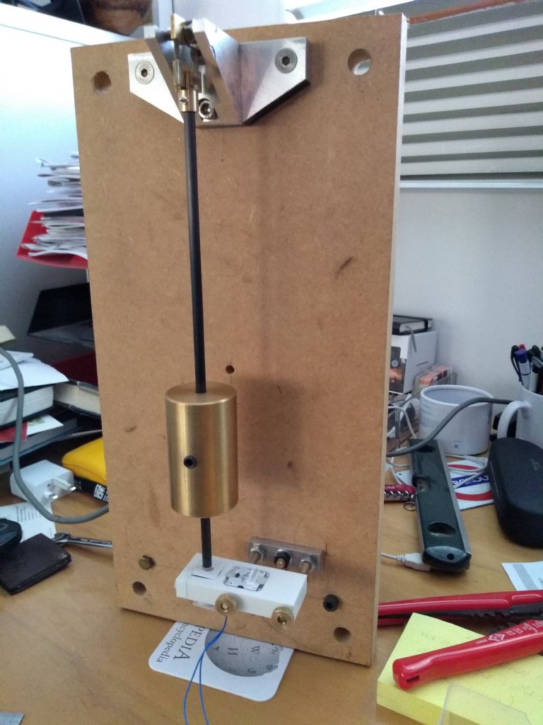

                                  Dave, progress! Have you measured the diameters of the CF rod in two orthogonal axes? If it is not perfectly circular I think it will tend to swing elliptically anyway.
                                  This is my current clock project transferred to my study to connect up the Arduino. There's a neodymium bar magnet jammed in the end of the rod, sensed by the coil just below. To the right is a Hall sensor for amplitude control. Backboard is MDF salvaged from beneath the bench. It's bolted to my largest angle plate weighed down with three bits of 4x4x1" BMS. Wikipedia beer mat is for levelling
                                  Bob currently too high – target is for period to be very slightly less than one second.
