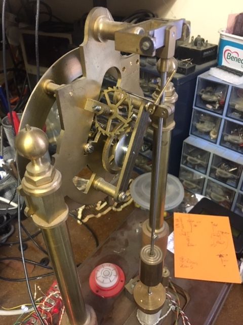

      Really interesting to follow this thread. I made the John Wilding "Simple Electric Clock" in 1987 and soon found it to be very unreliable. It works on the Hipp principle and the contacts were forever going out of adjustment and needing cleaning. Adding some transistors to help the switching didnt help so it was forgotten for years.
      Eventually replaced the Hipp arrangement with two magnetic sensors (optical sensors soon failed with dust?)and 555 timers to control the pulse and it worked but soon found that the soft iron core of the magnet was magnetising the swinging armature and eventually becoming unreliable and stopping, abandoned again!

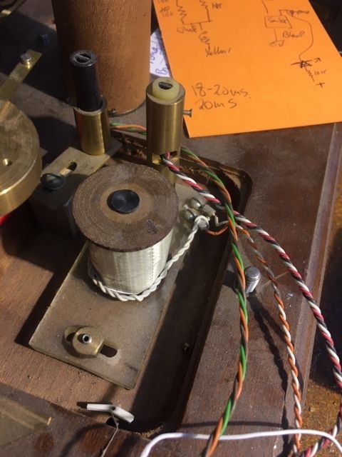

      Fast forward a few more years and I made an energising coil without an iron core (fine wire 2K ohms) and replaced the swinging armature with a 6mm neodymium disc magnet so that there was no interaction when swinging and unenergised..On the 555 it worked but was complicated. Discovered Picaxe micros and got a version working after learning some programming. Eventually moved onto Arduino and the latest version measures the pulse width with a magnetic sensor and stops energising the coil when a predetermined pulse width is reached. When its being energised by the Arduino the armature with magnet is pushed away.
      Been going a few months now and think its the best I've managed to get it running. The pundulum is on knife edges and quite a bit of friction in the train which I've reduced. but could be improved on.
      Not in the precision league I'm afraid that Dave's trying for but I'm pleased with the progress!
      Peter

                My high friction clock is impulsed for 80ms but will run with a pulse width of 40ms. The magnetic sensor looks for a pulse length of 20ms before switching off and it can only manage a couple of swings before its re-energized .
                If I switch off completely it takes 10 secs before it stops incrementing the count wheel and approx 60 secs before the pendulum is stationary. It takes a tiny push to get it going and around 30 secs to build up sufficiently before it is up to full swing and limiting.
                Its quite nice to stop the clock and see it build up again with the led in series with the coil flashing then stop and bounce on/off when its limiting!
                I have another more conventional experimental pendulum running on a similar impulse system but pre arduino which uses a pulse on time of around 5ms but its not driving anything.
                Peter

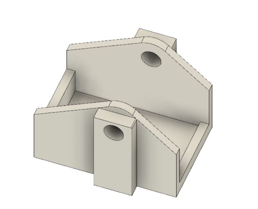

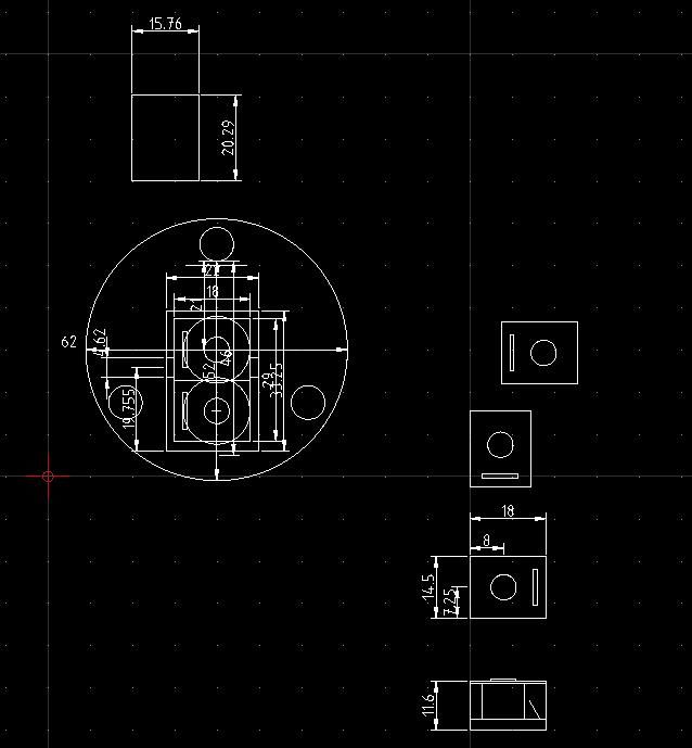

                      Bit of progress.
                      I used Qcad to layout a plan of the clock base using the dimensions of the bob and magnets etc. I find it easier to do this sort of work in 2D.
                      Having established the fit in 2D, I moved to Fusion 360 and designed a box to hold two electromagnets with cheek pieces to hold the IR LED and detector.
                      The idea is to use one magnet at the side to start the pendulum swinging from rest, and the other underneath to impulse the bob. One end-wall is lowered so the 'start' magnet rests on it and tilts towards the bob. This late change bit back.
                      Exported the F360 design as STL and printed it via gcode with my Creality Ender 3D printer. Shown below with magnets glued in and the infra-red components plugged into the cheeks.

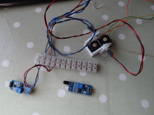

                      Below right under the terminal strip is an unmodified Arduino IR Proximity detector module. Normally the clear LED emits a beam that bounces back off obstacles and is detected to stop a robot hitting something. The module contains a comparator chip and sensitivity adjustment pot. Rather than design and build my own circuit, I modified a module simply by extending the LED and detector on wires.
                      Fans of duffer cock-ups will note the terminal strip swaps the connectioms over. Despite making notes and marking the LEDs to make sure they were reconnected the right way round, I soldered them back onto the module the wrong way. Ho hum.
                      Here it is connected and assembled for first fitting. Nothing is fixed down yet.
                      Although it looks reasonable, it's a very tight fit. I failed to allow space for the IR beam wiring. Worse, because the electromagnets are rectangular and asymmetric, the bob was pulled off centre. Rearranging the magnets fore and aft to correct that means the poles can't quite be positioned correctly under the bob. Might work but it's way off design.
                      I'll probably go back to a single electromagnet to test the pendulum while rethinking the dual coil idea.
                      Edited By SillyOldDuffer on 14/09/2020 20:26:54

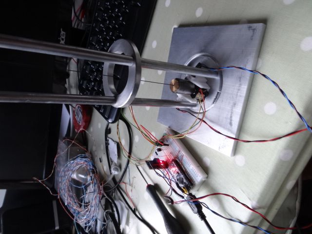

                        I have had a test rig sitting on my bench for a while. It is a half-second pendulum suspended on a carbon fibre rod, and has a samarium-cobalt magnet attached under the pendulum. It originated with a series in ME by Dick Stephen. I built the rig because here were problems with the timing circuit and I thought I could do the job another way, using a microprocessor. There is a flat coil (no centre iron) which acts both as detector and as impulser (at least that's he theory). The original used two concentric coils, one for sense and the other for impulse, but I think more than one coil is unnecessary.
                        The pendulum will auto-start if timed pulses are applied to the coil.
                        The problem is that because the magnetic field is doughnut-shaped, the pendulum will tend to move in a slightly circular or elliptical path. Restraining the pendulum will mean frictional forces probably at the sides of the ball bearing at the top of the pendulum shaft. I am uncertain whether the fore-and-aft tendency is a result of the magnetic field, or simply created by minor random sideways forces – despite careful leveling of the rig, a rigid bench, and a concrete floor.
                        One of the problems with this kind of system, as Dick Stephen found, is that regular pulses tend to produce over-swinging, taking the pendulum far from any intended isochronous arc. Yes; we are trying to create a stable oscillator, but it must be resonant at the pendulum's natural frequency.
                        I don't think that a plan to apply regular pulses to the pendulum is necessarily a good way to ensure the pendulum swings at its own natural (resonant) frequency, and my plan is to use a statistical approach to try to identify what that frequency is, then try to maintain it. That means the adjustment of the frequency of swing will be by altering the effective length of the pendulum, which is what you would do on a mechanical clock, rather than attempting to drive the pendulum at a particular frequency to force it to time.
                        This is not a particularly urgent project. It has been maturing on the far end of the bench since 2007, and gets attention as the muse comes upon me.
                        It will be interesting to see your own results.

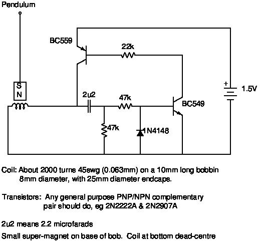

                                                  As an aside if anyone fancies swinging with a transistor circuit, this is what I used. Not sure were it came from.
                                                  Couldn't get an NE555 based circuit to work, at the time didn't have a scope. The transistors 'just worked'.
