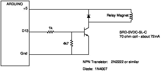

                                          Inching towards impulsing the bob. This is the relay driver circuit:
                                          D13 is the pin connected to the built-in LED on the Arduino Board. Might see it flash!
                                          Not had time to take in the other comments yet. Joe's soft magnet idea is interesting except I'm aiming to swing the pendulum by only 3° or so and the bob will never be far away. Still going to try it; the code is easy enough, but I think being on risks the magnet acting as a brake.
                                          To self-start the clock I'm going to send powerful pulses at to match the pendulums period. When the bob is moving enough to break the beam, the code will switch to maintain mode in which much shorter and carefully timed pulses will be triggered optically.
                                          Duncan's comments are reassuring. I'm worried I've accidentally built a phase-locked loop!
                                          Breadboard the driver and write some code next.

                                                    Dave, going back to your relay drive circuit, I don't know what pulse length you are aiming at but the configuration you have with the flywheel diode will lengthen the pulses because the current that was flowing through the transistor will flow through the diode when the it switches off, and decay exponentially depending on the inductance. This could be solved by adding a resistor in series with the diode, chosen so that the inductive kick plus the supply voltage remains within the max Vce rating of the 2n2222 (30V I think), and/or removing the iron core (advisable anyway to prevent remanent magnetism from perturbing the pendulum). Could also replace the 2n2222 with a MOSFET with a significantly higher max voltage.
                                                    #494838
                                                      Posted by John Haine on 09/09/2020 10:14:07:
                                                      Noted thanks. I've not noticed any residual magnetism in the relay core, but a Hall Effect device might show otherwise. I'm not too worried about the pulse length yet because the plan is to experiment: the pulse length will be slightly bigger than the minimum needed to keep the clock going, and it may not be applied to every swing. This morning's test showed more experiment to be necessary because last night the pendulum started reliably after twelve pulses, now it doesn't. I suspect it's because the magnet is temporarily mounted on a blob of blue tack and moved while I snored!
                                                      Main reasons for the 2N2222 is I got some and they're cheap. Max ratings up to about 40V and 800mA, well within the coil which is 5V at 70mA. My oscilloscope shows the diode managing the inductive spike; overshoot under a volt, negative rather less.
                                                      Does seem there are endless opportunities for minor improvements. At this stage I'm after the big things; can I make it work, then what causes the worst errors one at a time. For example, I took on board your suggestion that a tube is stronger than a tripod by adding a reinforcing ring to the design. Not proven yet that's good enough, though adding it noticeably stiffened the tripod – a good thing. Like as not there will be a Mark 2 design to address a shower of shortcomings.
                                                      I'm keen to get the clock starting and running reliably. Several suggestions and comments to check against the prototype once it goes. Out today unfortunately.
                                                      Ta,
