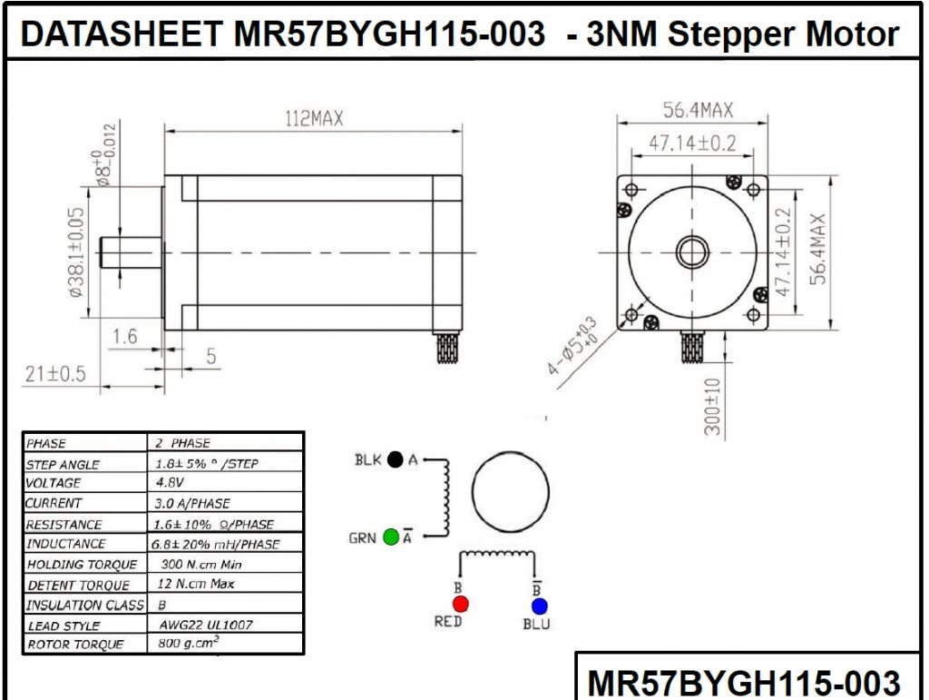

                I used a double stack nema 23 motor.
                What stall torque rating was that please, Joe ?
                "Nema 23" & "double stack" just give the physical dimensions of the motor & rated current is no indication of the motor performance either – I have Nema 23 motors rated at 2.2Nm stall that are longer & take more current than anothers rated at 3Nm. I have seen yet others rated 4Nm with the same physical dimensions as the 3Nm motor & with the same current rating. I would be interested to know the stall torque rating of the motor you used.
                Servo motors are usually specified by their torque rating, yet this rarely seems to be mentioned in relation to stepper motors, where only the frame size gets mentioned despite there being options for a range of torque outputs within the frame size ?
                Nigel B.

                    I've made an ELS to Joe's design and can confirm it is a wondrous beast! However could someone clarify a couple of points on which I'm confused
                    Joe tells us that a double stack Nema 23 is better than a Nema 34 because it has lower inertia, but also says fitting a flywheel helps.
                    With an ELS the stepper has to accelerate very quickly, but with a hobber can't it take longer to get itself in synch? Having to wait say 5 seconds after setting the spindle and rotary device going would not be onerous and would allow say 8 spindle revs. The controller could have an 'in synch' led.

                      I have also built the, Hobber / divider, to Joe's design, however the problems of accelerating the stepper to sync. with the cutter arbor would only arise if the machining was stopped mid pass, this is an operational technique situation, best avoided.
                      The matter of, stepper size required, has been stated as relevant to cutter rotational rate, cut back the rpm of the cutter and the stepper size required goes down. When using the ELS I always select a start point ,in the setting procedure, that is pre the actual cutting start , this allows any time needed for speeding up and backlash.

                          Nigel, brief datasheet of the stepper I used ( and use on a few other machines a well) is posted below. It works well, where a similar Nm NEMA34 did badly.
                          I think Paul sums it up – go slow and gentle, gear it low, and even a NEMA 17 will do!
                          Duncan WRT the '5 sec wait' –
                          What Paul says is key – all this only matters if you wish to start and stop the job in process, with cutter engaged or ensconced with the teeth in the 'blank'. If you are ok with first retracting the cutter completely and start again with it retracted, wait a few seconds for everything to catch up, and then put on feed again, then you can get a way with good gearing and smaller stepper motors.
                          Stopping the job with the cutter still ensconced is fine – the stepper will decelerate at the same rate as the hob drive and motor decelerate – as there is more rotating mass there, as higher speed, that lot will take a few seconds to halt, and so the stepper is very happy. Its the start that is the issue, and only so if you wish to stop in situ to have a gander at the teeth appearing, and then restart from there.
                          This situation is present in the lathe ELS setup at as well. It is in fact worse, because the stepper has to accelerate the whole apron's weight, and fight the main slide friction. Since it is impossible to accelerate from zero to full in an instant, we start the thread with the cutter say 2 or 3 threads away from the workpiece. This give the stepper 2 or 3 spindle rotations time to catch up – the start of the thread , and of stepper movement, is sunced to the spindle index pulse. At that point the software counts how many spindle encoder pulses ( @ 1000PPR) are coming, and so know how far behind the stepper is lagging. The stepper pulses are then accelerated, so much so to go past the constant feed rate, so that the apron is in fact fed at a speed greater than the thread pitch being cut. At a point the stepper pulse count exceeds the required rate and the stepper starts decelerating, until the pulse rate is correct for the pitch speed of the thread being cut. THAT point must co-inside with the thread start point on the work piece…An so it all comes together.
                          The exact same principle is followed on the hobber ( mine and Paul's) . The faster the stepper can accelerate, the smaller the number of pulses the stepper is lagging behind the encoder, and the closer it all is to engagment.
                          If the stepper on the lathe ELS were undersized, ( not too under that it cannot drive the apron properly!) you could still do the job – simply start 4 or 5 or 10…threads away from the workpiece thread start point.
                          Duncan, the flywheel thingy….This is an area where it helps if you are direct cousin to Gandalf…there are scientific ways of working out what size flywheel will help, but the data set needed is impossible to accumulate in our environment! Friction coeff's, inertial masses, etc….So you have to suck your thumb a little and apply some basic first principles. Since the stepper 'steps', ie, it sort of stops at each indent, it behaves like a spring. If you attach a weight to a spring, you change its resonant frequency – so thats all you are trying to do. Fit a flywheel and see what happens. If the loss of steps are at the upper end of low rpm ( 10 to 20rpm maybe) increase the flywheel diameter, etc. The rattle damper through some magic ( !) dampens more than just a narrow frequency range, so is more effective.
                          Joe
