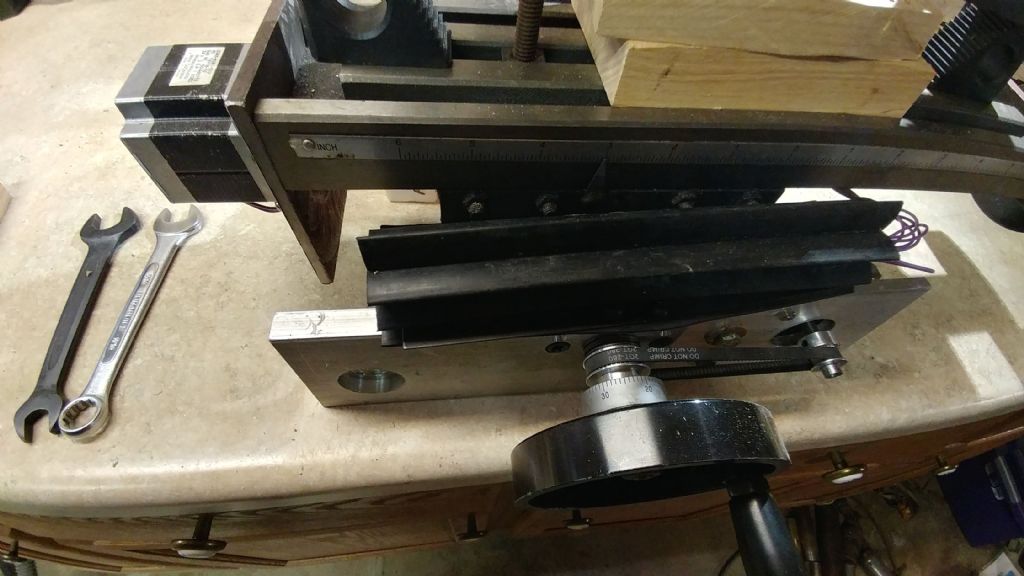

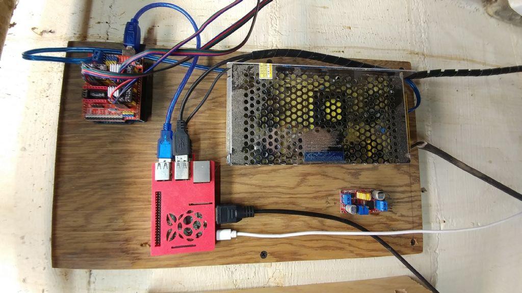

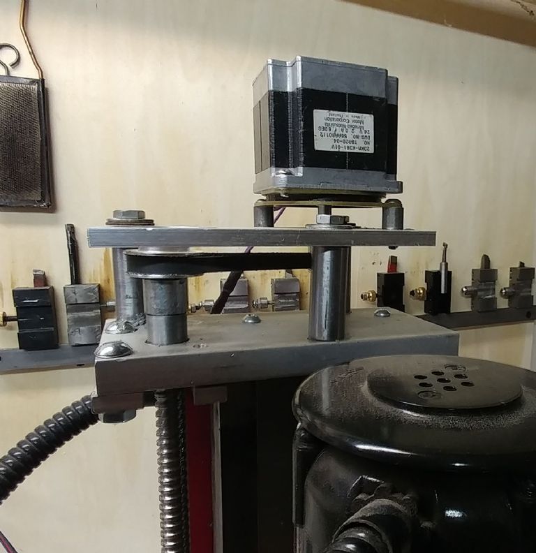

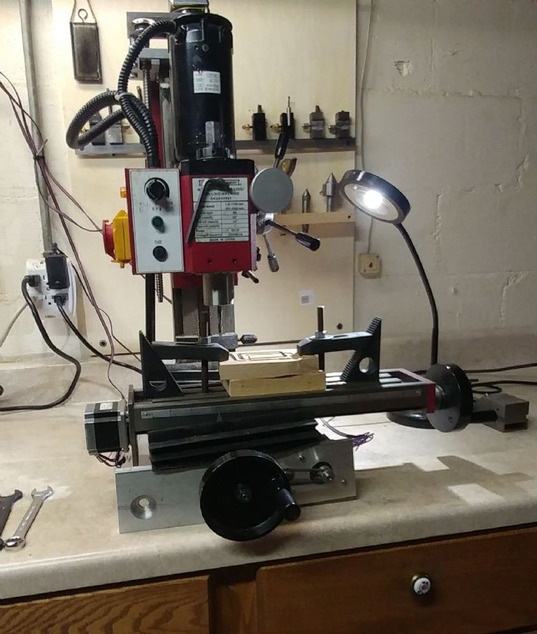

                  I wanted to try some CNC without a major cost. When I finished I had a functioning but not super accurate CNC mill with the inaccuracy mostly from keeping the acme thread lead screws for the X and Y. My X has about .007" backlash and the Y only at .003". I used timing pulleys and belts for the Y and Z while the X is connected directly to the X leadscrew. I wanted manual control for X and Y retained so the handwheels are left on. That required some compromises but as I learn I am glad to have them. The total cost was about $100 USD. I used an Arduino with a CNC shield and a cheap power supply. I drive it with a Raspberry Pi running bCNC.
                  z control.jpgsteppers x+y.jpgEdited By Ronald Morrison on 13/01/2021 12:40:39

                        I have both Universal Gcode Sender and bCNC available to use on the Raspberry Pi but use bCNC because it will show the toolpath. UGS would show it too on a more powerful computer.
                        You may have noticed that I have not completed the power connection to the Raspberry Pi yet but that will be done soon using the buck converter mounted on the board near the power supply to drop the 24 volts to the 5 volts that the Pi needs. My connection that I use now does not supply enough current to the Pi.
                        I also have a Arduino Mega 2560 set up with Marlin instead of GRBL but I haven't taken the time to do more than verify that it will turn the stepper motors with the commands.

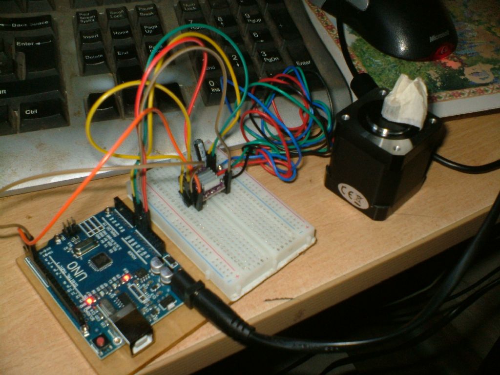

                          Ady1
                            @ady1

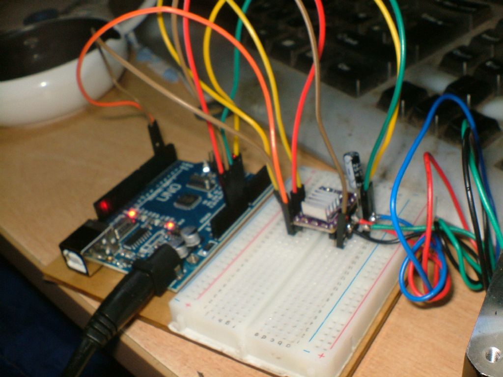

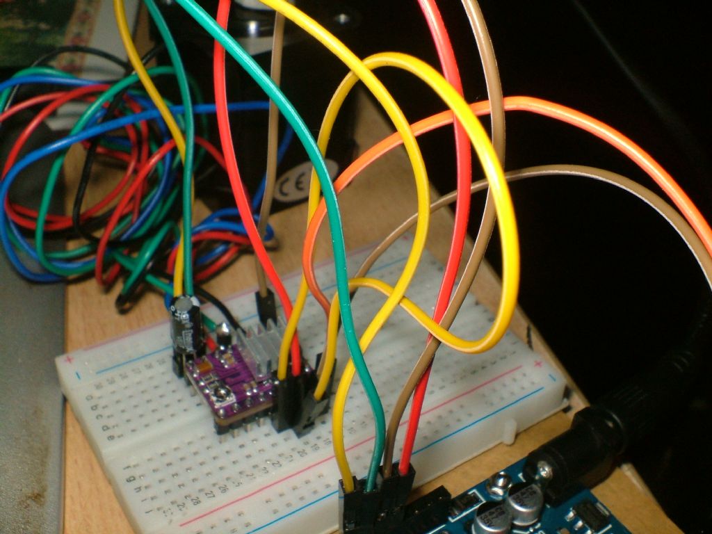

                            I had a look at the GRBL thing today but the family braincell wasn't keen so I decided to go for a simpler approach
                            I decided to have a go at running the whole ballgame from the arduino including the NEMA17 stepper
                            Couldn't find my 12V plug thing… too much housemove stuff but found a 12V jack transformer for an airpump, which was 18V when I put it through the meter… Decided to use it anyway
                            I used this guys tutorial, which is brill and all I needed
                            Then mounted the a4988 stepper driver on the breadboard and soldered pins onto the stepper motor wires
                            I have found those integrated breadboards great for projects
                            loaded up the library and uploaded his simple routine via the usb, unplugged that and plugged in the 12V jack and waited for the puff of smoke but it ran fine
                            Luckily I only let it run for 30 seconds before unplugging because I had been unable to reset the pot and it was running a lot of juice. The little heatsink on the a4988 was too hot to touch. I swapped the micro phillips screwdriver head out and used the slotted head to try and adjust it, success! and I got it down to just under 0.5V from its default of 1.5V
                            This was a huge improvement and limits the juice at 1A (I believe), in any case there were no more heatsink issues, even when I fought it with my fingers and made it work hard
                            I'm cutting out the 12V adapter on the tutorial schematic and powering it directly from the green and yellow wire on the arduino(VIN and GND) to the main VIN and ground on the a4988, the voltage was 17V (yes I know!) but it at least showed me everything worked
                            It's pretty darned kewl and has definitely boosted my interest in the subject
                            Edited By Ady1 on 24/01/2021 00:32:55

                              #522168
                              Ady1
                                @ady1
                                Final note
                                When I adjusted the voltage pot I pre loaded the BLINK routine (like an arduino hello world) to over write the stepper program and disable the unit from doing any work while it was being adjusted
                                Once it was sorted I reloaded the stepper routine
                                Edited By Ady1 on 24/01/2021 02:00:34

                                  Any, I'm not sure about the a4988 but on other types of driver you can adjust the pot without the motor connected.
                                  #522241
                                  Ronald Morrison
                                    @ronaldmorrison29248
                                    Posted by John Haine on 24/01/2021 08:06:37:
                                    If you connect power to the A4988 without the motor attached it instantly burns out the A4988. It took burning out 3 of them before I found the information on that. It was documented but not real well.
                                    #522245

                                      GRBL looks complicated because it has to be as it controls 3 motors at once, each with its own step rate. Once you have one motor set up with it, it becomes less complicated as you can adjust the other 2 motors similarly. Some of the settings can be ignored while you adjust only the ones you need at the moment.
                                      Thanks to Ady1 for posting a way for experimenting with the A4988 with one stepper motor. Could you see using that to control a rotary table or an indexer? How about just the x axis on a mill or the leadscrew on a lathe? Maybe it would work for the cross slide. Hmm… how about two of them, one on the leadscrew and one on the cross slide to work in a coordinated fashion to precisely fashion odd shapes?

                                        Right! Not the A4988 then. In my mill power feed I use a DRV8825 on a Pololu carrier board. This is a much more up to date driver with better performance than the 4988 and is happy for the ref voltage to be adjusted without the motor connected –
                                        **LINK**
                                        I've also used the 8834 which is useful for low power motors and low voltages – will run happily on 5V, use two in my Arduinome clock, one for the gravity arm reset and the other for the dial.

                                          Sounds like I got lucky, it was just too much hassle unplugging and replugging the breadboard pins
                                          Going to be a useful thread this one
                                          On the a4988 front the stock cooling heatsink is totally inadequate if you want to maximise its output, it's only good enough up to half power IMO
                                          There must be some decent pro heatsinks out there for the a4988 , the amount of heat that tiny chip has to deal with is actually pretty ridiculous and testing it for overloading is easy, it will cook the end of your finger when you touch it
                                          edit: Will test it out on the big cross slide of my lathe milling setup before too long but got Mr Inlandi Revenuie to deal with over the next week
