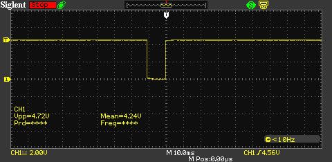

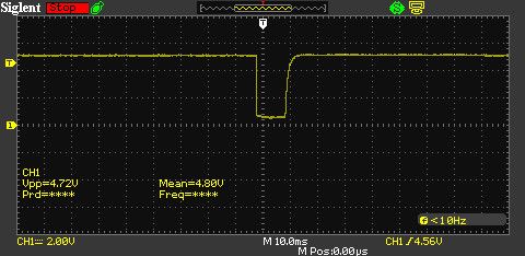

                            The 1N4148 is typically 4pF and the 1N4000 series is about 50pF, but these are much too small to cause a problem. It can only be one of two things. Either the asserted reset pulse is not going low enough, as Neill pointed out, or more likely to be the reset low duration is not long enough. Most uPs need a minimum duration of the reset pulse to provide a reliable rest pulse to be recognised. If they could be triggered by nano-second long pulses then they would be forever resetting, which would keep the uP out of running.
                            I didn't notice a POR capacitor on the original schematic? Normally one is needed to hold the uP off until the supply rail has stabilised after initial switch on. It can either use an external or internal pull-up resistor and a smallish capacitor, preferably a tantalum for low leakage. On the Motorola GP32 processors the recommended reset circuit is via a 1N4148 to the open collector device which forces the reset pin low. Not sure what Atmel recommends for the AVR types.
                            For these kind of add ons I prefer a simple monostable with a voltage comparator which gives a defined pulse duration. Something like a LM339 family works well and very low cost. I detest the 555 timer and all its problems! But YMMV?
                            Hi John.
                            Agreed. The diode mangles the waveform slightly on the rising edge and it's very unlikely that's causing Steve's symptoms. There's no substantial difference between a 1N4148 and a 1N4001. Here's the 4001 pictures:
                            Before Diode:
                            After diode:
                            POR. The Arduino family of boards all wrap the processor up with the components needed to manage Power on Reset and the other stuff needed to make the CPU user friendly. That's why Steve's circuit is so simple.
                            Arduino boards include a loader in firmware. As a result an Arduino reset isn't quite a simple CPU hardware reset. The process also checks the serial line to see if the IDE has a new image to download and installs it if necessary. Only after doing that does the CPU re-start the users program.
                            I know exactly what you mean about the 555: lots of us have a love-hate relationship with it!
                            Steve will have to look at his code to confirm that the reset pulse coming out of his Arduino lasts long enough to reset the 555. As Neil points out the pulse has to be at least 12mS long. On the output side the 555 also generates a 12mS pulse and that would explain why the relay doesn't work – not enough electrons can pass in 12mS to work the coil.
                            I can now confirm that the circuit reliably resets a Arduino Mega. As this afternoon's domestic task turned out to be much easier than expected so I might bunk off and write the code needed to generate a software heartbeat with it.

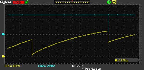

                                    Last night I was able to write a simple sketch to prove that an Arduino really can reset the 555. The code was harder than I expected, but it does work.
                                    I had to use a 30mS LOW pulse to reliably discharge the capacitor. One thing I hadn't thought of is that the Arduino and 555 aren't synchronised. If the 555 has only just started to recharge the capacitor, a very short pulse from the Arduino will discharge it. On the other hand the same LOW pulse arriving when the capacitor is nearly fully charged won't fully discharge it, and the Arduino gets an unwanted reset shortly after.
                                    This screen-shot shows a successful heartbeat followed by a reset. I pulled the heartbeat lead on the Arduino immediately after the successful heartbeat tick and then watched the 555 reset the Arduino when it didn't get another heartbeat. The blue line is the reset line and the yellow line is the capacitor.
                                    I'm pretty sure that you were right early on when you suggested that something simple is wrong with the circuit, or perhaps with the code. It's odd that 47k works when 1M doesn't. On the code side I had to do a bit of a hack to stop the heartbeat back charging the capacitor. You can't let the heartbeat pin go HIGH after you've forced it LOW, which is what normally happens with digitalWrite(). Here's how I did it, there may be a better way!
                                    void heartbeat()
                                    // Sends a LOW pulse to discharge the 555's timing capacitor.
                                    // Note the pin is reset to be an input at the end, ie neither high nor low.
                                    // Done because making the pin HIGH rather than LOW charges the capacitor
                                    // and messes up the 555's timing!!!
                                    pinMode(HeartbeatPin,OUTPUT);
                                    digitalWrite( HeartbeatPin, LOW ); // Start the pulse
                                    Serial.print("Tickn"; // only needed to show heartbeat is working
                                    delay(30); // 30mS needed to reliably discharge 22uF via 560 ohms
                                    pinMode(HeartbeatPin,INPUT); // End the pulse
