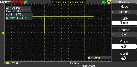

Fortunately I'm also in the midst of an Arduino based project and had the wherewithal to build and test your circuit all ready to go on my dining table this morning.
My set-up is a Duemilanove, a Siglent DSO, and a breadboard containing the NE555 circuitry.
I used a modern NE555. The original NE555 tends to crowbar the power supply when it switches and this can cause odd results. If you happen to have one of these you will also need to heavily decouple the power rail. Better to buy a modern 555.
I can confirm that the circuit works for me with the component values given. It reliably resets the Duemilanove.
The NE555 is set up as an ocsillator with a long period and high duty rate. Fo me the output of the NE555 is high for 14 seconds and then goes low for 12mS. The waveform is repeated unless the Arduino breaks the cycle with a heartbeat pulse. Therefore the Arduino needs to send a heartbeat at least once every 14 seconds.

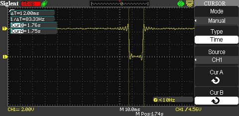

Zooming in on the short pulse:
I tested the heartbeat function by manually shorting the capacitor because I'm too lazy to write the code needed to produce the ticks! As it works with a manual heartbeat I don't see why the Arduino shouldn't do the job just as well, assuming that the low pulse is long enough to discharge 22uF through 560 ohms.

The diode is needed to stop the NE555 squirting volts into Arduino through the reset pin which is an output. I used a silicon small signal type rather than a 1N4001, mainly because I don't have any 4001s. I don't think the type of diode is a problem with the circuit values given but note the 4001 is a power rectifier that switches relatively slowly. Unlikely, but the type of diode might be part of the problem.
You had to reduce the value of the 1M resistor to 47k to get the circuit to work at all. I suspect this is because the 22 microfarad capacitor is leaking or is the wrong way round. All electrolytics leak and some are worse than others. I would try replacing it.
With 47k rather than 1M and a good 22uF, the 555 issues a 12mS reset pulse every 660mS.
