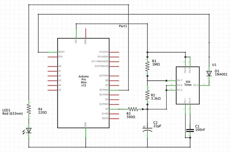

      Hi folks
      I am building a WW1 Baldwin Gas Mechanical in 7 1/4" gauge as mentioned elsewhere on the forum. I want to make it fly by wire using an Arduino and servos to control the Eaton Hydrostat and the engine revs. The code wasn't much of a problem and worked within a week of starting from having never seen an Arduino.
      However, a friend said, "What if it crashes?" Well you turn the ignition off, I had been more concerned about making it go! What you need is a 555 watchdog timer. A what?
      The idea is that a capacitor charges through a resistor, but never reaches the 2/3 rail voltage required to trigger the 555, as a discharge "heartbeat" comes from the living Arduino to drop it back down every 500 milliseconds or so. If the pulse stops, the 555 grounds the reset pin of the Arduino and discharges the timing capacitor to 1/3 rail through another resistor. Thus the grounding pull down time is adjustable and predictable.
      Well I found a circuit which didn't work immediately, so I bought a DSO and found the capacitor was unable to charge sufficiently through the resistor specified. I reduced this and watched what happed – going down from 1M to 47k Ohms gave the desired result. I now have the working circuit which trips if the pulse is removed. It will not reset the Arduino though.
      I wondered if the grounding period was insufficiently long and performed experiments with a push to make micro switch and the 'scope. The 555 was giving 50 odd milliseconds and not resetting the Arduino, but the switch would do it in less than 4 milliseconds. That wasn't the problem.
      I have tried a PNP transistor in the circuit to control the grounding and also a miniature relay due to the success of the switch. Nothing has worked. I have also had a play about with an op amp, but didn't have a proper power supply to drive it. That has been a failure so far, although I have had it following an input in a separate rig.
      My mother has dementia and is always harassing me, so I haven't been in the right frame of mind to be pushing back the boundaries of my electronic ignorance recently.
      I now have a nice bench power supply and a signal generator to go with the 'scope, but peaceful contemplation is a rarity these days.
      I am probably doing something really stupid, but I'm a complete novice in this area.
      It is also worth noting that I got the internal watchdog to work on a test setup, but as I have spent so much on gear for this it would be nice to have both levels of reset.
      Any ideas would be gratefully received.

          Much easier to help if you could provide a schematic, Steve.
          #235482
          Steve Addy
            @steveaddy35670
            Fair enough – I'll do that at some point John. It did strike me, but I'd lost the will to live after typing all that. laugh
            #235483
            Steve Addy
              @steveaddy35670
              This is the original circuit, the values were changed to get it to charge and trigger. Pin D6 and the red LED serve no purpose other that pretty flashing. Pin D2 supplies the heartbeat grounding pulse. It all works but when 555 pin 3 goes low to reset the Arduino, it upsets the device but doesn't reset it. It has to be disconnected after tripping to get a reset to occur. That rather defeats to object! crying
              #235485
              Andy Holdaway
                @andyholdaway
                Steve, what is the purpose of the IN4001 diode on pin 3 of the 555? Could the 0.7v drop across this mean that the reset pin on the Arduino isn't seeing a 'true' ground, but is floating above it?
                I would remove the diode first and see what that does.
                Andy
                #235488
                Steve Addy
                  @steveaddy35670
                  I have learned about the voltage drop across a diode Andrew, I don't know why it is there, but it doesn't work without it either.
                  This is what the article said :-
                  Once the discharge of C2, is complete, the connection between pin 3 on the 555 and RESET on the Arduino is pulled low, thus resetting the Arduino through the diode D1.
                  This is a similar circuit on the net **LINK**
                  Thanks for responding- I hate not knowing about things like this. but it is a whole new world of fascination to me!

                    All arduino boards use Atmel AVR chips… with built in watchdog timers.
                    All you need to do is programme the watchdog timer, put a 'kick dog' instruction somewhere where it is clear our code is working. If things go wrong the watchdog won't get reset and will time out, causing a watchdog interrupt. Just tell it what to do if you get a watchdog interrupt (throttle down/go into a safe mode etc.) and bobs your uncle.
                    Adding a 555 external watchdog to an AVR is like fitting an anchor to a Ferrari as a handbrake!

                      Thanks Neil. As I said I have had that working. At first I read the internal one wasn't reliable hence the 555 steer from a friend. I'd still like to get it to work though.
                      Steve
                      #235500
                      Andy Holdaway
                        @andyholdaway
                        Good catch Neil, I'd forgotten the Arduino has a built in watchdog. It also shows that I didn't fully read the original post! I've never used an Arduino for a 'safety critical' function, so have never had a need for a watchdog.
                        Steve, the page you linked to explains that the diode is to prevent the reset pin being held high, which would prevent the board from being reprogrammed unless you physically reset it every time.
                        I (like you), don't understand how this circuit can not work. If it works with a pushbutton (which will actually bounce and therefore switch the reset pin on and off many times in 4ms, a hard ground reset off the 555 should also work, unless the processor is missing the pulse. If you have also tried a relay from the 555 to the reset pin, the contacts will also ring or bounce, so you have theoretically reproduced that.
                        I'll give it some more thought when I've had some sleep!

                                What happens to D2 output when reset is asserted?
