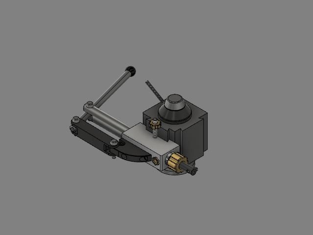

                  Nick Wheeler
                    @nickwheeler
                    The reason I'd buy a dovetail QCTP instead of a Dickson is that the holders are far easier to make. I probably wouldn't bother making standard ones, but there are a number of specific tools I'd like that would benefit from being built into a holder rather than attached to one.
                    This slotting/engraving tool for example:
