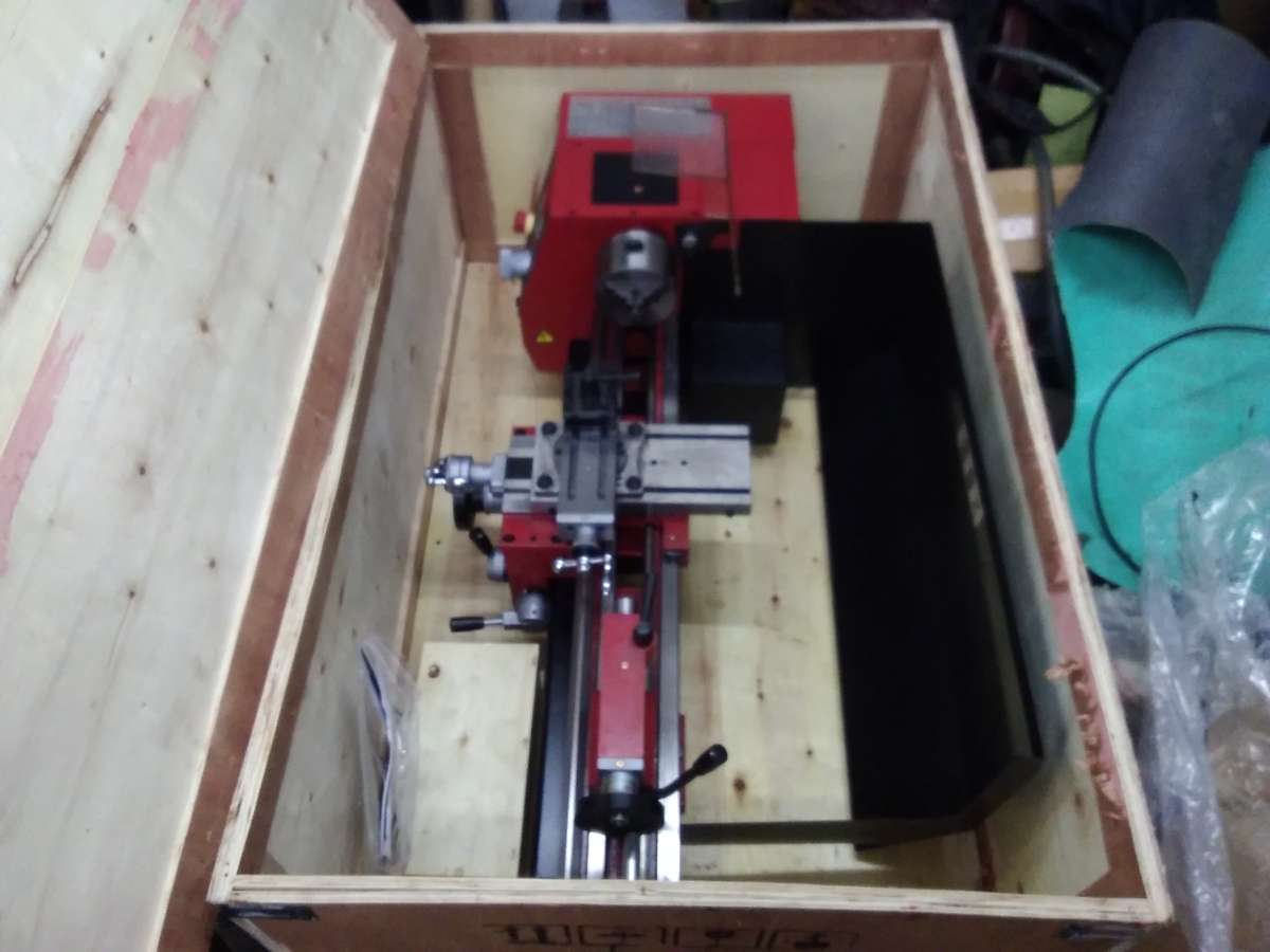

      A few months ago a friend and myself clubbed together to buy this new Sieg SC4 Lathe from Arceurotrade.
      Apart from a quick look and check that it worked when it arrived we still haven’t got round to doing anything with it, so it is still sat in its packing crate waiting to be removed and lifted onto a new steel stand which has yet to be made.

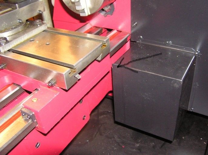

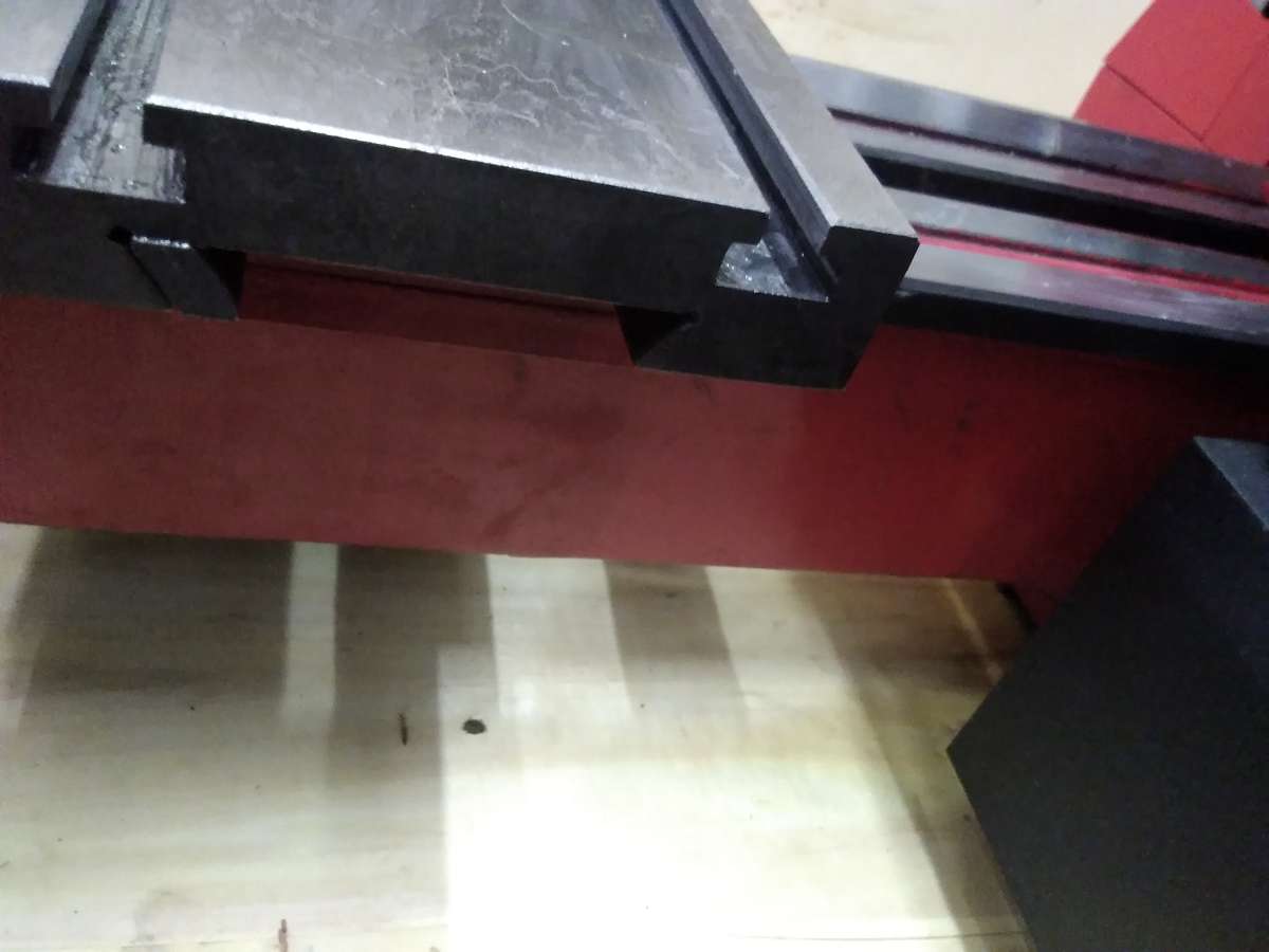

      But today I lifted the lid off the crate and had a closer look and fiddle with it. I noticed that this lathe does not have the thick raised pad with four threaded holes on the back face of the bed casting to mount the vertical milling head attachment., so this is a big disappointment.
      All other SC4 Lathes I have seen do have this mounting surface for the milling attachment, our lathe does still have the deep set back splash guard to allow fitting of one, plus the lathe spindle gear drive which can be disengaged to allow the use of power feeds when milling without the lathe spindle rotating, both of which now seem somewhat redundant.
      I am well aware of the limitations of a milling attachment on a lathe, and this is not an issue at all. So I wondered if anyone else out there has bought a new SC4 lathe fairly recently that also does not have the mounting surface on the back of the bed casting. I don’t know if Sieg have stopped including it, or if we just happen to have an odd lathe that does not.

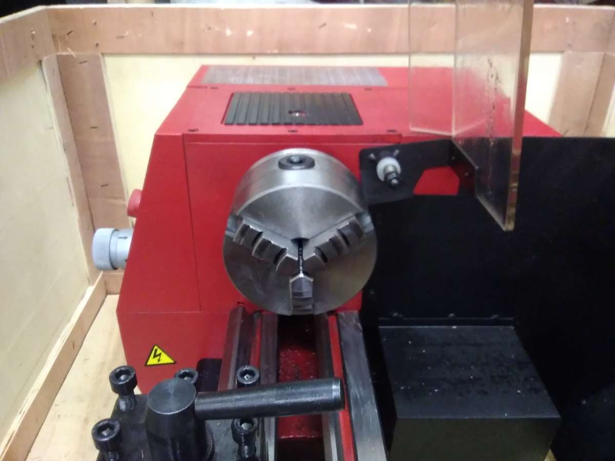

      The other item I noticed is the very bad 4 inch 3 jaw chuck the lathe came fitted with. It is an unbranded chuck with a nice ground finish, but unfortunately the guide slots cut into the chuck body have been machined oversize, so both sets of jaws slop about fromm side to side and rock backwards and forwards. Also the internal gears mesh and rotate very roughly, even jamming at times as the key is rotated, even with the jaws removed. It really is the worst I have ever come across, and all other Chinese lathe chucks I have tried have been absolutely fine.
      So it looks like a new replacement chuck will have to be purchased, and I think I would like to stick to a 4 inch chuck. But I just wondered if anyone has fitted a 5 inch chuck to the SC4 lathe and if the lathe has coped with it OK. While the SC4 is a more substantial machine than the SC3 type mini lathes it still has a similar size headstock spindle and bearings to the mini lathes, but a 5 inch chuck is quite a bit heavier than a 4 inch item.

        Contact Ketan at Arc. I am sure he will replace the defective chuck and comment on the lack of mounting holes for the steady.

            Sounds like you had better get the lathe in a position where you can check it over under power so when contacting Ketan you will have a full picture of any points to discuss.

              Buying a replacement chuck is not a problem, I was more interested in SC4 owners experiences of using a 5 inch chuck on these lathes, I’ve seen the smaller mini lathes sometimes fitted with a 5 inch chuck by owners, but it seems over the top for one of those.
              Not being able to fit a milling attachment to the lathe is a disappointment, but it doesn’t really matter and wasn’t part of the original plan, just the option to do so might have been handy. I was just interested from other owners if their machines had the facility or not, rather than Arc taking lids off crates to have a look. The lathe itself is fine, and has the usual quality look and feel of small Sieg Lathes and mills.

                All other SC4 Lathes I have seen do have this mounting surface for the milling attachment, … I don’t know if Sieg have stopped including it, or if we just happen to have an odd lathe that does not.
                I advise not relying on experience when a feature like this matters.  Don’t assume!    Whether or not a bed provides the fixing is in the manufacturer’s hands.  He might cast a few thousand beds for the combo version before realising it wasn’t selling and then use them up on ordinary lathes.  Then the next batch of bed castings are simplified – cheaper, but maybe surprising a customer.
                The other item I noticed is the very bad 4 inch 3 jaw chuck…
                Sounds like a lemon slipped through the net.  Talk to ArcEuro.
                Can’t answer the question without knowing what ‘coped with it OK‘ means!
                5″ chucks are considerably heavier than 4″, which stresses the bearings, drive train, motor, and electronics,  eventually causing a premature failure.  A 130mm chuck is roughly double the weight (5.6kg) of a 100mm chuck (3.2kg)   And because a 5″ chuck will also hold heavier jobs than a 4″, the extra stress could be considerable.
                Thing is the extra loads are unlikely to cause a spectacular instant failure, and may take years to show up.  Eventually is not black and white predictable!
                • Wear and tear caused by occasional overloading might never become noticeable, but,
                • Continuous heavy overloading causes rapid wear.  If the operator forgets it’s a hobby machine, loads a hefty lump of metal, and then hacks into it aggressively for tens of minutes.   One rough session could pop the electronics and burn the motor.  And less obviously take a few years off the bearings too.
                Lightly built hobby machines last for donkeys years when driven within their limits.   Depends on what the owner wants, especially as most machines will take mild abuse without obvious consequences.  But the owner might be happy to thrash one until it breaks and then replace/repair.
                If a 5″ chuck is essential and will be worked hard, then I suggest buying a bigger lathe.  However, if the 5″ chuck is lightly used, then an SC4 will cope.    It’s what the operator does with the lathe that makes the difference.

                  No pad on mine, bought last year.
                  Ian

                    I bought a Sieg SC4 from arc euro last year, and it doesn’t have the fixing block for a milling attachment.  No big deal really for me.  The supplied chuck is fine, the jaws are a little sloppy but it is quite accurate, within a couple of thou.
                    Come to think of it, I’ve never seen a SC4 with a milling attachment.
                    The first thing I did was to drastically reduce the size of the silly extra large swarf back splash,  cut off about six inches to bring it closer to the bed. Fits on the bench top nicely now.

                      They did have  apad at one time but I don’t think it was a popular seller as a combi  so they may have just dropped the idea. Ketan or Iain would know when.

                        The bad chuck that is fitted isn’t an issue, no complaints, another will just be purchased. As I mentioned earlier will stick with a 4 inch chuck as that seems just right for this lathe, don’t need or particularly want a larger chuck but was just curious about others that use them on these Lathes.
                        And thanks to those that replied about the milling attatchment mounting pad, it confirms that it was a feature that was discontinued. I cannot recall seeing the milling attatchment being offered by anyone in recent years anyway.
