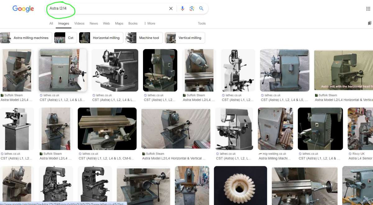

Interestingly I’ve not found any pictures or reference to the back geared model – they all appear to be simple 4 step pulley arrangements giving a limited speed range, all of which are rather too high for horizontal milling. Ironic, given that the machine is principally horizontal.
The machine looks to have been uprated by Braddock Machine Tools of Oldham and carries their plate showing 8 ungeared and 4 geared ranges from 35 to 1850 rpm. There’s a tumbler gear arrangement that’s robust and well made, overall providing approximately 40:1 reduction from the 1/2 HP motor.

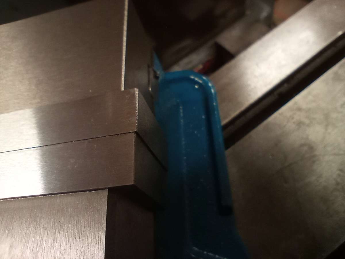

I should have saved myself £10 and bought from Vevor – the Arc vice I received yesterday is very disappointing. I also don’t see any difference in finish or construction at all apart from the chromed handle. Even the box is marked with the Vevor description.
People here seem to hold Arc In high regard, but my first order with them gives me a different opinion.
The vice I got had the following problems right out of the box:
1. Significant lateral misalignment of the jaws and poor corner on the fixed jaw.
2. Both screws on moving jaw rattling loose, but not the reason for misalignment.
3. Fixed jaw 0.07mm higher on the right hand side.
4. Right hand screw of fixed jaw very loose.
5. Grey abrasive paste present.
6. Feed screw has area of resistance on each rotation, suggesting bent screw.
7. Burrs on T-bolt faces preventing even seating.
I spent a good deal of time trying to get the jaws aligned but without complete success. The fixed jaw rises on the RHS when the retaining screw is tightened and its impossible to tap down. It appears to me that the jaws were ground with the screw loose and this is how it left the factory.
I need to further investigate the feed screw to determine what’s going on.
I fully realize that this is a low-cost item, but it doesn’t appear to have any quality control either from the manufacturer or supplier. Its a box-shift either way. Others seem to have received much better examples and the videos of people measuring up Vevor vices don’t show the same problems.
I thought about sending it back, but its a real hassle and suspect that I’d get another random lottery-draw item in return with maybe a different set of problems. I’ll take another look this morning as to whether it can be fixed. I’d rather be machining than fixing, though.

It isn’t the uneven chamfer thats the main problem. Whilst the jaws will align with the screws removed, as soon as they’re moderately tightened they shift out of position considerably and won’t tap into position. I can see that the screw heads are not anywhere near centred in the counterbores and this is perhaps the source of the problem.
The binding screw is down to a combination of wobble in the outer collar and a slight angle of the surface where it bears. It needs a better collar machining and the casting squaring up.
One aspect that is good is that the top surface where the moving jaw operates is reasonably parallel with the base on both sides to within 0.01mm. This at least means that anything clamped will machine true enough. If I can get the jaws aligned and fix the collar issue it would be a good vice for my machine – its a really good fit on my table and gives adequate clearance.
The jaw misalignment when the screws are tightened is down to the holes for the securing screws being wrongly positioned, but in addition instead of being counterbored with a flat bottom, the holes are just drilled. The tapered seating causes the screws to self-centre and displace the jaw. I tried clamping the fixed jaw whilst tightening the screws , but the jaw shifts as soon as pressure is removed
What this vice particular vice needs is either a carbide cutter to flatten the counterbores (which I don’t have), or washers machining with one flat side and the other cone-shaped to allow the jaw to be lightly clamped then tapped into position before final tightening. I suppose another way would be to grind the seat flat.
I didn’t have enough time today, but tomorrow I think I’ll machine up some washers to give the screws a flat seating.
As soon as Arc opened on the Monday following me posting about my dissatisfaction, I had a call from them expressing concern for the issues and an offer to exchange it at their cost. Also was the suggestion that I may care to visit their premises and select a vice that’s satisfactory to me.
The previous day though I’d done some more work to get the jaw alignment as I wanted and was happy with the result, so decided to keep what I’d got.
I’ve used the vice quite a bit since and it’s maintained accuracy to within 0.01mm in all directions.. Even using the vice with the jaws in line when horizontal milling there’s no slippage and no need for anything other than moderate tightening.
