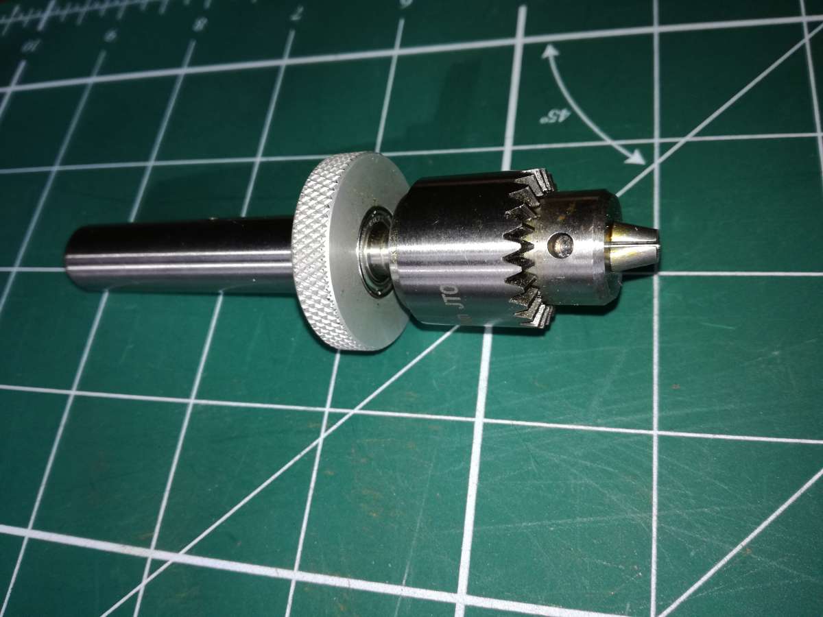

            Hi, I have one of these with a chuck that holds drills from 0.3 – 4mm, which I think is similar to what Joe was talking about at the end, which I have used in both my mills and lathes,
            IMG_20250330_152300
            It’s sprung loaded, and you just hold the knurled ring and apply your desired pressure onto the drill, easy as pie. (no pun intended)

              Small drill?  now try it with a Number 80 drill or a 0.3mm.  I have used these when trying to make small steam injectors.

                I’ve one of the same type. The next time I need to use it, I’m going to remove the grub screw and release the spring, so the chuck will revolve if the drill should become jammed as in the video.
                Thanks Speedy, I note your words of caution.
