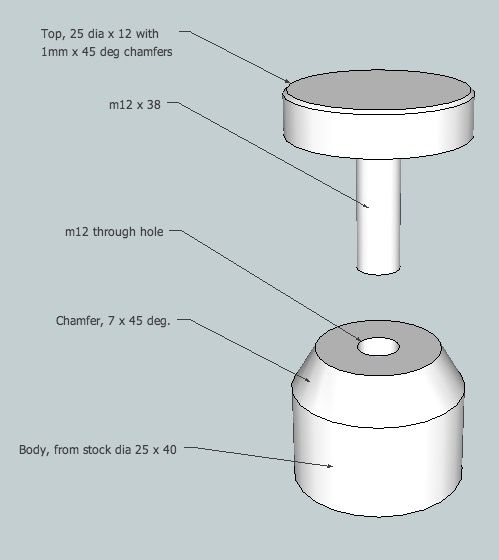

                                      Steve Pavey
                                        @stevepavey65865
                                        well, first off I apologise if I got the wrong idea, but your first two posts made it sound like some sort of official government sponsored employment training scheme, with all the H and S requirements that go with it. I've had a bit to do with such courses and they are a nightmare of bureaucracy and hoop jumping. By way of an apology I offer the following suggestion for you to take up or reject as you wish –
                                        If they are also going to do some milling maybe a little screw jack might be a bit more useful, as it includes some thread cutting – it is very useful to know how to use taps and dies with the lathe to keep everything square. I would choose aluminium for beginners as it is fairly easy to get a good finish and maybe a bit easier on the tools, but mild steel would do just as well.
                                        steel
