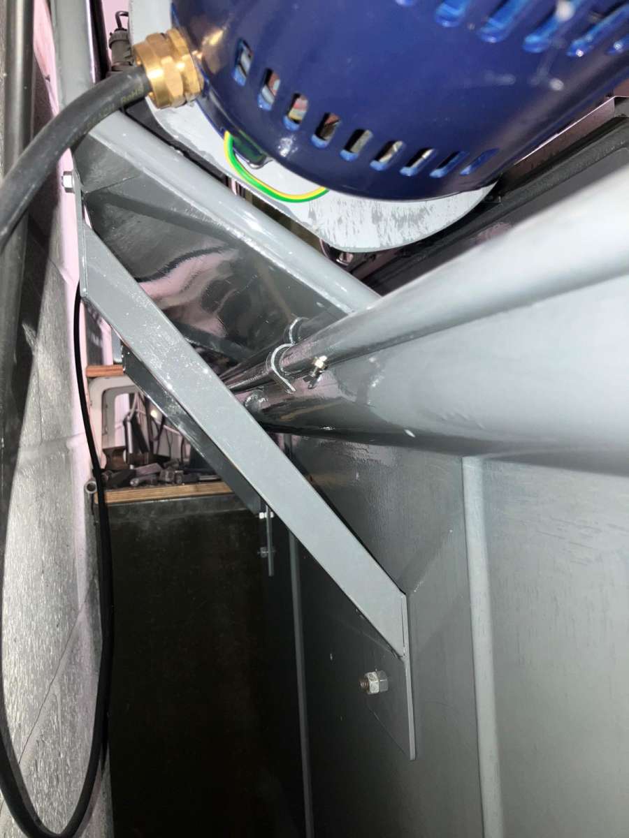

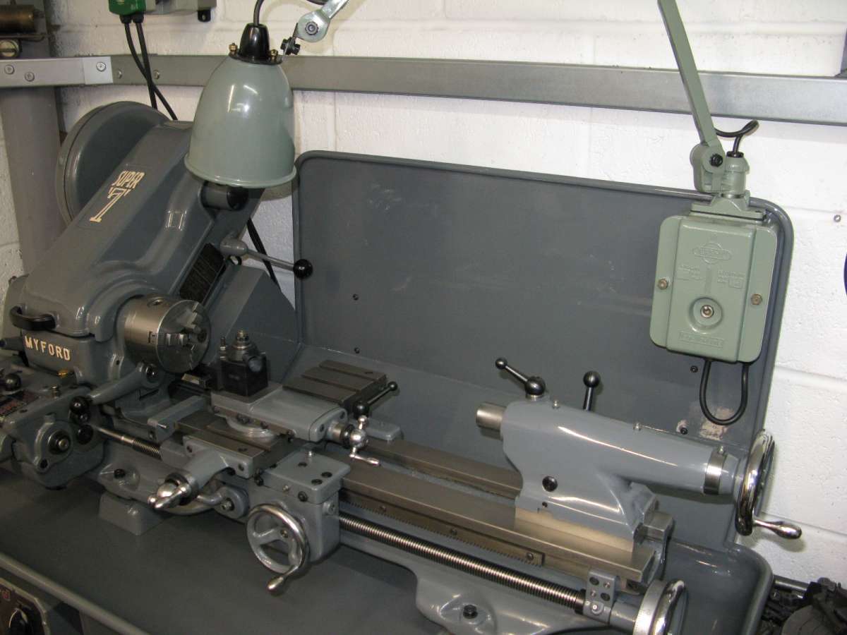

          I’ve not made a Boxford splashback, but I have made one for my S7 which is on the old industrial stand with rounded edges. The back is made from 1.5 mm sheet and as I could think of no way of bending it neatly, I cut a series of slots with a cutting disc, a bit like long perforations,along the bend line which enabled a very clean bend. The edges are round 10mm tube from B&Q which I bent round a simple wooden former after filling with sand and heating red hot (there are some pictures and description on the model engineer proboards site in the what I’ve done today from earlier this year). After tack welding it all together I filled the slots left in the bend with JB weld and a skim of car body filler before painting. I’m fortunate to have a small TIG set, but did make similar for an old lathe I had years ago from square tube and thin sheet, using hidden pop rivets and soft solder ( and more car filler!) when painted it didn’t lookk too bad from the front. The splashguard is bracketed from the base of the stand quite rigidly as I wanted to hang the heavy machine lamp from it, the idea was to try and make it all look as if Myford intended it to be like that, No, I don’t know why either, but it makes me happy! I’ll try and poke my phone behind the stand to photograph the bracketry later today.IMG_0698

            Nigel – thanks for that, it hadn’t even crossed my mind I could use plastic.
            Dave – I like the look of yours, good idea with drilling and welding the holes. I’m in the same school of thinking as you, I like my machines to look factory. 👍

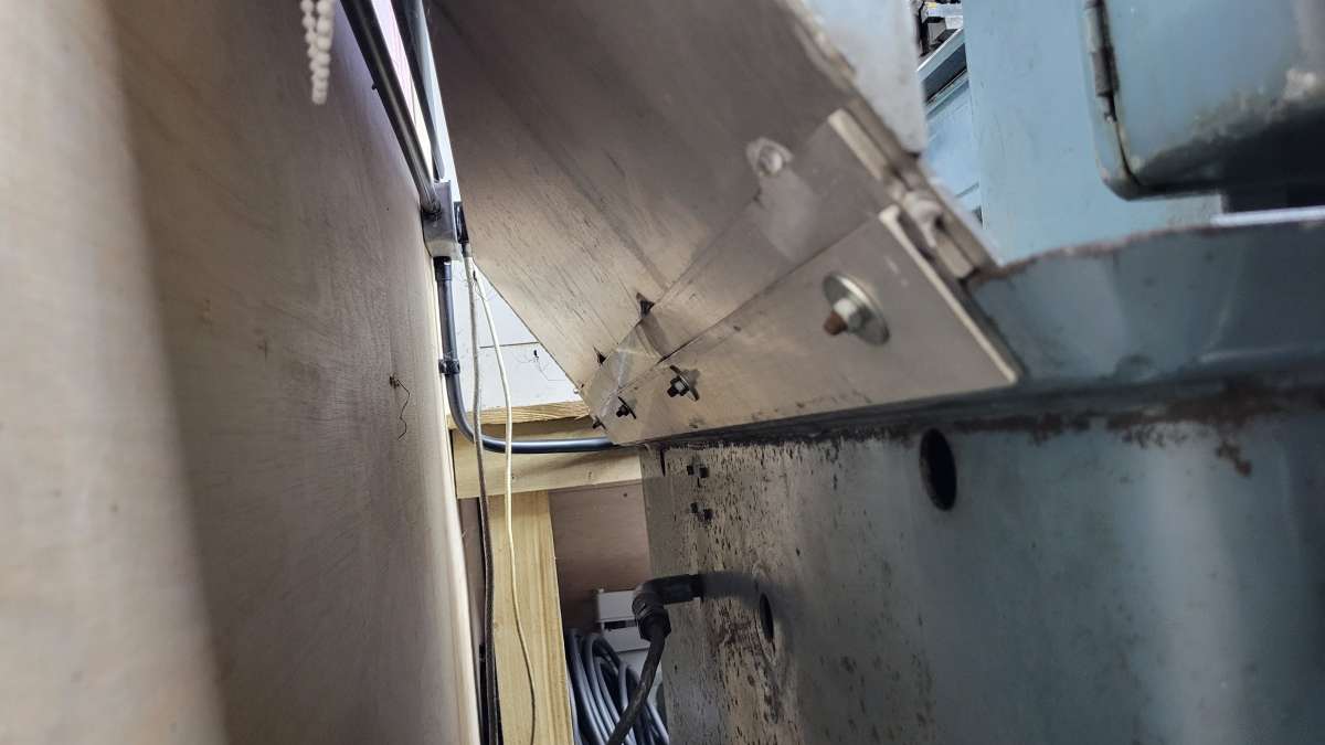

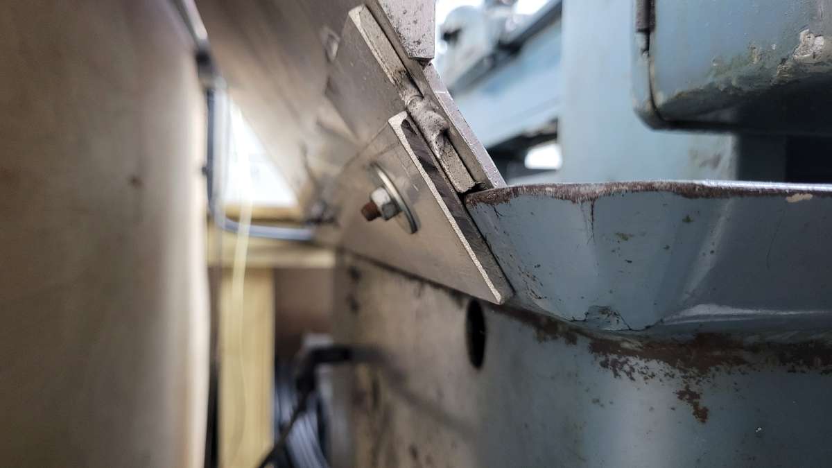

              I have made one for my Boxford AUD out of 3mm aluminium and I clamped it to the upstand on the drip tray by basically sandwiching the drip tray between the splash back and another strip of aluminium across the back that is bolted to the splash back and tightened up when slotted over the drip tray. I will get some pictures when I’m home later

                  Managed to get a fairly reasonable picture of the brackets for the Myford splashguard mentioned above, shows the clip that fits to the round edge of the existing tray and the 5mm nut and bolt drilled through the edging tube to fix it firmly in place, turned out very rigid and rattle free. Details of bending the tube are on page 487 of what i did today on the model engineer proboards website. I did not actually weld up the slots made to ease the bending but filled them with JB weld compound, I thought if welding was tried I would distort everything, not fell out yet!Myforgaurd
                  #744490
                  Dave Wootton
                    @davewootton
                    Looking at the above picture I can see the long series socket missing for months nestling between the wooden cabinet top and the wall, typically I gave up looking last week and bought a replacement!!!!

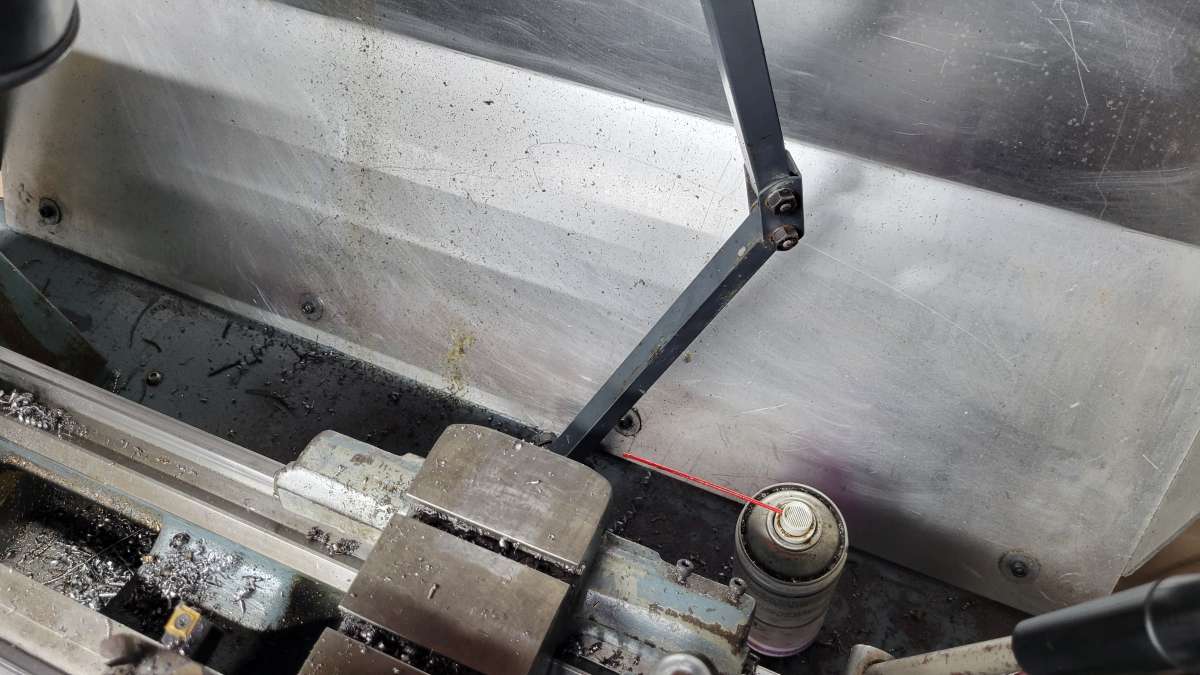

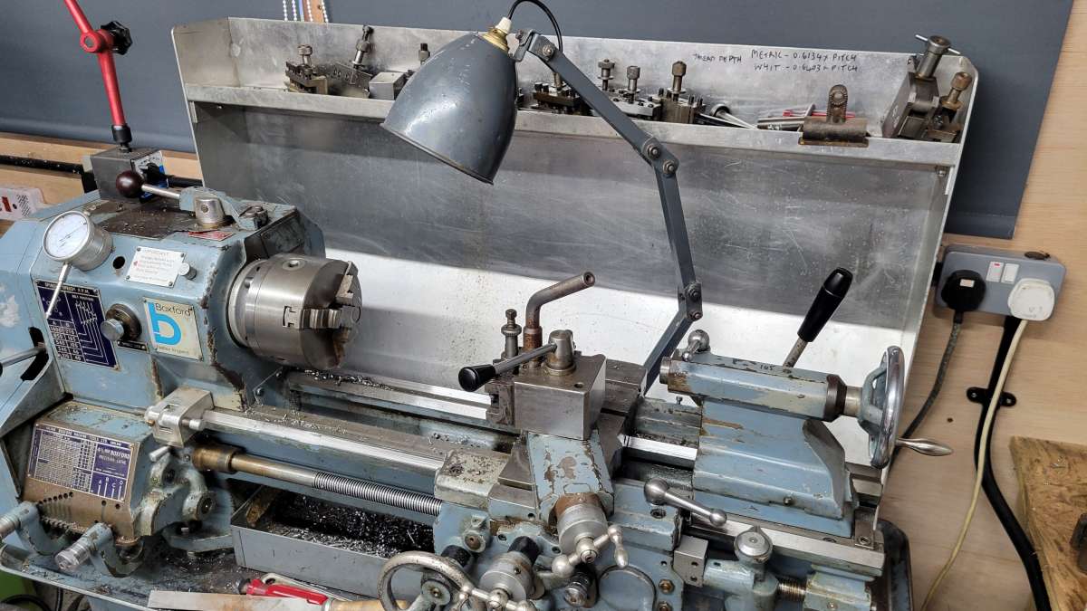

                      Sorry for the delayed reply. Here is my splashback I made for my Boxford. Its not totally rock solid but sturdy enough.

                            Thanks Craig
                            That’s exactly what I’m trying to achieve!
