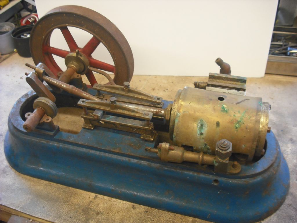

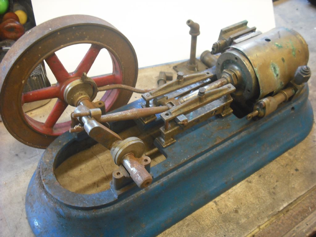

Over 200 views and no one has an idea of where this engine originated it seems, I have spent some time chasing around the internet and still no picture of anything similar.
I have a pretty large collection of taps and dies and can find nothing that matches the threads on everything and as most nuts and bolts are absent and some of the threads are pretty poor I am trying to rebuild it with metric fixings as I have loads of them to hand.

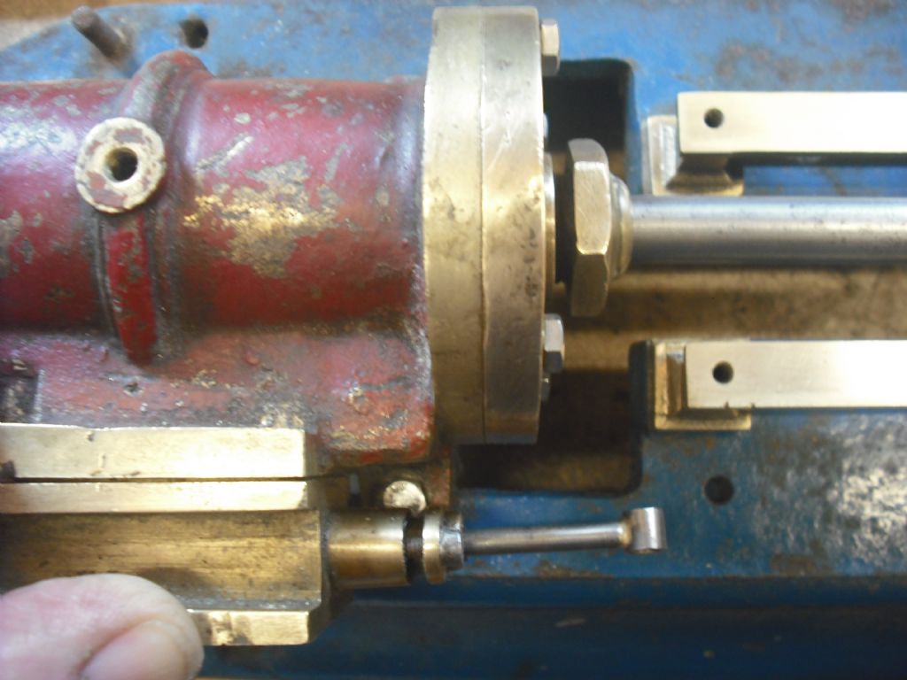

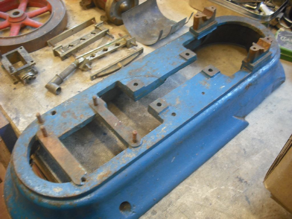

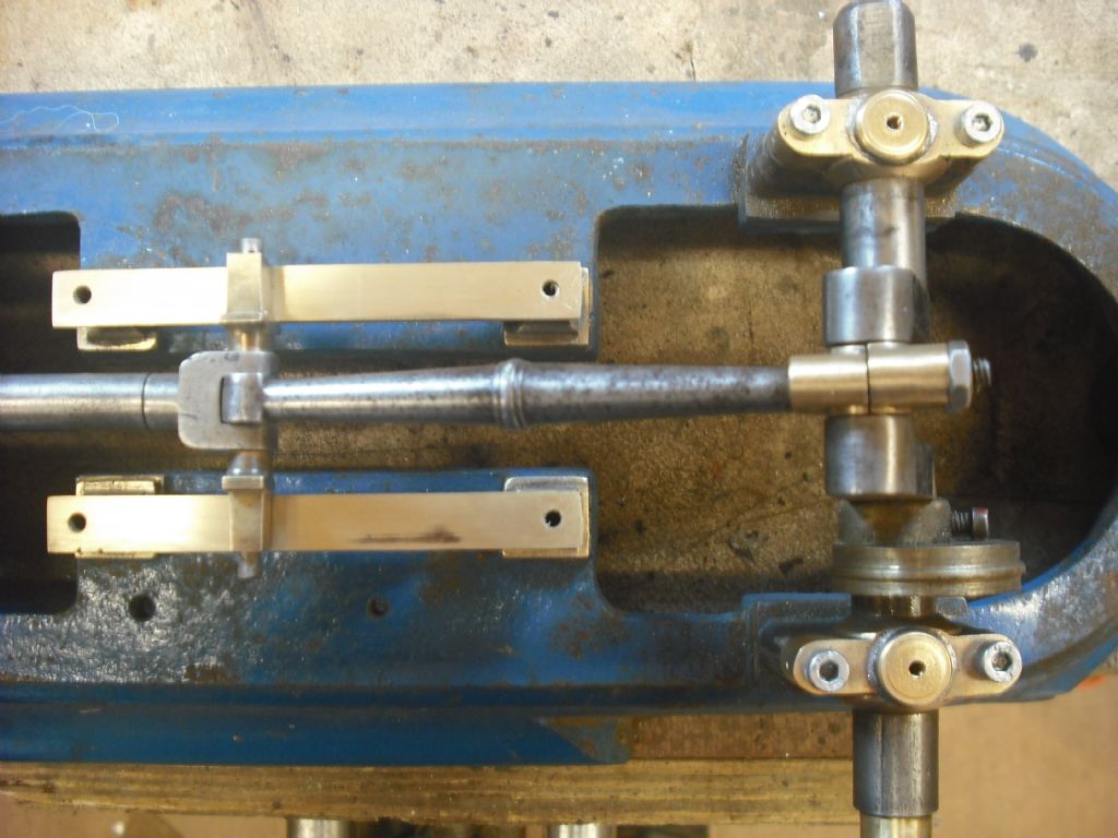

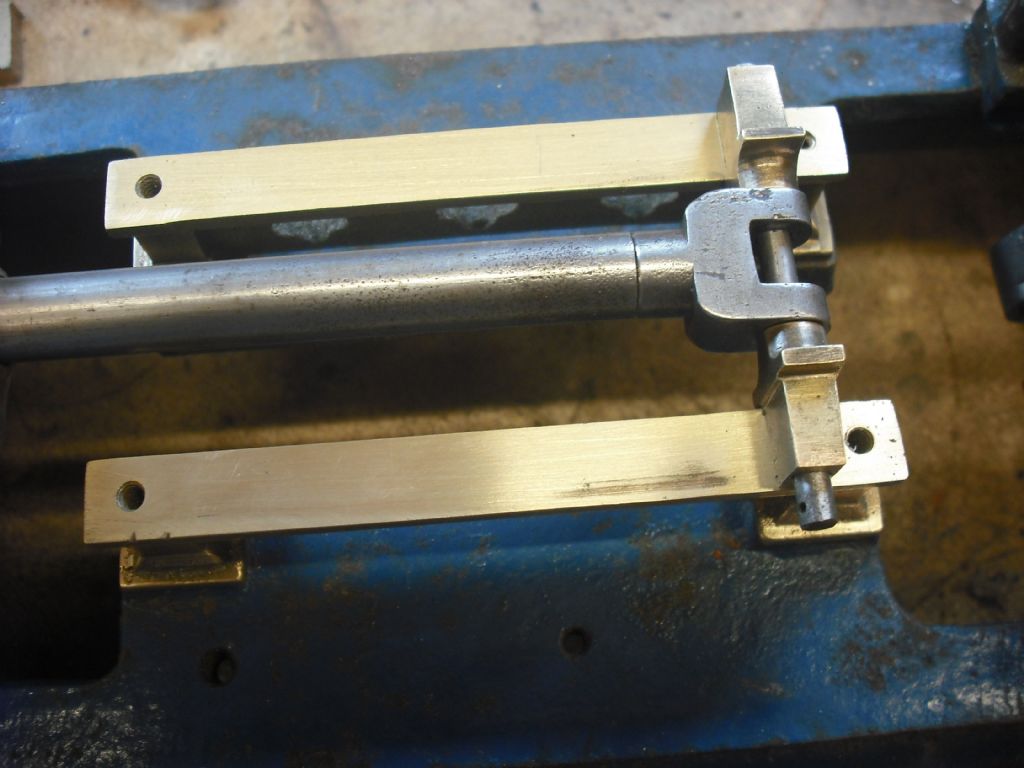

This poor old engine is pretty beat up, the crosshead slides were not parallel to the piston rod so the gland is egged out and the slides were badly worn at one end, I have re-machined the slides and will shim them on assembly.

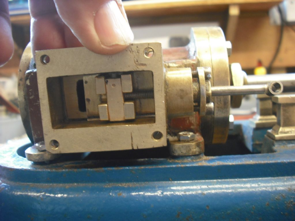

The slide valve face is not parallel with the piston rod when viewed from above. but will be workable, I have made a new valve slide and rod.

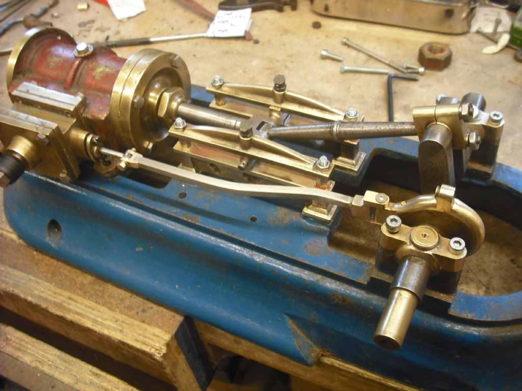

I have made a new cap for the big end of the crank rod and new bearing caps for the crankshaft (the cap screws will be replaced by studs and nuts).

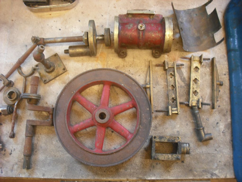

Holes everywhere on the engine are drilled out of line with one they should line up with so making parts has been interesting, the first big end cap I made was scrapped as I needed to drill the fixing holes at an angle to each other to get it to fit.
I am awaiting some gasket paper and metal to make eccentric straps and then on to reassembly.
