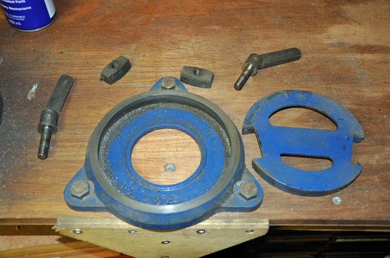

      I have a Record No. 3 vice with a swivel base. Trouble is, the swivel base has a nut that's split. The base looks like this:
      And the nut looks like this:
      [IMG][/IMG
      (Edit – whoah, aspect ratio is all wrong, but hopefully you can make it out)
      The othe nut just split it two. I thought I would be able to buy one as a spare, but the images of swivel bases I've seen are completely different to this one. Could this be an 'early' Record, or a different manufacturer that just happens to fit?

              This is mine, which I believe to be a genuine Record although it does not say so anywhere on it.
              It is exactly the same shade of blue as the vice
              Can you not file up a lump of steel to make a new wedge?

                  I had one of these for a 3" Record vice. (Had being the operative word – I gave it to my son!) Anyway, I also broke the nut, and just as some one suggested, filed up a new one out of steel.

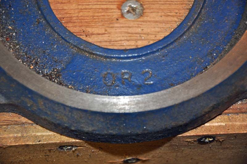

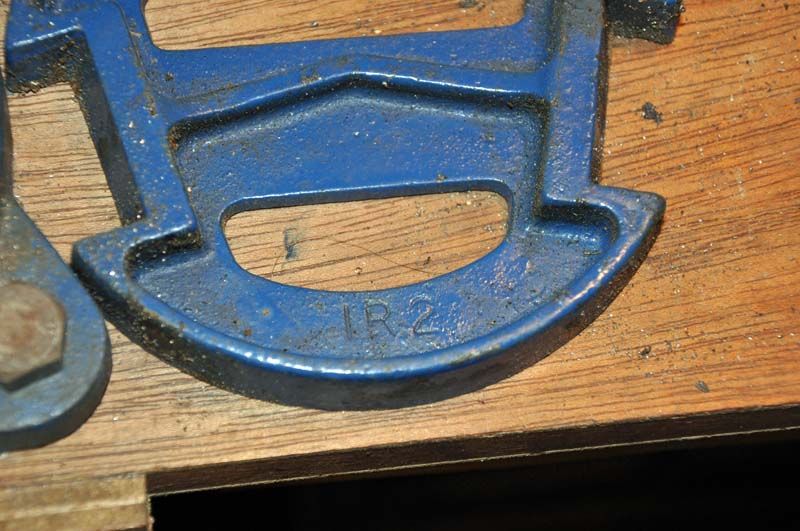

                    Ah thanks all. Rod; mine has similar markings, except it says 'IR3' and 'OR3'. They must have got fed up with that design sometime between 1960 and recent times. I'll bet someone has a cabinet full of odd-shaped nuts for these, somewhere.
