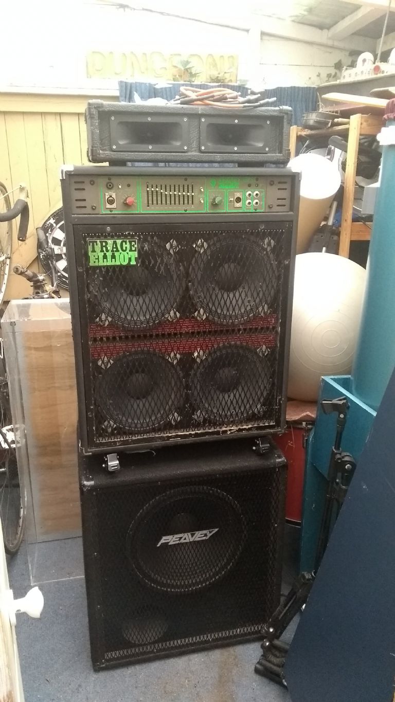

                        #425834
                          #425846

                            Very Nice Neil! And with 'improvements'!
