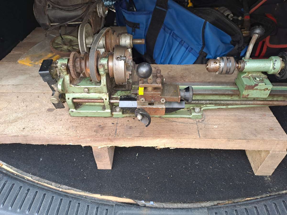

      A friend has just acquired this lathe , any help on identifying the make would be appreciated.
      20240203_131057[1]

        A Flexispeed Meteor 2, specifically what lathes.co.uk calls ‘the later version with cost-cutting features‘.
        Their description starts about half-way down a long page, and includes this photo:
        http://www.lathes.co.uk/flexispeedmeteor2/img17.jpg
        I think it’s a basic plain lathe, i.e. doesn’t do screw-cutting.

          Going by the colour, knob shapes, guard etc, I’d say specifically a Simat 101 variation of the original.
          Spindle nose is an awkward 14mm x 1.5mm, rather than the more easily available 14mm x 1mm
          I have one in a box under the bench awaiting re-commissioning, bought new from the Norfolk supplier in the early 80’s.

            Thanks all, I new The info would be with someone on this forum.

              That is what I have. A lovely little machine, in my opinion.
