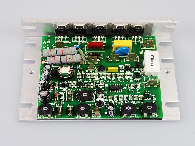

Any one know were I can buy one of these speed control boards

            I think I have sussed it. Any one know were I can get one of these boards. OOps double post.
            Edited By Dave Harding 1 on 20/09/2016 19:47:23
            #257011
            John Stevenson 1
              @johnstevenson1
              That looks like the Chinese equivalent of the KB board
              It's fitted to a variety of small machine tools so would help if you said what it's off as there are different power ratings.

                    It's off my lathe the speed control is u/s. The motor just runs flat out.
                    #257017
                    John Rudd
                      @johnrudd16576
                      Can you post up details from the label on the heatsink?

                          The details on heat sink label are.
                          DC Motor Speed Control.
                          Model JYMC-220A-l. Input 230VAC-50/60 HZ. Output 0-180VCD. Rated 6.0. ADV.
                          Yanzhou Jiayi Mechano-electronics institute. High pot tested.

                              Posted by Dave Harding 1 on 21/09/2016 11:51:49:
                              What's a speed control pot.
                              The control on your machine that varies the motor speed as you turn it cw or a/cw.
                              If the control has no effect and the motor is running flat out, then there are a number of possibilities that could cause this, a fault on the board itself/wiring to from the speed pot/the speed pot….
                              The board you describe is a typical unit produced by the Chinese based on the design by KB electronics in Florida USA….

                                    Dave, It may be worth removing the PCB from the heatsink and check for dry joints. The joints to the high wattage resistors are a common problem as they get hot. Poor contacts on the push on connectors can also get hot and cause the solder joints to degrade. Also look for any sourch marks on components. Can't see any on the photos though.

                                        I am curious about the dark spot on the side of, R 23 and the track running out from under it to the transistor .
                                        Is that dark spot a shadow or a char mark from a blown transistor and the track that runs to it looks like it has fried the protective lacquer .
                                        If you cant find a direct replacement maybe take it to some one who knows how to repair it , some electronics / tv repair shops do odd jobs or fit a board from a different machine , as long as the replacement if of equal or higher watt rating and same voltage rating it may be possible to fit it to your machine .

                                            http://www.befr.ebay.be/itm/Universal-Steuerplatine-DC-Motor-Speed-Controller-JYMC-220A-I-6ADC-230V-/262178783404
                                            appears pretty close…
                                            i also noted on ebay a US repairer… Shipping to/from US is not likely to be that expensive, and probably only a couple of days each way.

                                              Silly question but have you tried Simon at SPG ?

                                                  Yes I have discussed the problem with Simon at SPG. I have posted the board to him.

                                                    Hi Dave, I got an email on your behalf that may help[;
                                                    I am not a member of the forum but read it on a regular basis. The guy who is looking for a K.B. board for his mini lathe can buy one fromAxiscontrols based in Southport. As I am not a member I could post this and the guy seems desperate, hope this helps and he does not give up the hobby.
                                                    Rob
                                                    Hope that helps, Neil
