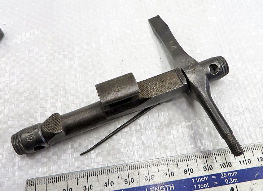

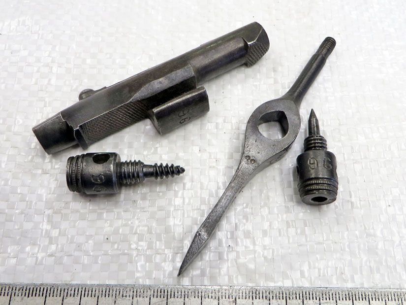

            Hi All,
            I am not sure what the odds are on finding ANOTHER early gun tool within a month of the first one?
            Went over to Weymouth to buy a couple of micrometer sets from a guy on FaceBook, asked if he had anything else and he showed me several crates of mostly junk but in with it was this tool and the other items listed below which I am pretty ignorant about and would welcome any help. I think it is all gun related.
            Will add the other items when I have done the pics.
            Cheers, Martin

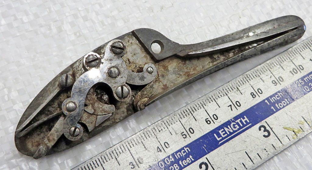

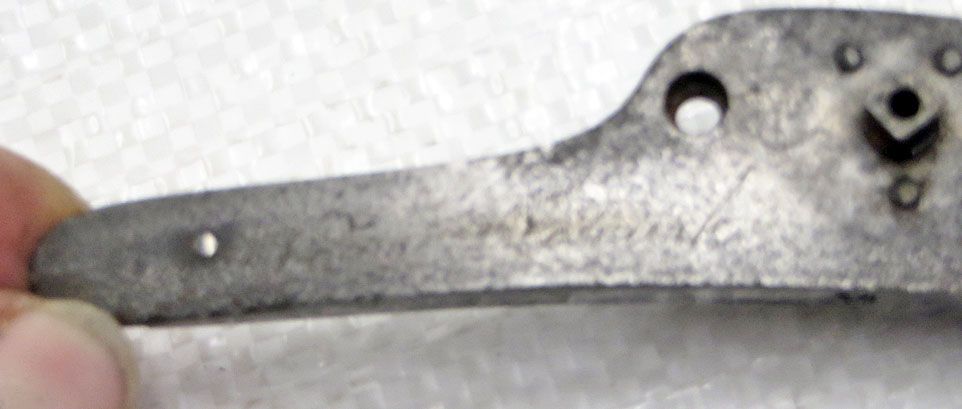

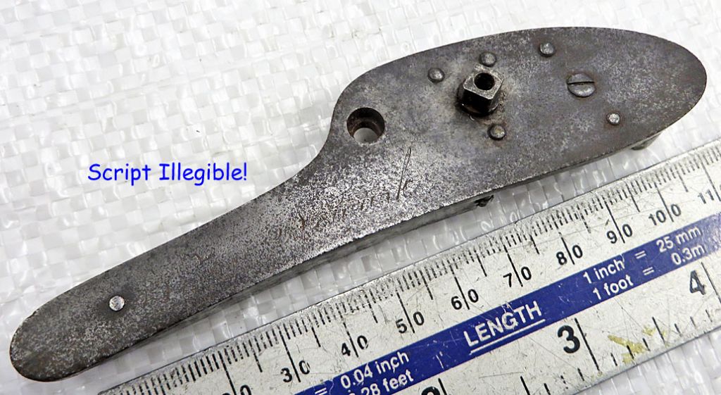

              Hi All,
              Here are the pics of the next item which I think is part of the lock assembly from perhaps a pistol. Sadly I cannot make out the scripted signature, sorry about the out of focus close up!

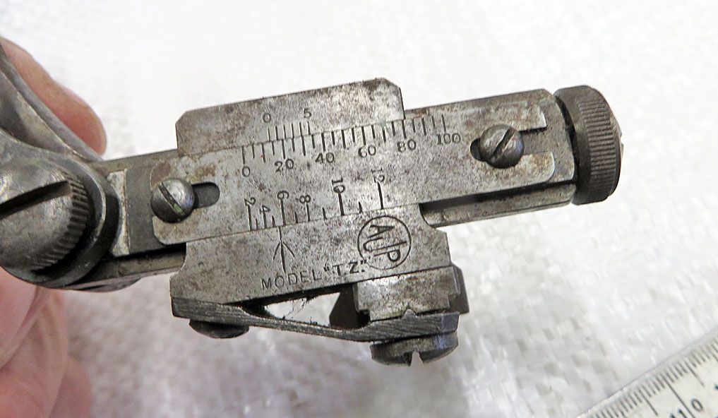

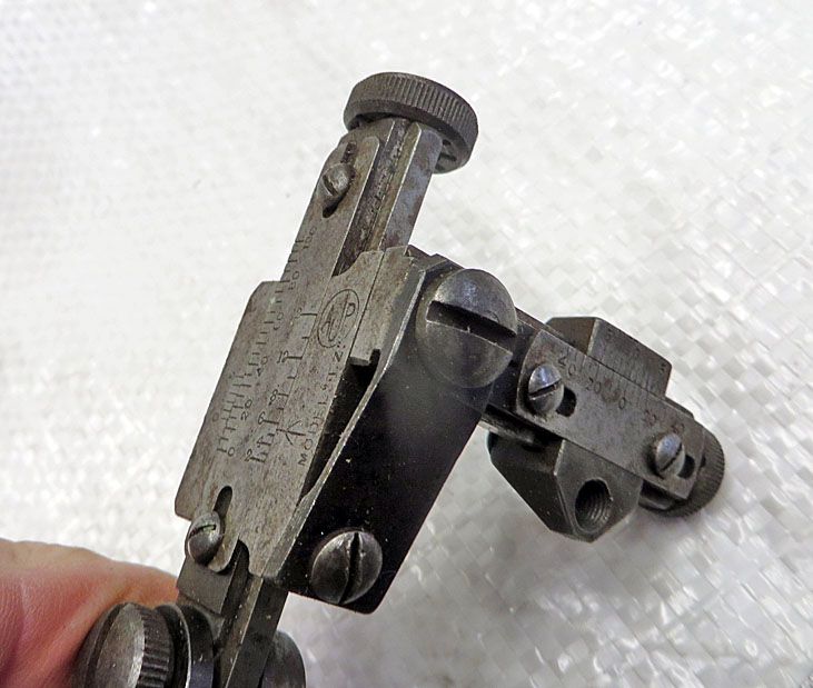

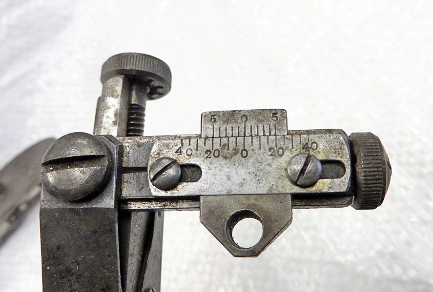

                Hi All,
                The third item is I am sure a gunsight, possibly not complete; I have no idea what it would fit.

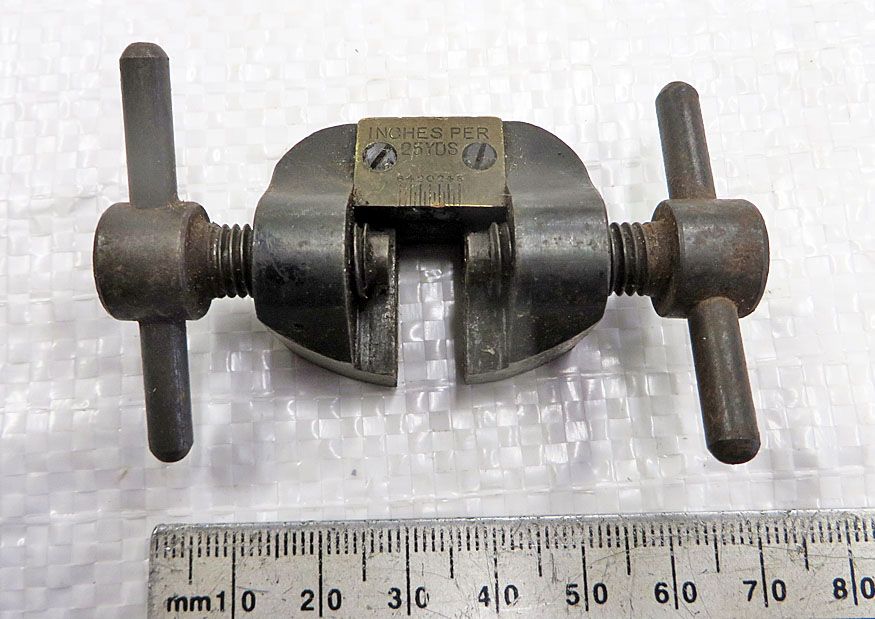

                  Hi all,

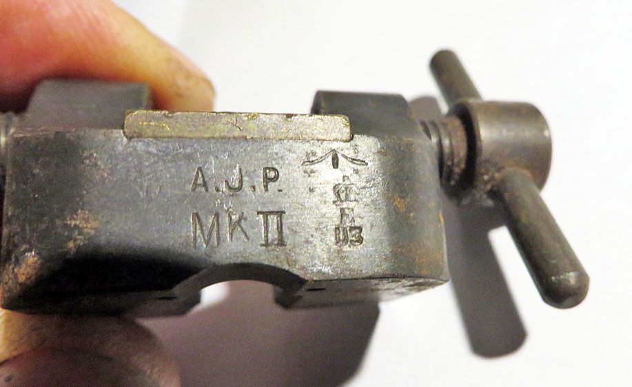

                  Last item is this one, Only thing I can think of is some sort of adjuster for windage or elevation?
                  Brass plate is marked "inches per 25 yds".
                  Cheers, Martin

                      Hi Bob,
                      Closer examination of the 'double clamp' thing reveals this so you are certainly correct.
                      Not sure if the other marks tell us more?
                      Cheers, Martin

                        I guessed the third item, Model TZ, was AJ Parker, and found he made 'Twin Zero' Aperture sights. See this page.
                        I think the last item is for centring backsights and maybe foresights that sit in a dovetail across the barrel.

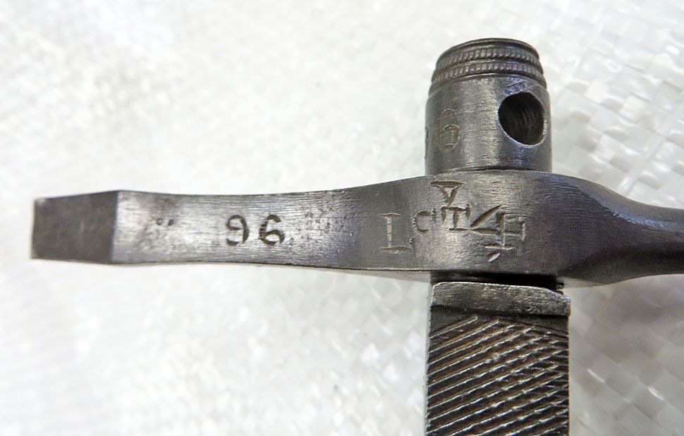

                          The definitive answer for the other multi tool shown above is this:
                          "Serjeants Pattern #4, adopted in 1858. These were for the Pattern 1853 Enfield range of muzzle loading longarms. It is missing the worm, which is a pity, however it does have nice & matching militia unit markings which are seldom encountered."
                          Apparently there were two versions with differing lengths to the screwdriver section, this is the more common shorter version.
                          Cheers, Martin

                            The 'double-clamp' item is undoubtedly an Alfred J. Parker foresight adjuster for a Lee-Enfield. If the '03' is a date, then it'll presumably be MLE or CLLE models, otherwise and maybe more likely the much more common SMLE used in WW1 and WW2 until superseded by the No.4. It shifts the dovetailed block incorporating the foresight blade sideways rather than bending it.
                            To use it on the SMLE required removal of the rifle's nosecap in order for the adjusting screws to be able to get at the foresight in its dovetail. This was fiddly to do in the field or on the range, and risked losing bits like the nosecap muzzle bedding pad and/or spring, and/or securing screw in the long grass! Later rifle models had windows cut in the foresight protector so you could do it without that fuss, but it was still something done by the unit armourer, not Tommy.
                            Edited By Mick B1 on 13/12/2021 22:36:32

                              The item is now on its way to its new owner, clearly much prized my military types!
                              The multi tool is doing well beyond my wildest expectations!
                              Cheers, Martin
