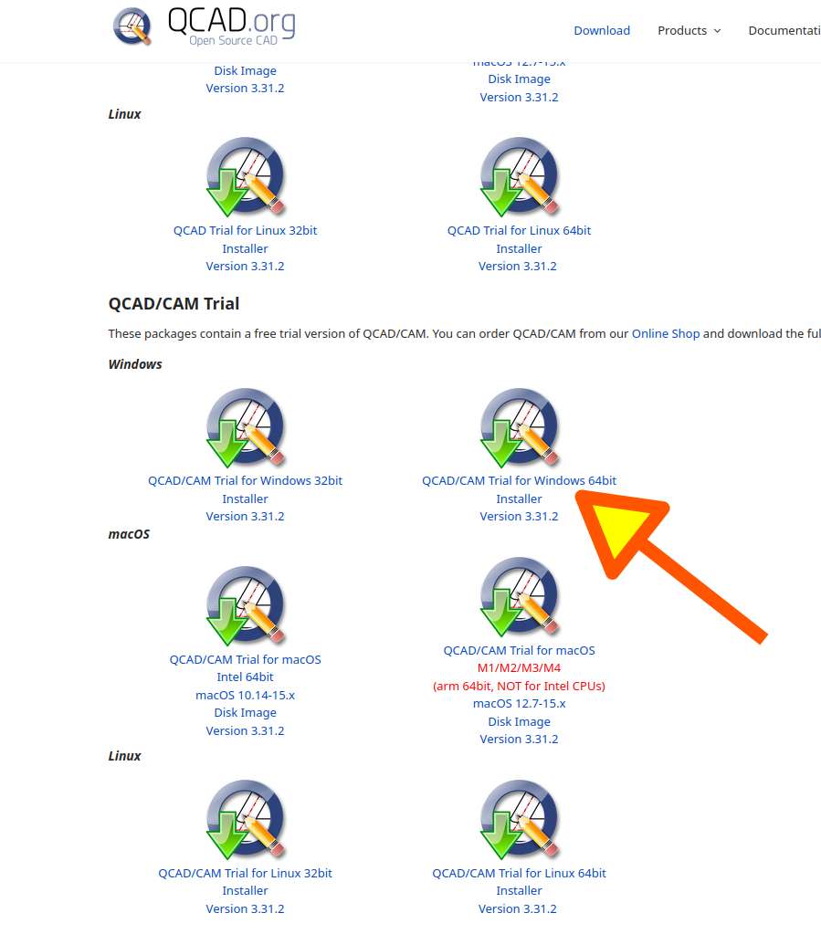

                      Just had a quick look at the QCAD website and see there are several versions, any suggestions as to which one I should download?
                      IanP
                      #769734
                      Chris Kaminski
                        @chriskaminski64716
                        what OS and hardware are you using?
                        QCAD Community Edition
                        If you are looking for the free open source QCAD Community Edition, you can download the trial version for your platform (see above) and then remove the QCAD Professional add-on running in trial mode (click Remove in the Trial widget and follow on screen instructions).
                          64 bit Windows 10, PC is about 7 years old and only 4GB Ram, but it flew with Autocad.
                          Ian P
                          #769803
                          Chris Kaminski
                            @chriskaminski64716
                            On Ian P Said:
                            64 bit Windows 10
                            I wasn’t questioning whether it could run it or not,
                            just trying to answer your question (which is not possible without knowing what you are using…)
                            arrow point to the one you want (assuming you want a free one)
                            I am using paid one (price is very reasonable and you own a copy forever)
                            qcad

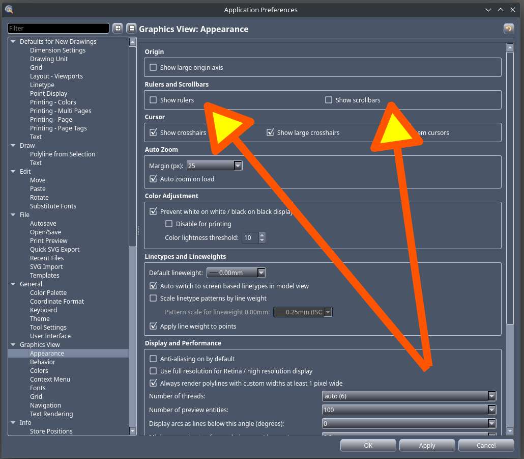

                                  I have just spent about 10 minutes trying QCAD Pro Trial (its already told me once that the trial has expired) but it restarts fine.
                                  First impressions are very favourable, I opened existing dwg and dxf, did some editing and saved and printed fine. I’m not used to the esc key not backing out of a command but I suppose that is one of the habit things that I will get used to.
                                  I turned the grid off and it remembers that but I cannot see how to turn off the rulers, is that in the paid version? I would also like to configure toolbars, say remove some buttons).

                                    Chris Kaminski
                                      @chriskaminski64716
                                      On Ian P Said:
                                      I turned the grid off and it remembers that but I cannot see how to turn off the rulers, is that in the paid version? Screenshot_20241211_150624
                                      Ian P

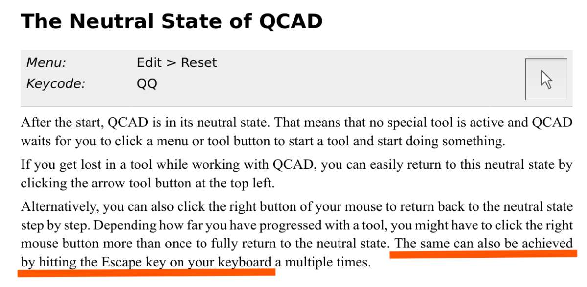

                                      Chris Kaminski
                                        @chriskaminski64716
                                        ESC works OK here…
                                        ESC
                                          That’s normal: the trial version runs for 10 minutes then you have to restart it.  From memory of when I tested Pro years ago, nothing is lost, and it can be restarted forever, it’s just a time-waster.
                                          Chris has answered the ruler question, I’m not sure about removing buttons.  Never wanted to do that, but my version is 4 years out of date and the latest may be more cluttered.   Congratulations: altering toolbars is quite advanced!  Be careful what you wish for though, Solid Edge allows toolbars to be changed rather too easily, and it’s a pig to put them right after an accidental key-combination or mouse-click removed or hid something!  Not had that problem with QCAD.

                                            Thanks Chris for the pointer to the ruler setting, I had only run ACAD for a few minutes so was bit hasty in even mentioning it. Anyway I have now given up on NanoCAD and paid for QCAD Pro which I am sure it will be more than adequate for my usage, actually I’ve now spent half an hour using it and find it easier to adapt to than I feared.
