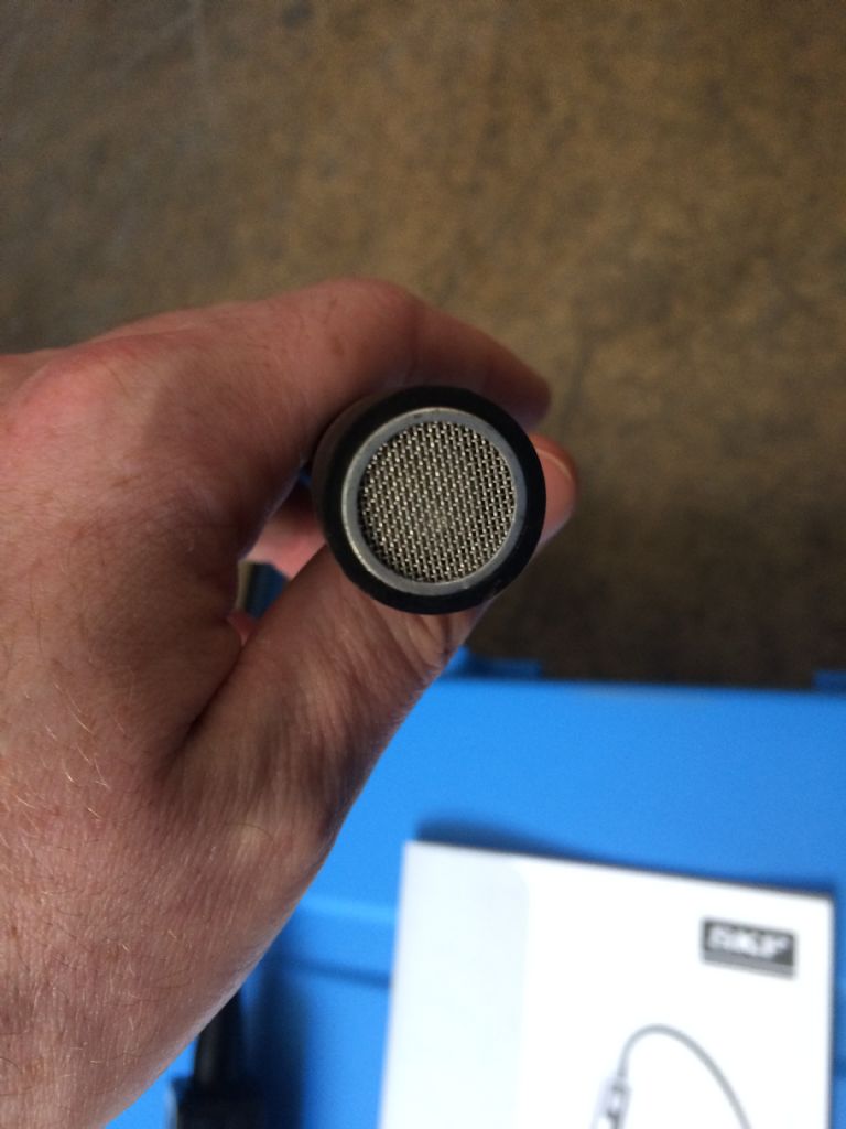

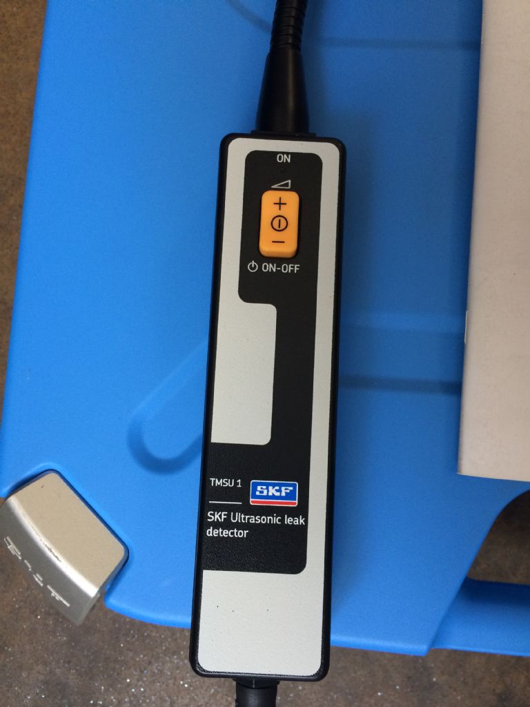

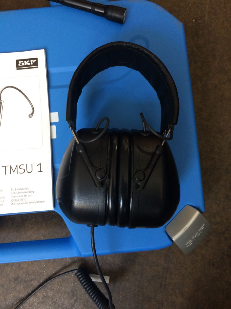

        img_1776.jpgimg_1775.jpgHi.
        At work we used an ultrasonic leak detector. Our compressor room if extremely noisy with 7 large oil free 2 stage compressors screaming away. It comes with noise cancelling ear defenders which connect to the detector.
        The detector itself has some sort of crystal in the end which becomes "excited" when in contact with an air leak. This the actually gives you a totally individual sound of each leak. You can even get a rough idea of the size of the leak, it sounds that good. It will also guide you to the leak if your in the rough area, as the crystal becomes more excited you will hear the leak becoming more intense.
        I'm NOT connected to this manufacture in anyway, its just a useful piece of kit we use. I'd imagine that you would have to take all the panels off anyway to attach a "meter" of some sort.
        We've found loads of leaks all over our site, ones that you wouldn't hear or feel before. Hope this helps.

              Ben how much roughly is that skf gadget?
              #202534
              Ben Spicer
                @benspicer30986
                Hi Ian,
                The SKF detector is about £900 +VAT from what I can see online. There might be a newer one out now or something but that's the price that's online. I wouldn't want to drop it .
                Ben.
