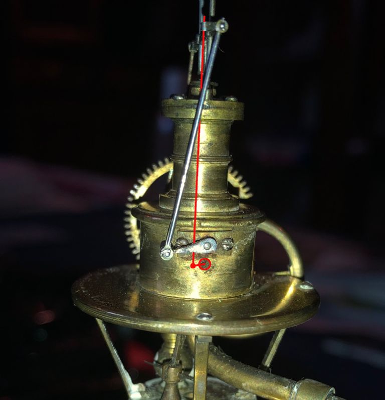

          Now there's no evidence of a coaxial crank I've gone off the idea in favour of this suggestion:
          The missing 'needle eccentric' connected via the notch and behind the crank to a lever mounted in that mysterious hole.
          The needle might have been ornamental, adding to the interest of the engine with more movement. Inside the engine is a dual valve that controls when steam is admitted to push the piston whilst at the same time allowing the other side to exhaust. The engine won't run without a properly timed valve. If the engine runs without the needle, the real valve gear must be inside. Might be helpful – an ornamental needle waggling a fake lever is easily replaced.
          I'd be very wary of stripping it down. I wonder is a friendly vet would x-ray it for you?
          Difficult to value, it's an attractive antique with engine collector appeal. I've seen much more basic model engines with £800 price tags.
          Given what you've found about Richard Westerman, I think he made this item for display in his shop and at exhibitions. It shows he was skilled, imaginative and capable of attractive work in miniature. That chuffing away would have made him more interesting and memorable than other clock-makers – good advertising.

                The illustration that SOD has made with his red line, is the sort of idea I had in one of my earlier posts.

                    Posted by Nicholas Farr on 21/05/2019 09:24:39:
                    Regards Nick.
                    Apologies Nick, I should have given you full credit because it was your idea I'd picked up on. I typed "this suggestion" instead of "Nick's suggestion", my bad.
                    My contribution was the clarifying picture and the suggestion that needle and lever may be ornamental.

                        Posted by SillyOldDuffer on 20/05/2019 11:54:39:
                        I'm not convinced on this exact set-up, but rather something similar but different, for several reasons. One being that the stroke of the cross-head is significantly longer than allowed by the small crank in red. In fact it would be the same dimension as the main crank, which obviously would clang into the main crankshaft. The other being that there is no facility for the "needle" to pivot at the top, as would be required in a crank and rod type situation. The notch in the brass flange where the needle would run tends also to indicate it does not move from side to side.
                        I'm thinking there must have been something that allowed the "needle" to move straight up and down. So something more like a pushrod pushing a lever, in effect a rocker arm, without the two being firmly joined. Or perhaps a short crank arm as shown in red but the pushrod passing though a loose hole in the end of it, with two collars on the pushrod that allow it to move the crank arm a short distance at the end of each stroke, but slide through without moving the crank until the other end of the stroke. You thus have a lost-motion linkage in effect. So it provides a sort of "switching" motion at TDC and BDC rather than a continous cranking motion. This would be consistent with switching the valves from open to closed and vice versa at the end of each stroke, as required for a single-acting cylinder.
                        Just a thought.

                              Posted by Hopper on 22/05/2019 08:22:46:
                              Just a thought.
                              I like it!
                              It's true the crank suggestion isn't convincing. A reason I suggested ornamental was because I can't imagine how a crank would communicate sensibly with whatever valve is inside. (Might be because I don't know enough about valve gear and there is a simple solution!) And ornamental doesn't fit well with the maker going to the trouble of drilling that large hole – surely it has purpose.
                              Hopper's suggestion of a mostly up down movement using collars to flip the valve is much better than any of my over-complicated musings. Something like the valve trip arrangement on James Watt's early engines perhaps. I'd love to know what's inside!

                                  Posted by SillyOldDuffer on 22/05/2019 09:16:55:…
                                  …Something like the valve trip arrangement on James Watt's early engines perhaps. I'd love to know what's inside!
                                  I'm thinking some kind of simple (yet cunning) rotary valve. Something like a piece of round bar inside a hole drilled in a solid block. The block has two small ports drilled right through it, each port connects to the cylinder above. Below, one port to the steam inlet pipe, the other to the exhaust. Two small holes drilled crossways through the round bar, at 90 degrees to each other, would allow through-flow through one port at a time. The round bar is rotated through 90 degrees by the "needle" and crank arm at the end of each stroke.
                                  Or offset the ports slightly and file flats on the round bar to give finely tuneable valve timing and perhaps less than 90 degrees of rotation needed to make it work. My mental CAD abilities end about there. I need the back of a fag packet and a burnt match to take the concept any further.
