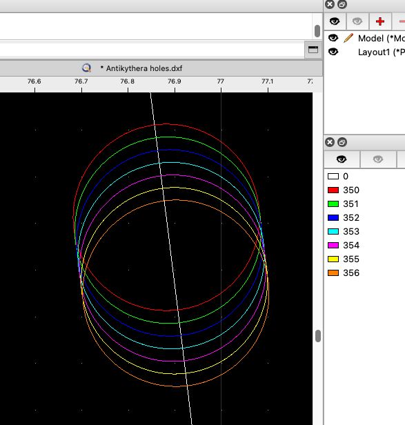

          Posted by Michael Gilligan on 26/11/2022 08:30:50:
          Whilst those Euclidean techniques are ‘philosophically’ entirely valid … the practical difficulty of physically doing it for a large number of holes would be immense [i.e. nearing impossible]
          A couple of pages back [16-Nov-2021] I mentioned that I had been doing an exercise in QCAD
          … I will, later today, post what I think is a convincing ‘reality check’ on the practicality of that approach to the dividing.
          As promised …
          I prepared this little sketch when we were attempting to ‘reverse engineer’ the number of holes in the full circle, from the segment remaining.
          It was sufficient to convince me that it is impossible to do that with confidence.
          With a starting point of Hole_0 … at which the first hole for every circle would be co-located
          … this is a screenshot of the Hole_7 cluster, showing the position of the seventh hole on each circle.
          It also illustrates the difficulty that would be faced when setting-out the holes ‘by chords’ or even by the use of Hopper’s long arm … the positional tolerance at the hole is tiny.
          Simple in CAD … Difficult to execute by marking-out and drilling.

                        Posted by Michael Gilligan on 26/11/2022 15:33:41:
                        I forgot to explicitly mention [although there is a scale visible]
                        Those holes are 0.4mm diameter

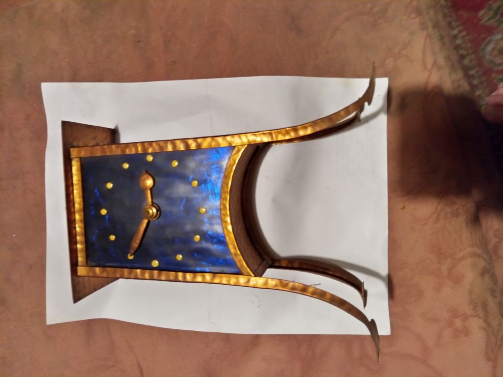

                              img_20221126_173930_4.jpgHere is a very simple example of using a geared pointer for positioning. The enamel paint markings were indicated on stained glass by simply winding round the minute hand after putting on the 12 o'clock dot with a paint brush. (sorry its sideways)
                              dave8
