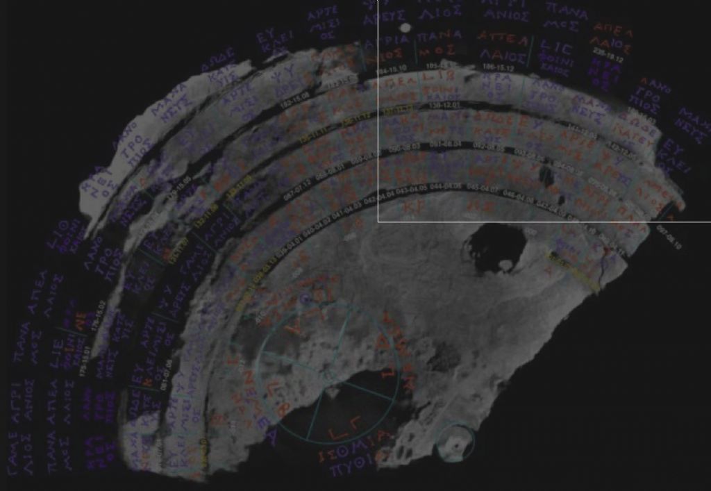

          John McNamara
            @johnmcnamara74883
            Good find Michael G
            From the first Scientific American link you posted.
            If this image is from the Antikythera find it appears to show a larger fragment. Maybe it is an assembly of found pieces? However even if it is it may enable a more precise centre point to be derived, Even if just a "feature" arc is used if the holes are not visible. it might improve the accuracy of the calculations for the hole circle. By knowing the radius of a feature arc and then measuring the distance from the feature arc to the hole circle arc, a more accurate radius for the hole circle might be obtained. I firmly believe that the mechanism was accurately made with true concentric circles.
            Maybe there is a better copy of this image available?
            Slideshow Link
            Regards

                John,I too believe the dials were made truly circular, but when they were broken, distortion of their circularity is likely due to the release of locked in stresses. A cast bronze ring, possibly quenched, probably hammered to harden and refine the structure, then machined, would have severe internal stess. 350+ holes in the calendar ring backing plate would add to it. When such a ring is broken, the apparent original center would be in doubt. (I cannot find any data relating to this stress release distortion) ( then there's the problem of centuries of sea-water corrosion)
                dave8
