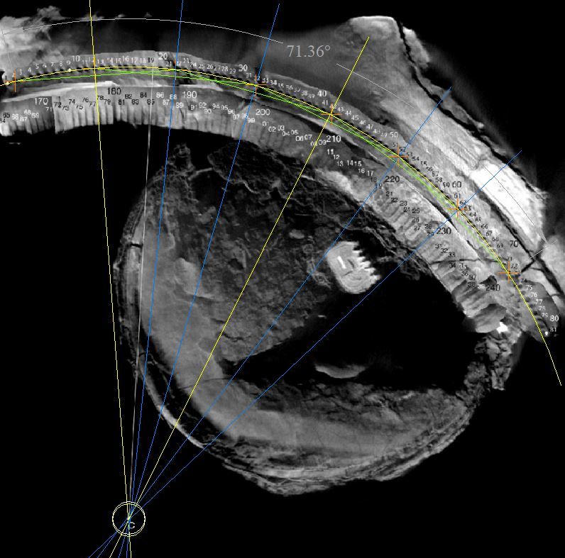

      Some preliminary results from a least squares fit to the largest sector gives an interesting answer. John Kinsella, a whizz with MATLAB, did a least squares fit to find the centre (xc, yc) and radius (R) of the 37 holes (xi,yi) in sector S3. I downloaded the measurements used in the BHI paper from
      https://dataverse.harvard.edu/file.xhtml?persistentId=doi:10.7910/DVN/VJGLVS/WIQJHP&version=3.0
      John used a gradient method (Gauss-Newton) to minimise the sum of the squares of (xi -xc)^2+(yi-yc)^2-R^2 wrt xc, yc & R.
      Results using optimal xc, yc, R:
      mean of angles in degrees: 1.00577.
      St dev of angles in degrees: 0.0929292.
      R: 77.3073
      To me that look like 360 holes round the circumference. The SD (variance) is quite large which reflects the imperfect marking out and drilling the holes.
      We need to do a bit more works testing these results against the other sectors.

            I think that a Bayesian approach would be better – look at the possible number of holes which could be one of the set of likely candidates such as (but not restricted to); 354 Athenian#, 360 Babylonian&Egyptian, 365 solar, 366 sidereal (assuming it's related to an annual cycle or some sort), assign some prior probability to each and see how the evidence changes these probabilities.

              A correction to the S3 results; number of holes 357.8
              The next largest sector S1; number of holes 360.7
              Sector S1
              xc: 80.1557 yc: 136.902 R: 78.5604.
              mean of angles in degrees using least sqs est of xc, yc, & R: 0.998133.
              St dev of angles in degrees: 0.0810382
              I think it's clear the results from this approach show the BHI estimate is too low.

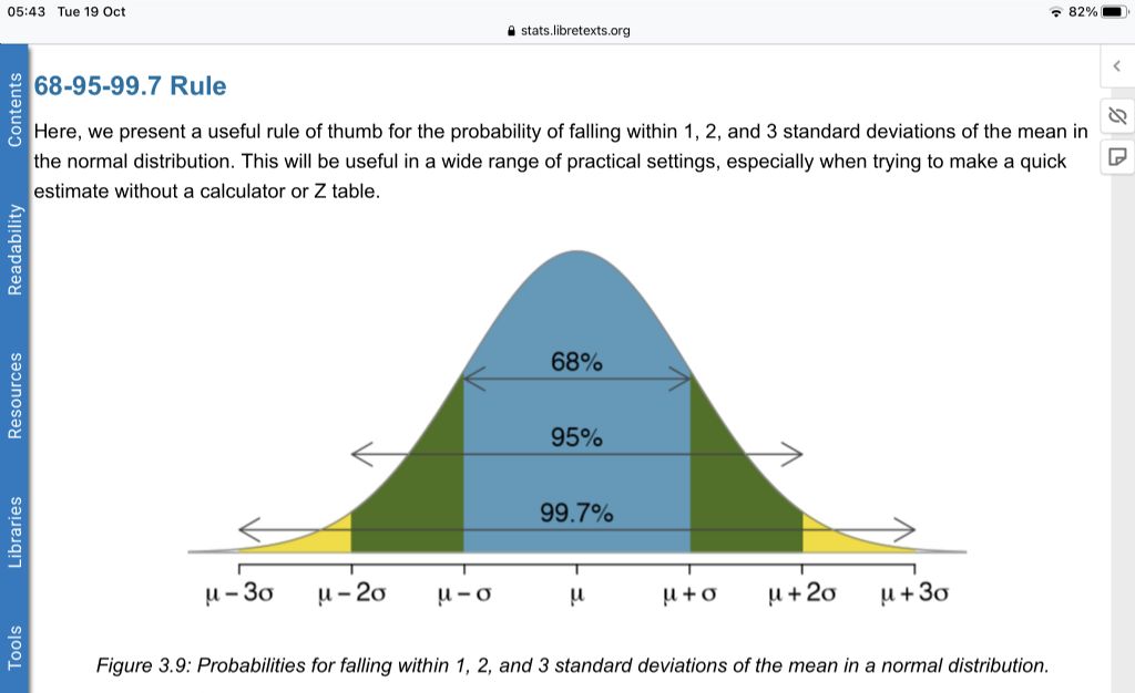

                For those whose Statistical expertise is as rusty as mine; this is a convenient aide memoire:
                **LINK**
                https://stats.libretexts.org/Bookshelves/Introductory_Statistics/Book%3A_OpenIntro_Statistics_(Diez_et_al)./03%3A_Distributions_of_Random_Variables/3.01%3A_Normal_Distribution
                Plug-in David’s values for Mean[s] and Standard Deviation[s] and the difficulty becomes apparent.
                I maintain that the data-set is not sufficiently robust for a confident estimate of the number of holes in the full circle.

                      The standard statistical analysis for estimating the population mean from a sample is;
                      The mean error can be assumed to be zero. The sample SD can be used as to estimate population SD. The standard error of the sample mean with a sample size n is SE=SD/SQRT(n-1)
                      Plug in the numbers for S3;
                      sample stats; mean=1.00577, sample SD=0.0929292, n=37
                      SE=0.0929292/SQR(36)=0.015.
                      With this sample the confidence limits for the true hole spacing is; sample mean+/-1.96SE=1.00577+/- 1.96*0.015= 1.00577+/-0.03 degrees
                      We are confident, at the 95% level, that the true inter-hole angle lies between 0.97577 (N=348) to 1.03577(N=369) which as Michael wrote doesn't tell us much!
                      This ignores the fact that the true mean is not a random continuous variable but is discrete and restricted to plausible values.

                                              I used the least squares best fit of the hole position data, available from the Harvard website quoted in the BHI paper, for S1, S2 and S3 to fit the points on a circle and I assigned a probability of the true value of N for N=354, 355, 360, 365 & 366 at 0.13 and 0.01 for all other N (for N from 331 to 370). I ignored the other sectors as the number of point was quite small
                                              The analysis modified these prior probabilities by the information obtained from the three sectors using Bayes formula.
                                              N posterior probability
                                              354 0.257
                                              355 0.304
                                              360 0.223
                                              365 0.028
                                              366 0.015
                                              The probabilities for other values of N are less than their initial values.
                                              The obvious conclusion I'd draw from these calculations is that a solar period of 365/366 is highly unlikely but the other three are more or less equal contenders for the true value for N.
                                              I need to modify the least squares fit to force the radii for each sector to be the same. The initial analysis gave different radii which may or may not influence the results I obtained.
