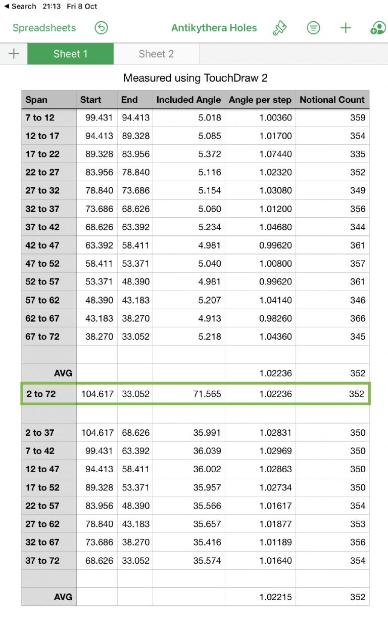

      As promised; here is my updated spreadsheet :
      It uses the same raw measurements, but I have manipulated the data a little more …
      Angle per step is now presented to five decimal places … not because it is realistic to do so, but because it highlights the tiny differences.
      Notional Count is now presented to the nearest integer value, because that makes more sense in the context.
      I have added a row for AVG of the values in the 13 data rows … the fact that these match the values computed for the 70 hole span is hardly a surprise; but it’s a useful check on the formulæ.
      I have then added a further 8 data rows, each for a span of 35 holes
      … and another AVG row for those 8 rows.
      The results are, I think, pretty clear :
      1. Based on my measurements ; the most likely count for the complete ring would be 352
      2. The counts predicted from small groups of holes vary enormously !
      3. [because] The predicted count changes dramatically with a tiny change in Angle per step
      4. Obviously, more holes in the span averages-out placement errors and gives more reliable estimates.
      Please … Would someone else repeat my exercise [or some reasonable variation upon the theme], so that we can compare results.

        An alternative method would be to use a least squares to fit the 50+ data points to a circle or ellipse. This will give the centre coordinates and radius/radii for a circle or ellipse. If an ellipse gives the better fit then it's likely the x-ray image was oblique view. Once the best fit circle/ellipse is known then finding the number/position of holes that best fits the observations should be relatively straightforward again by using a least squares fit.
        It should be possible to combine the two stages into one but I'd need to think about it.
        There are numerous articles on least squares fit of data to a circle/ellipse which can easily found via Google.

          Thanks for the comments, David
          … If you can do it, I will be very interested and most impressed.
          I am no expert in statistics, but it seems to me that the available data have too much variance for such a ‘fit’ to be credible … but I am happy to be proved wrong.

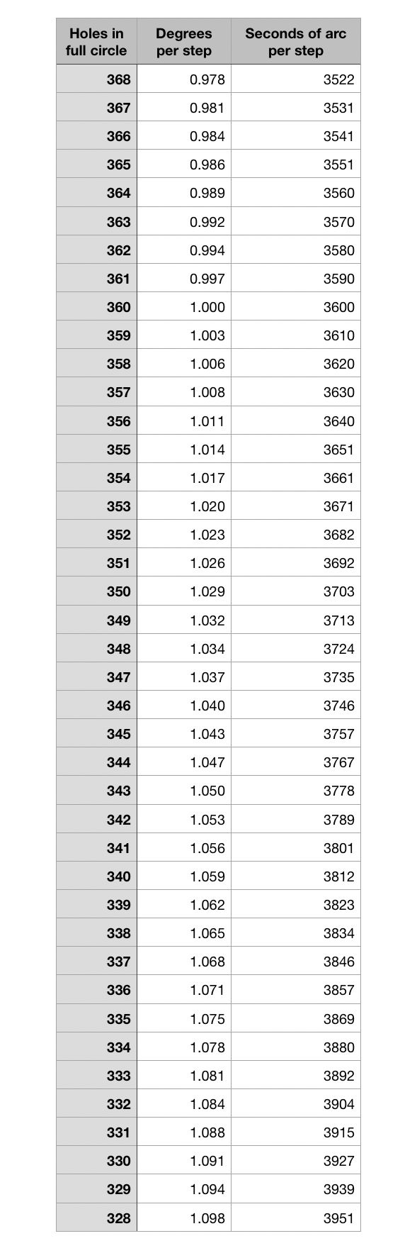

              There is nothing clever about this tabulation, but it might illustrate the scale of the problem:
              It assumes equispaced holes on a pitch circle, and it makes clear that accurately estimating the number of holes in the circle [from a fragment thereof] demands implausibly accurate measurement of the image.

                  Posted by Michael Gilligan on 08/10/2021 21:51:37:
                  Many sources of error in this ancient mechanism make it difficult to be certain about anything, but I think Michael has shown conclusively that there aren't 365 holes. Therefore the dial can't be indexing earth days. It is however a good match to the moon. And although we today are used to a solar calendar, the ancients went lunar. The Islamic Calendar is still lunar.
                  So although Michael's results don't prove the ring is lunar, they are consistent with the suggestion. The lunar hypothesis is strengthened rather than weakened by Michael's analysis, but nothing is solid yet.

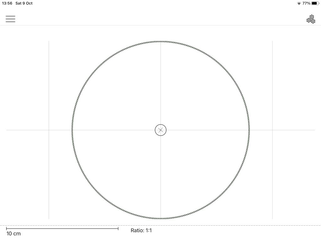

                        Here’s another little ‘sanity check’ …
                        It was easier for me to generate a ‘gear’ … but this is about the scale of that task:

                                Although Dave has moved this to a problem of placing 352 holes … The real [Antikythera] issue is estimating the number of holes in a circle, based on a relatively small sample thereof.
                                The level of accuracy required to do that prediction successfully, to the nearest integer value, is astonishing.
                                From my table … if 352 is the right answer: we can only get it if we know the angle per step is greater than 1.020° and less than 1.026°
                                As I am sure you will realise … this is a VERY small tolerance.

                                                A quick calculation :
                                                Radius 77.493
                                                resolution of inter-hole measurement 0.01mm
                                                0.01 ÷ 77.493 = 0.00012904391364
                                                atan (0.00012904391364) = 0.0073936716
                                                So each 0.01mm of their inter-hole measurement represents more than 0.007° of angle.
                                                Now look back at my tabulation of hole counts.
                                                dont know MichaelG.
