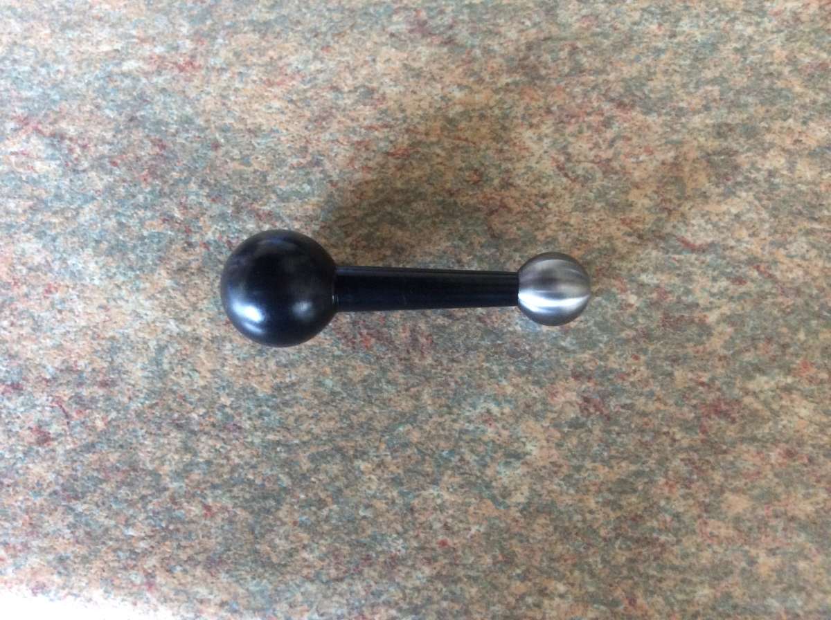

                          bernard towers
                            @bernardtowers37738
                            One thing to be aware of is that the blacking I use does not like steels that contain chromium!!!!IMG_0824
