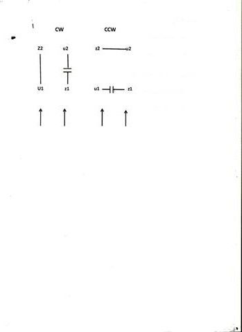

      Hi.
      I have a small (1/8HP) capacitor start capacitor run motor which I have fitted to my (nearly) completed Bonelle T & C grinder.
      At the moment I have it wired through two DPST switches, one for CW/CCW and the other for ON/OFF.
      What I really want to do is to have just one DPDT ( centre off ) switch wired to the motor.
      Below is the connections shown on the terminal lid
      Thank you
      Ian

        Les Jones 1
          @lesjones1
          Hi Ian,
          Are you sure that both of the existing switches are DPST ? I cannot think of a way the motor could be reversed without a DPDT switch. I think to achive what you want you would need at least a 3 pole double throw switch. Your picture of the connections did not appear. Are you having a problem with the strange way used to insert pictures into this forum ?

          frank brown
            @frankbrown22225
            No connection diagram. I do not think you have enough connections for what you want. To reverse the motor, you have to reverse the L and N connections to the start circuit (motor winding plus start capacitor in series), so this will use 2 poles (L&N) to start circuit (say R & B and B & R). But you have not got another pole to break the L to the run winding .
            One way of doing it would be to get a relay with a coil that works on the mains voltage and wire it across the start circuit. and wire its contacts between the L and the run coil of the motor. So when the CW/CWW switch is in the centre, no supply to the start, relay is then off and no supply to run windings. If the CW/CWW switch is moved , mains goes on start winding and relay coil, relay pulls in and mains goes on the run winding.

            #178053
            ianj
              @ians
              Hi. Sorry about the missing picture. Here it is ?
              Les. Yes both switches are DPST . I can't remember how I did !! I will go & have a look now.

              #178054
              ianj
                @ians
                Les.
                Your dead right the ON/OFF switch is DPST and the CW/CCW is DPDT ( not centre off). Sorry for the confusion.

                              ianj
                                @ians
                                Les.
                                Just been and checked. My original diagram is incorrect. The mains IN for the CCW direction is across U1 & U2.
                                You are right in that the cap. is disconnected from U2 & is switched to U2 (CW) or U1(CCW)
                                U1-U2 20 ohms
                                Z1-Z2 55 ohms

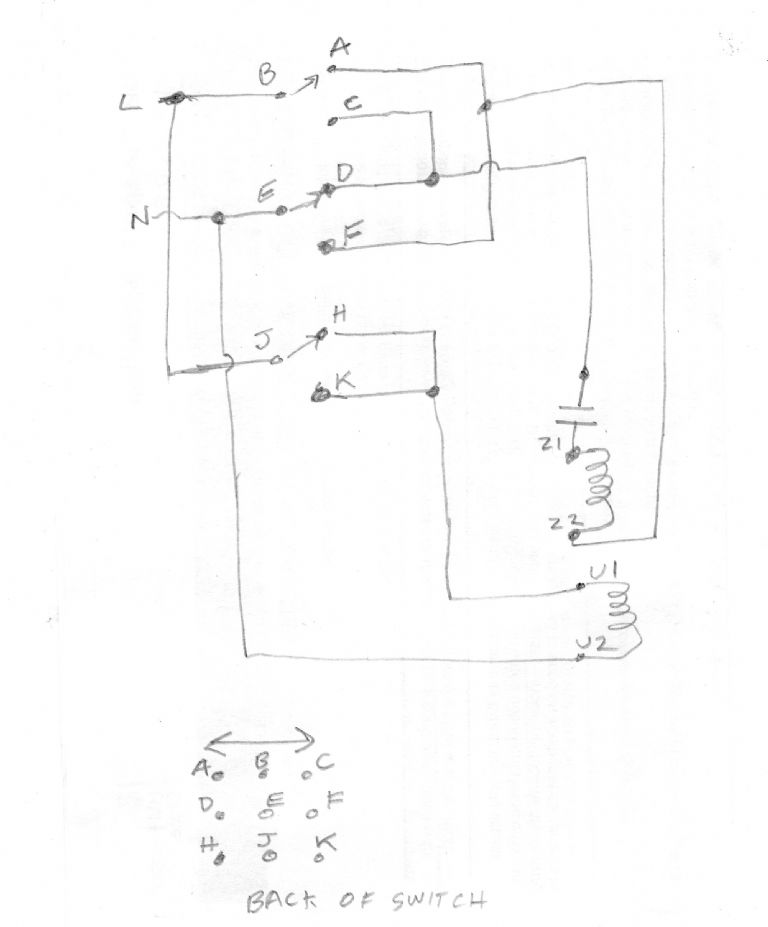

                                  Les Jones 1
                                    @lesjones1
                                    Hi Ian,
                                    It looks like I guessed the wrong way which was the main winding. Here is the way I suggest connecting the switch.
                                    The diagram of the back of the switch is with the lever moving horizontaly. The letters are just to tie up with the schematic. They will not tie up with any labeling that may be on the switch. (It does not matter if the switch is turned through 180 Deg. If you decide to use the 4 pole swtch from Arc Euro you could also switch the neutral to the main windin with the extra set of contacts.

                                    #178101
                                    ianj
                                      @ians
                                      Thanks for that Les.
                                      I've ordered two switches from Proto-pic for less than £7 inclusive of postage.
                                      Ian

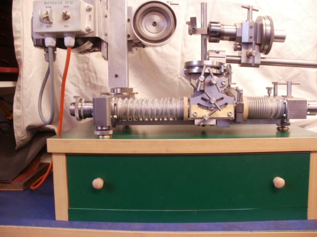

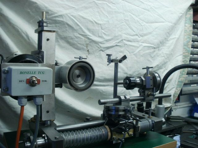

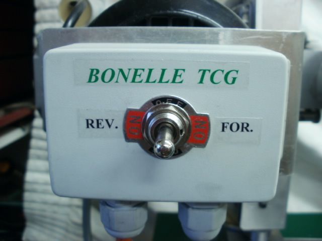

                                      #178334
                                      ianj
                                        @ians
                                        p2031359.jpgHi.
                                        Just thought I would update you. The switches arrived this lunch time. I wired one up as to Les's diagram & it works just fine.
                                        Thanks Les very much for your help & others for their suggestions.
                                        PS Looking at the photo I need to level the ON OFF ON plate!!

                                        #178347
                                        John Haine
                                          @johnhaine32865
                                          Looks nice. Just as a matter of interest, which vacuum cleaner brand hose are you using to protect the front rail, and what sort of expansion ratio do you get please? Interested in using similar for when I fit a ballscrew to my lathe.
                                          #178351
                                          ianj
                                            @ians
                                            John.
                                            I spent a lot of time looking for suitable bellows with out much success, I did get one quote of over £80 for two bespoke 6" extended length latex rubber ones. But !!
                                            So for the time been I'm using the hose off a Dyson vac. It's 1.75 " o/s diameter, 12" extended compresses down to 2.75". I got mine free from a local vac. repair shop or you see loads down the council recycling centres.
