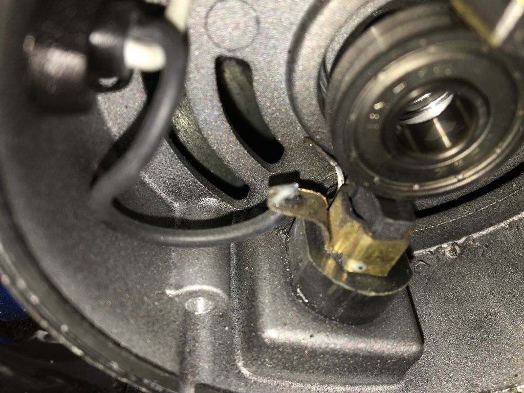

              #585652
              Philip Coupland 3
                @philipcoupland3
                I’m very grateful for all the helpful contributions made – thank you gentlemen.
                I made further investigations this evening and found a possible cause – a curly piece of swarf, which had got in the back of the motor and was making a contact between one of the brushes and the casing of the motor. Happily the motor seems to be still in working order and spins happily with a 12V DC supply. Once this electrical problem is resolved I’m going to ensure that the motor is properly separated from such nasties. Incidentally, I wonder if there is any benefit from adding a fuse in-line with the positive supply wire to the motor – would that prevent this happening again?
                The plan at them moment will be to try out the replacement resistor when it arrives. If that doesn’t work I shall probably have to buy either a replacement board or I may buy a complete control box (Amadeal) as its not a huge amount more and will avoid any problems with wiring in a board that may have different connections to mine.

                  #585654
                  Philip Coupland 3
                    @philipcoupland3
                    The suspected culprit – next to the bearing

                                Philip Coupland 3
                                  @philipcoupland3
                                  An update.
                                  The replacement KB Electronics horsepower resistor that I ordered yesterday from the helpful and efficient Axis Controls of Southport arrived this morning and I fitted it this evening.
                                  I’d checked the motor for any more shorts and tested the board first just connected to a voltmeter. When powered up, turning the potentiometer caused the voltage to increase and then when I connected the motor (detached from the lathe) that also speeded up to a high rate in response to the control.
                                  However, we are not quite there yet. When the motor was reinstalled and the drive belt fitted, I found that it would not speed up more than a little. It will certainly be encountering some more resistance than previously because of the new roller bearings fitted and perhaps the new metal high-low gears that I’ve replaced the plastic ones with. But the bearings haven’t been over loaded.
                                  What I’m wondering is whether this is something that can be resolved by an adjustment on the circuit board or does it indicate that there are further electronic components that require replacement?
                                  Once again, thanks to all who’ve contributed to this thread.
