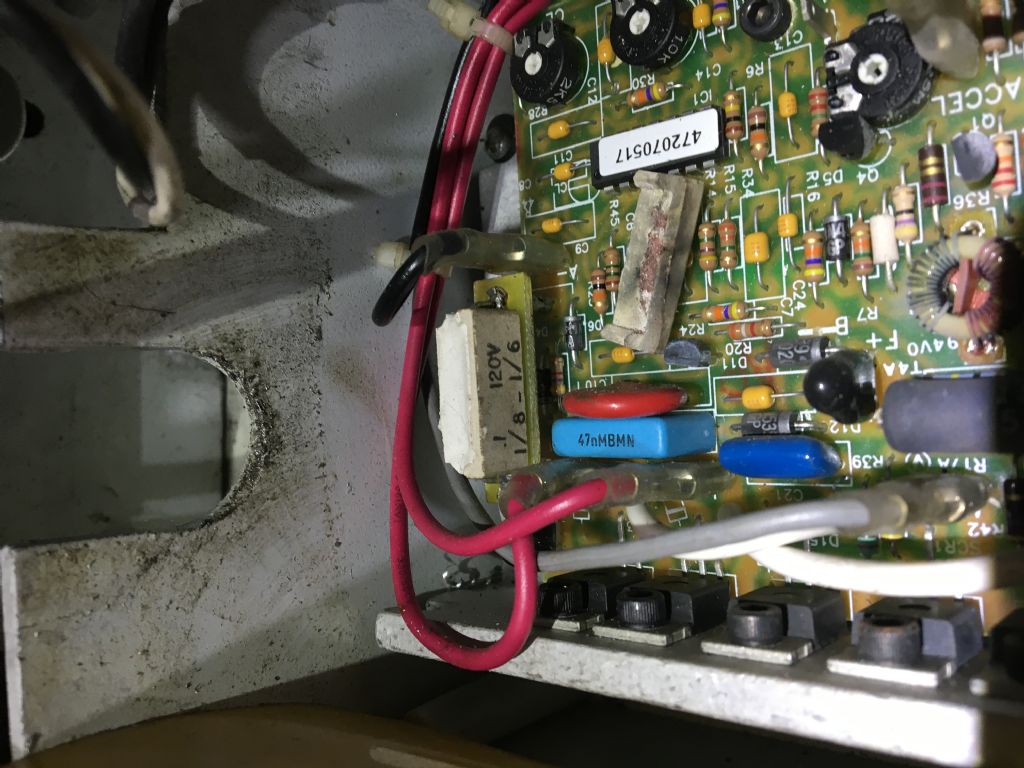

      To briefly introduce myself, I’m hobbyist whose metal work interests are mainly related to motorcycles. My tiny workshop is crammed with many machine tools, including the lathe that is the cause of this request for help.
      I have recently added roller bearings to the headstock and wanted to test the running of the drive belt so plugged it in but on turning the machine on there was a flash and a pop and that was that. On closer inspection inside the control box it was found that a large rectangular component marked 120V had the back blown off. I don’t know what this component is, my knowledge of electronics having stalled at the battery and bulb stage.
      I hadn’t touched the electronics at all, merely unscrewed the control box and moved it to one side, leaving everything connected apart from the two earth wires going to the headstock, which I had reconnected.
      I’m wondering if I could replace blown component (assuming I can identify it and find one) or is it likely that a whole lot of other stuff is gone. I’m also concerned to find out what’s caused the problem – if I end up spending a fail amount of cash on a new circuit board I don’t want to ruin it as well.
      With thanks, Philip C

                Here is the smoking wreckage below – the broken off piece came off the back of the rectangular white component.
                One question occurs to me to ask is why is so much electronics necessary to control the speed of an electric motor? For example, an electric drill usually has the facility to control its speed without all this.

                  There is a picture of the board in the OPs album. It's a rather odd component, apparently on its own PCB. It's definitely flipped its lid. Looks a bit like a power resistor, but why 120V? Alternatively it could be a MOV. It would help to know if the OP is in the UK or the US?

                          I think the component WAS a ceramic resistor that is used to sense the motor current. I think the output connections to the motor must have been shorted out putting the full rectified mains voltage across it to cause it to fail in the way it has.
                          I think the board is a KBLC speed controller board and the resistor that has failed is R21.

                            That blown component is likely a symptom, not the problem…Something else failing would have caused that component to fry. I just looked at the control board for my own mini-lathe and it also has one power resistor like yours (which is probably what yours is). Diagnosing and fixing this is going to require someone with electronics experience, and equipment, though. I'd help you out if you were near me, but…you're not.
                            Looking at the back of the board may give clues for other fried components. Also, looking at the top side carefully. Capacitors are common culprits in switching circuits, as cheap Chinese ones eventually fail (although mine haven't) and this causes further components down the line to fail. But, again, this would require testing.
                            You might get lucky posting on the groups.io minilathe group…Perhaps someone had the same thing happen and found the bad component. But my guess is that you're going to wind up buying a new control board.

                                      The control board looks like a KB Electronics AC to DC motor variable speed control.
                                      The white rectangular block is a horse power restrictor The component that was damaged was probably fitted for some reason piggy back in parallel to the hp resistor.

                                          On the photo is that a piece of curly swarf just under the resister framed by the red wires?

                                            Hello Ian, well spotted! Despite my efforts to keep the workshop tidy all manner of swarf, splinters, chippings gets everywhere. It's a very small space and bits go everywhere.
                                            Later today, I'm going to thoroughly check the output to the motor for shorts – it would be a relief to find one and know the cause of the problem.

                                              That definitely looks like a power resistor to me. I suspect it is mounted above the main PCB because it gets HOT in normal operation. It would have blown up if subjected to excessive current caused by a short circuit. Did you trap the motor wires when you re-assembled everything? Well worth a try replacing the resistor before splashing out on a new control PCB.

                                                Thank you OldVelo. With your information, I've identified the blown part as a 'plug-in horsepower resistor (9838)' from KB Electronics. These are available in the US although the cost of shipping and import tax seems excessive. I'll see if I can find them in the UK.

                                                    I use a genuine KB controller on my CNC little mill and it has never given any problems even after the cutter was driven hard into the work, which just blew a fuse. On the other hand the "KB" controllers fitted to mini lathes etc seem to be very vulnerable. I suspect they are approximate but substandard copies of the real thing. A proper KB replacement could be more expensive but a good investment.
                                                    These sense resistors go in series with the motor and need to be matched to the motor power, which is why it's a plug-in component (though it probably gets hot too). I think these controllers keep the motor speed approximately constant by having in effect a negative output resistance which cancels out the motor's internal rotor resistance, so that the armature voltage is a good indication of speed. This resistor trims the output impedance by adding a small positive value to match the motor. The fact that it has blown up shows that it probably did have full mains voltage across it – since this could only come via the control semiconductors it's quite likely they have blown up too.
