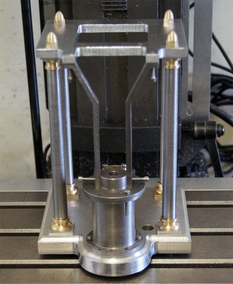

      With the columns finished I assembled some of the parts to see how things were looking, seems to be going together well enough, pleased with it so far.

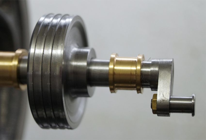

        Turned the steel pulley this morning, I dont know what spec the steel is but remember getting it out of the offcuts bin at a machine shop I visited. Probably the nicest steel to machine that I have had to date, excellent to part off also.

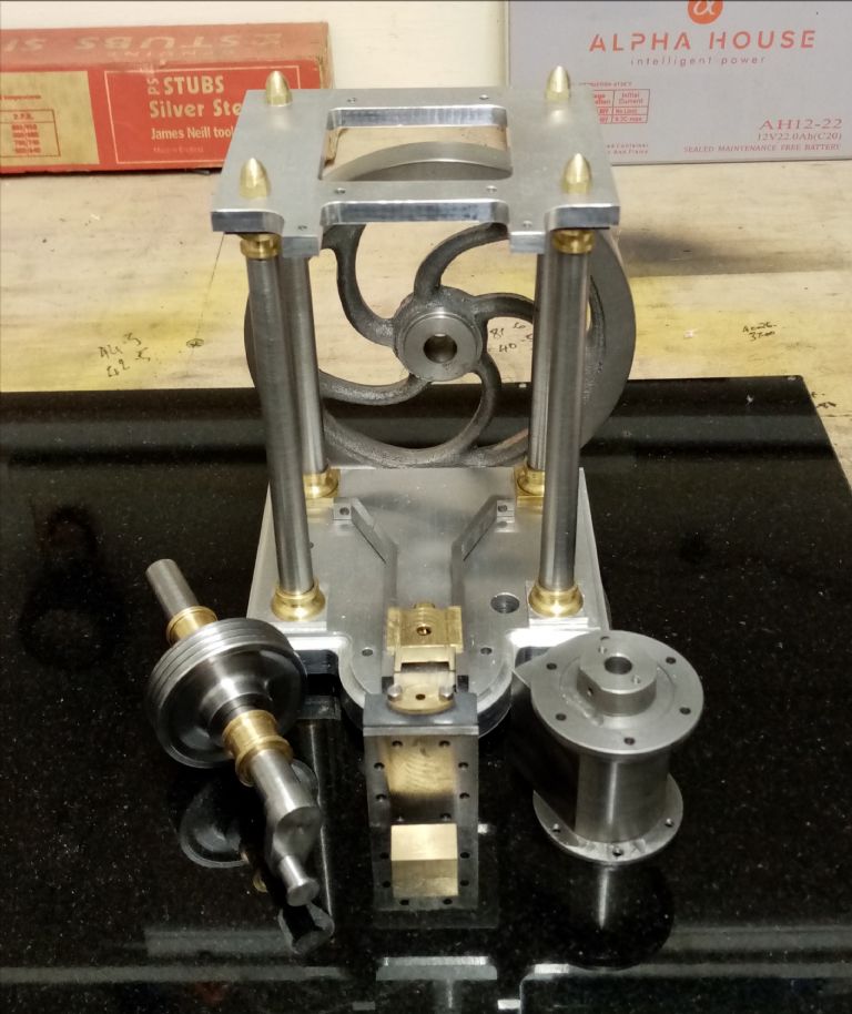

                        Well the antibiotics cleared the infection but I,m still somewhat restricted my foot still has some swelling and I can only stand for about half an hour. There is only so much you can do sitting down so work on the lathe and mill has to be done in stages which is frustrating.
                        Anyway enough of my woes I took a pic of the parts made so far to give myself some encouragement (hopefully) smiley

                          20200606_103857.jpgIt's all looking good Ron, noted the Stubbs silver steel in the back ground, that jogged my memory and just ordered some Stubbs silver steel but I think it's made under another name.

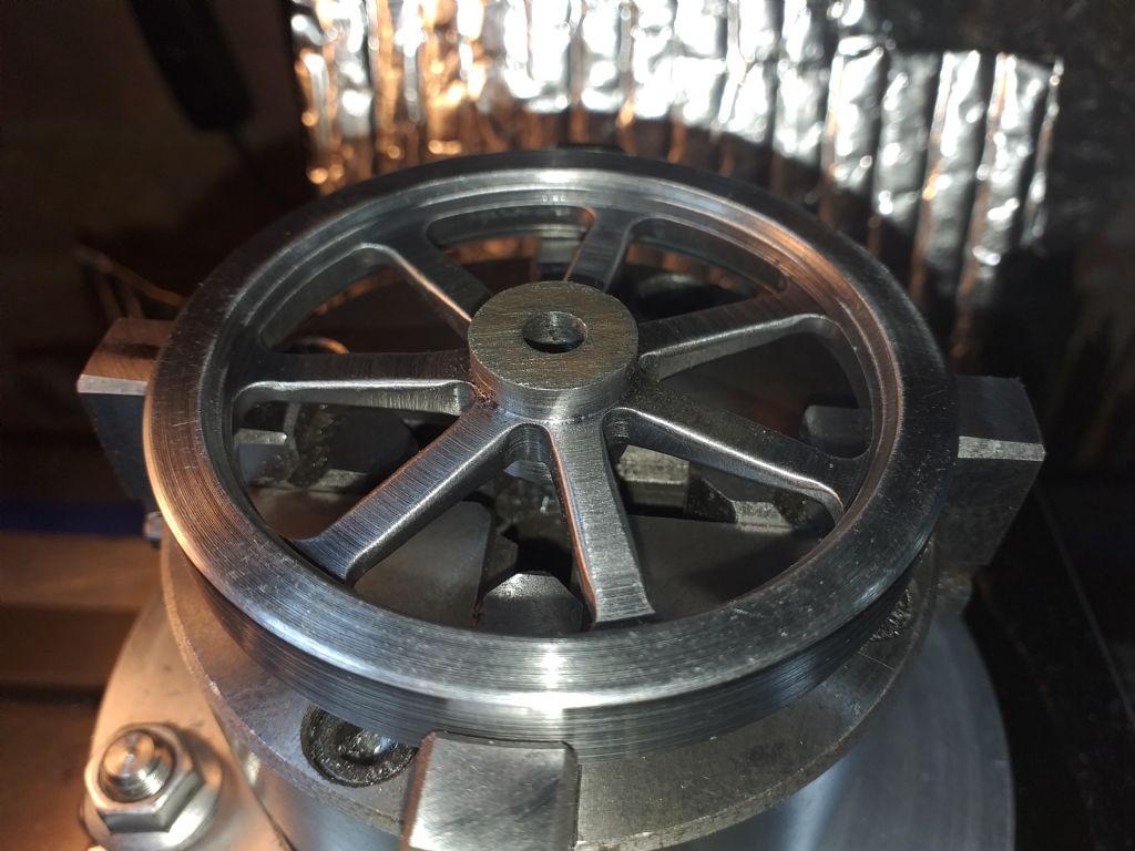

                          Your flywheel wheel sets it off, I made one last week on my new rotary table, it took me at least twenty hours, so slow double checking I wasn't making a mistake, everything but came off a 9mm x 500mm x100mm blank, it would have been quicker marking it out than using the table.
                          Have you found your caliper gauge on the lathe helpful.

                            Well done Bob your flywheel looks good, its something I have thought about making on the R/T but havnt tried as yet.

                              I found it's easy to make a mistake especially if you get distracted I don't have the confidence to slot drill from the start, I centre drilled a small mark on a complete 360 deg to check that all lines up. My r/t has a tight spot for a1/3rd of a turn so I going to have a look to see if this can be adjusted.

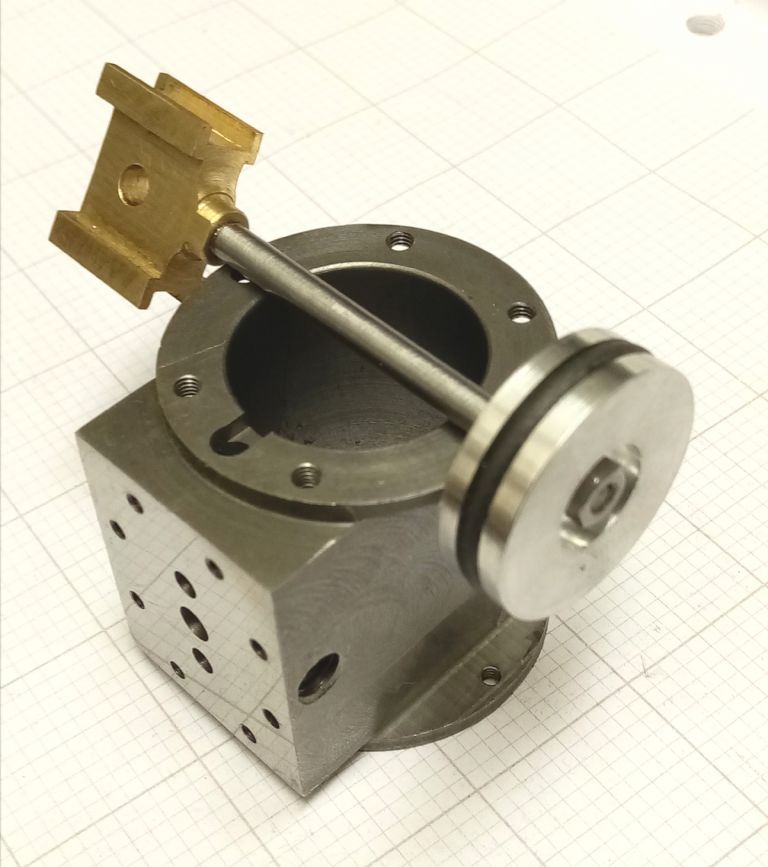

                                    Well back on the ranch, I honed the cylinder this morning and made the piston and rod. I fitted the O ring, a drop of oil and it seems to be a nice fit, should run OK.

                                      I like the way you have fitted the piston, never seen that before.
                                      Assume you threaded the end of the rod and through the piston and the nut is a lock nut.
                                      I just threaded mine tightened it but it still came loose!!!!!
                                      Your method noted for future engine

                                        ……..and them o rings are great, good compression.
                                        Tricky to fit but worth the effort

                                          Hi Geoff, not my idea re fitting the piston to the rod it's as per Jason's drawings and build notes, seems a good idea to me though.

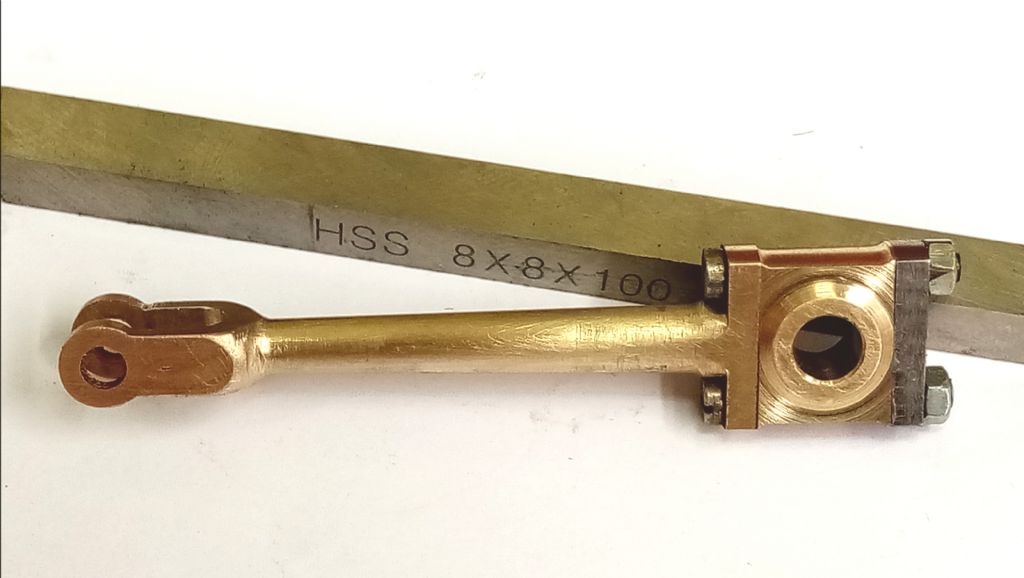

                                            So good to have the lathe back up and running so made a start on the conrod, going with brass.
