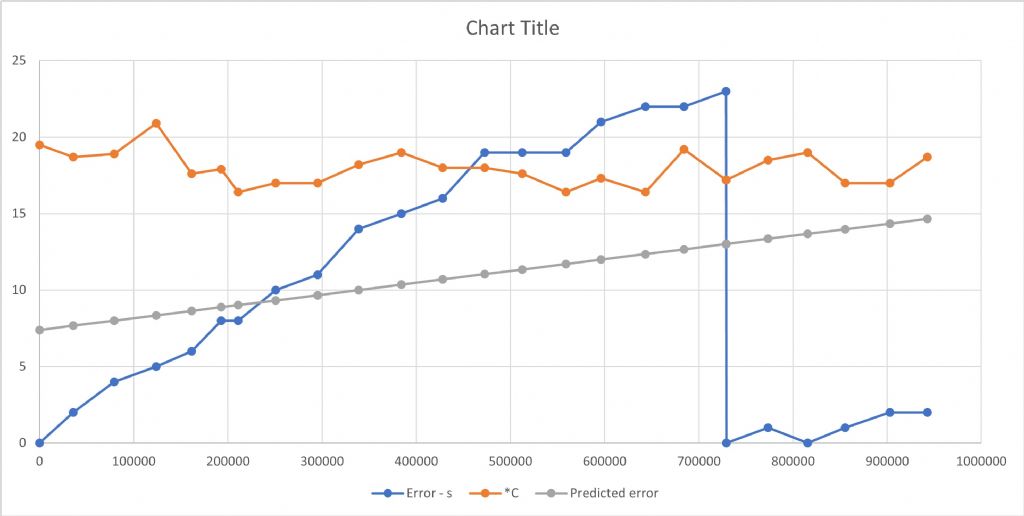

      Posted by Michael Gilligan on 04/12/2020 17:38:50:
      Looking good, John
      … any idea what caused those two anomalous bumps ?
      Another cause I should have mentioned is the corrections applied by the Arduino, which nominally allow the clock to get a second ahead and then skip a second. The photos are taken asynchronously to this so it introduces another apparent observation error. My goal is to have the clock being within a second or two of real time without adjustments over a long period.

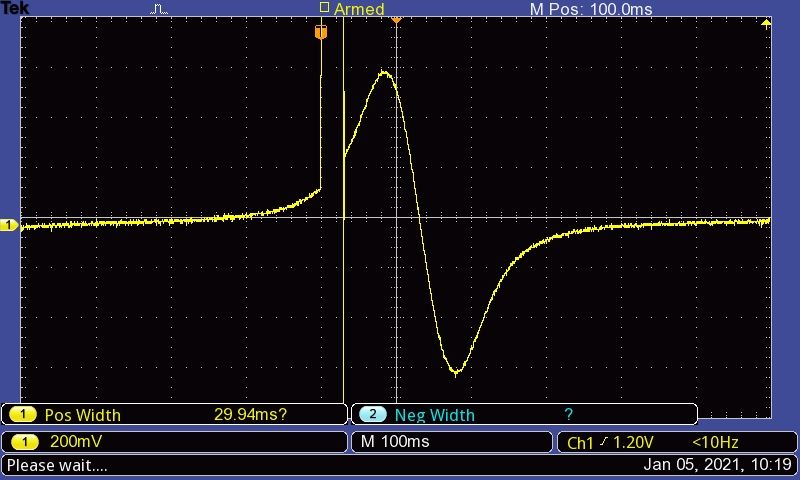

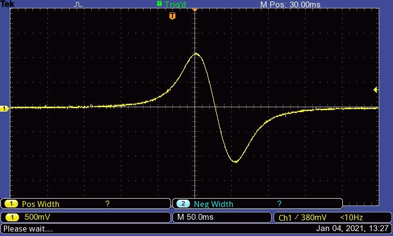

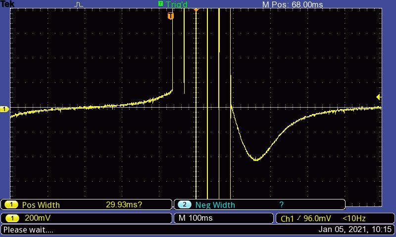

        Inspired by John's clock I eventually got round to trying the simple Arduino based driver which is described earlier in the other thread on a simple pendulum left hanging from a previous failed compound pendulum experiment. It has a an ironless wound core and the pendulum rod swinging over it has a small powerful magnet attached to the end. Pic below shows it swinging, nothing connected all as per the pic in the original article.
        I used the sketch intact from the link and the pendulum worked first time, swinging away nicley, very pleasing. However after leaving it for a while when I went passed I could hear knocking with the pendulum swinging wildly. The knocking turned out to be the top suspension rod hitting the suspension bracket, not good.
        Put the scope on again and I could see multiple actuations from the coil. The pulse width was set at 30ms but I could see 5 x 30ms = 150ms, no wonder it was going a bit wild.
        Tried various settings on the sketch also playing with the limiting resistor which improved things. I realised that the multiple pulses were caused by the threshold voltage being seen on the rising part of all the cycle so modified the sketch slightly and its now on got one 30ms pulse and seems very happy. The pendulum duration is around 3/4 secs.
        Peter

          Peter, in order to prevent spurious impulses, after the "proper" impulse I keep the driving output from the Arduino low until just before the next zero crossing, then switch it to an input. This means that all inputs from the coil are suppressed when there shouldn't be any. I also have amplitude control.
          #517658
          Peter Bell
            @peterbell11509
            John, Yes I have a similar arrangement but also enabled pin 13 on and off to flash as the Arduino is remote from the pendulum, can see its working—very much work in progress! I thought of simple amplitude adjustment by using selective resistor if needed. The original sketch is a very neat arrangement, would have liked to sample something to give amplititude control as on my other clock but cannot think of a way at the moment without adding another sensor which I dont want to do.
            I deliberatly left the rod length short for a 1 sec beat as I was going to use the compound part to adjust it to 1 sec or more, think its about 0.75 secs now but needs reworking to make a double suspension spring arrangement to give it enough stability .

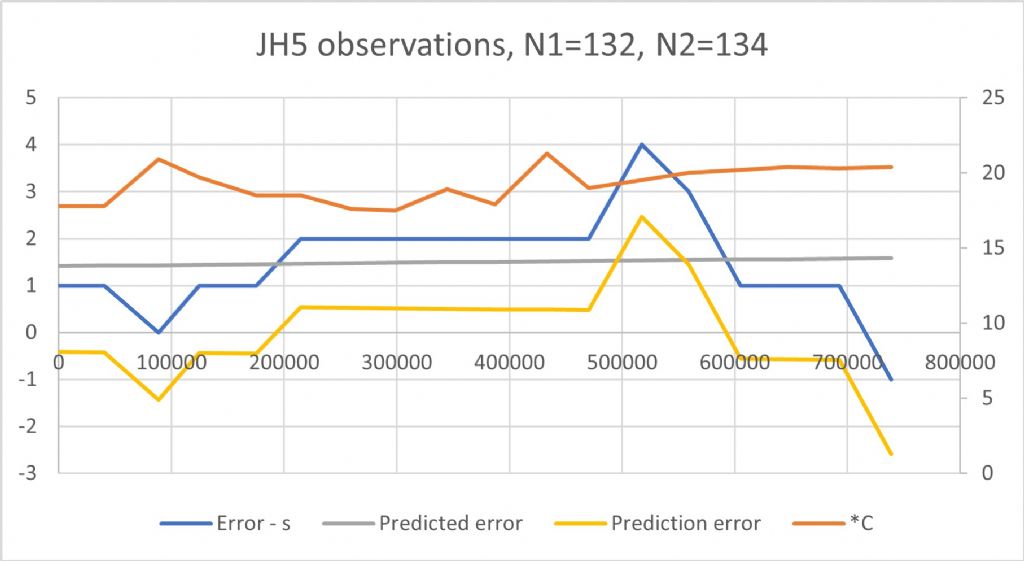

            #518342
            John Haine
              @johnhaine32865
              Latest timekeeping results.
              This shows readings over the past 10 days since setting the two correction counters to 132 and 92. One odd thing I've seen is that every time I upload new software with changed counters, even though the clock doesn't actually stop swinging it takes quite a long time (days) to settle down. In the plot above the blue error curve was steadily increasing but the rate of increase seeming to flatten off, so 3 days ago I reset the seconds hand (just using the control switch which inhibits dial impulsing, removing 24 seconds of accumulated error. Since then the error has built up to 2 sec, but this includes some due to my accidentally jogging my desk (the clock sits on the desk in my study). The clock has a "half-second" pendulum so the SW divides by two to drive the dial, and normally you see the dial advance on the same half-swing each time, in this case it was L->R. But then I stood up yesterday and accidentally jogged the desk since when it has been incrementing on R->L, so I think there's been at least a half-second extra input to the displayed time and possibly more as the pendulum settled down. I also display the temperature at the time of the reading, I'm not convinced that there is any obvious correlation but haven't yet done a regression analysis. Ignore the grey line. Anyway, I think the regulation is getting there, and I already rely on the clock when I just want to quickly know the time.
              #518343

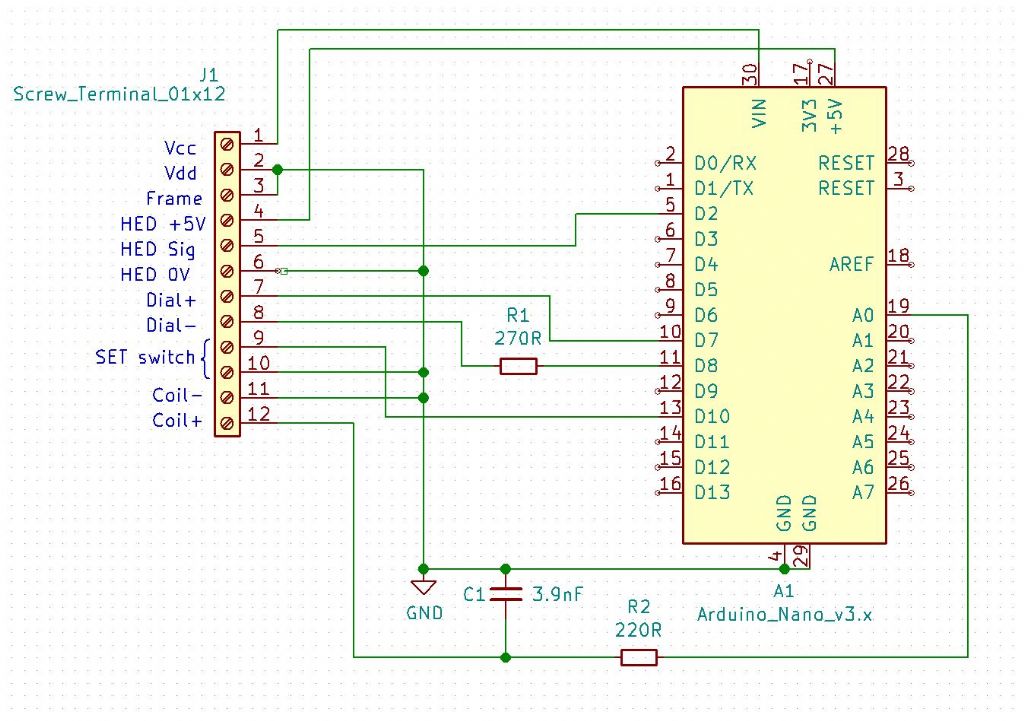

              John Haine
                @johnhaine32865
                In case anyone is interested here is the schematic.
                #518417
                  Posted by John Haine on 08/01/2021 10:19:36:
                  … One odd thing I've seen is that every time I upload new software with changed counters, even though the clock doesn't actually stop swinging it takes quite a long time (days) to settle down.
                  … this includes some due to my accidentally jogging my desk (the clock sits on the desk in my study). …
                  I've got both problems too. My pendulum is very sensitive to jogging, and, after a restart, it misbehaves for at least 4 hours. Some evidence in the longer runs that it becomes more stable after a couple of days but I've not had mine running long enough yet to prove the pendulum settles. Or gets worse! MichaelG suggests my carbon-fibre rod will develop fatigue cracks at the suspension point, and I think he's right.

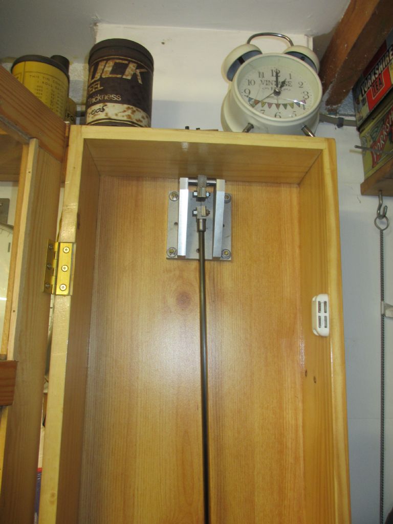

                                        I posted some pictures of my PIC controlled clock at steel pendulum
                                        As it's now got cold in my workshop it started to gain due to contraction of the steel pendulum, so I've finally got round to substituting carbon fibre. I shortened the suspension spring at the same time, as it was deemed too long. I was a bit worried that the joint at the bottom which is a 4mm dia spike 20mm long up the inside of the CF tube might not be strong enough, but according to the interweb shear strength of Araldite is 15 MPa so it should hold 384 kg. My bob is ~2 kg, mild steel inside stainless tube to make it look pretty
                                        Positioning the bob by measurement got it within 1 minute a day, now to regulate it, time it over a week next

                                          Duncan, is the rod actually a CF tube? On my "Arduinome" the rod is a 10mm CF tube with 8mm bore. I have a lot of 8mm aluminium rod which is a sliding fit in the bore. So I cut two slugs of this, probably 20mm – ish long, and araldited then in the ends. At the pendulum end the slug is tapped M4, originally for a rating nut but now there's just a nut that a step in the bore of the bob at its centre sits on. At the top the rod is cross drilled through after the slug was glued, with an M3 bolt holding it into the lower suspension chop. No sign of the araldite bond giving up yet (but only 18 months). That bob weighs 7 Kg. Rod length was originally found by calculation (using models for the MoI of all the components) and that gives a period near enough for easy digital compensation except for one M8 nut on top of the bob.
                                          On my second clock there is just an M3 screw through the lower chop and rod, no glued-in slug. The bob is held by a grub screw on the centre line clamping the rod. Again length set by calculation, and all regulation digital.
                                          Have you thought of doing the regulation in the PIC?
                                          #523911
                                          duncan webster 1
                                            @duncanwebster1
                                            Yes it's 6mm OD 4mm ID CF tube. The top fitting was tapped 1/4 *40 for the steel rod, so I drilled it out 6mm leaving a scratch to key the glue, the bottom end has a 4mm dia spike on a bit of 1/4 steel threaded 1/4*40 (actually the end of the old rod) for the rating nut. The spike has small vee shaped grooves in it, and I poked an M4 tap up the tube, which roughed it up nicely. I then bored the bob at the top and made a split collet to fit round the CF tube so there is less chance of the bob wobbling on the nut. It's only split because i forgot to fit it to the CF before gluing the ends on
                                            I'm not messing with the PIC, I did think of replacing it with an Arduino, but it works, so leave it alone. If I did replace it I'd alter the opto switches to be in line vertically and have a second flag offset to one side of the rod to detect end of travel. Would look a lot neater and allow me to change the arc of travel. Aesthetics means you want use a lot more swing than you actually need, and less is more in the case of pendulums, although I'll repeat my mantra, it doesn't matter what you do to a pendulum as long as you always do the same.
                                            Having adjusted it once it's now within a second in 24 hours, I'll leave it for a week and have another calculate.
